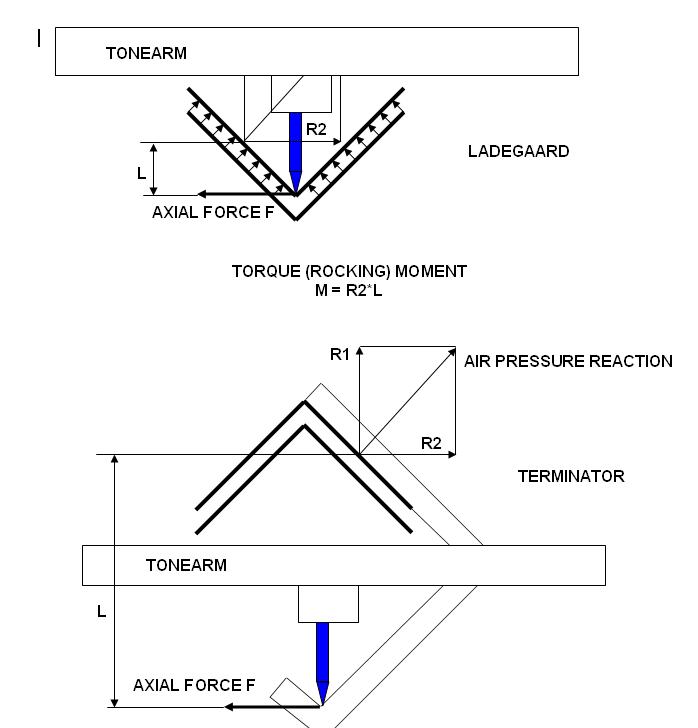

Here is a diagram showing how the forces and moments applied.

I am a little confused by your diagram and your explanation.
M:=F Xr , where M is actually torque, a vector . It follows the RHR in vector mathematics. The torque created by a (relatively) large F and a large r could , in fact , move the arm "backwards" if there is enough movement permitted by an imprecise gap between the carrier and the stationary portion of the arm, or the gap is large.
I suspect that graeme uk is on the correct path to answering the "rocking " question.
Maybe my neurons are misfiring across the synaptic gap in my brain, in which case please ignore any comments I make.
stew

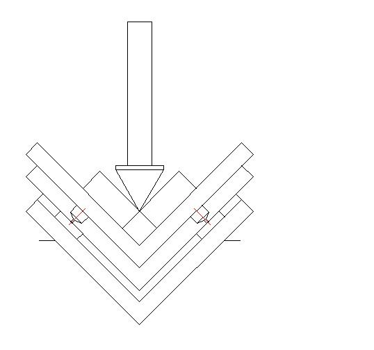

Match between slider and manyfold may definitely be improved for any ready made angle profiles; I will try lapping. But anyway, all other factors being the same, the rocking moment is order of magnitude bigger for terminator arm. I have rised a bit a point of contact between the arm knife and slider (two tiny bronze prisms are glued to the slider), such as it lays in the same horizontal plane with the air nozzles placed in the middle of slider bottom surfaces; so the rocking moment is virtually non-existent.
