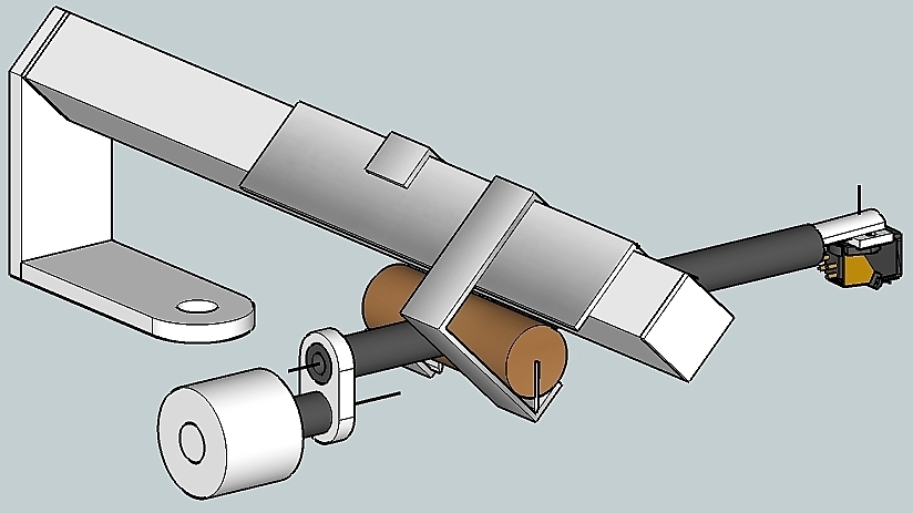

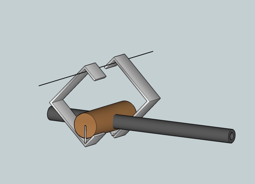

Fran, something like this for the "carriage" (bottom portion)
have a look. Similar to this?

ha, very impressive stew - only that looks better than my implementation!
Mine is more or less the same except that I put the pivot points further away from each other (ie the cross piece is longer). I used ordinary kitchen knife because I thought the stanley knife blades were very brittle and thin and could chatter. Although it looks like thats what Mr. Terminator uses.

Re: what are dimensions of the slider?
Nanook said:
and the rest?
here's a rough sketchup without considering dimensions.
stew
Oooooooouuuuuwwww! Bloody SWEET Stew.
:worship: :worship: :worship:
