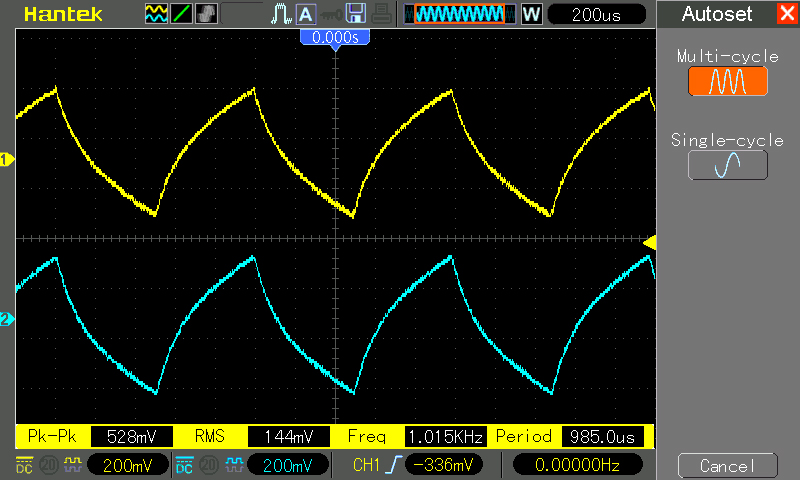

Hi Warrjon,
I have the CBS test LP, too. How did you connect the oscilloscope with the cartridge? I tried it before and got triangular waves.
Jim
Hi Jim,
The CBS ST112 is cut without RIAA if you scope the output of the phono preamp you will get a sawtooth wave.
Best way to do this is to leave the TT connected to the phono preamp and scope the input to the preamp. The scope will add some capacitance my Tektronix is 33pf.
I didn't do it this way because my RCA leads from the TT are very short to keep C down

Hi Jim,
I see. I am going to get a digital pre or a microphone pre and try it again. The preamplifier I have now is Audio Research Ref 2. I don't like to use tube pre to do the test. Tubes have too much noise.
If you have a MM cartridge you can leave the TT connected to the preamp and scope the input to the preamp, an LOMC cartridge would need a MC pre as noise would be an issue scoping directly with such low signal level.
