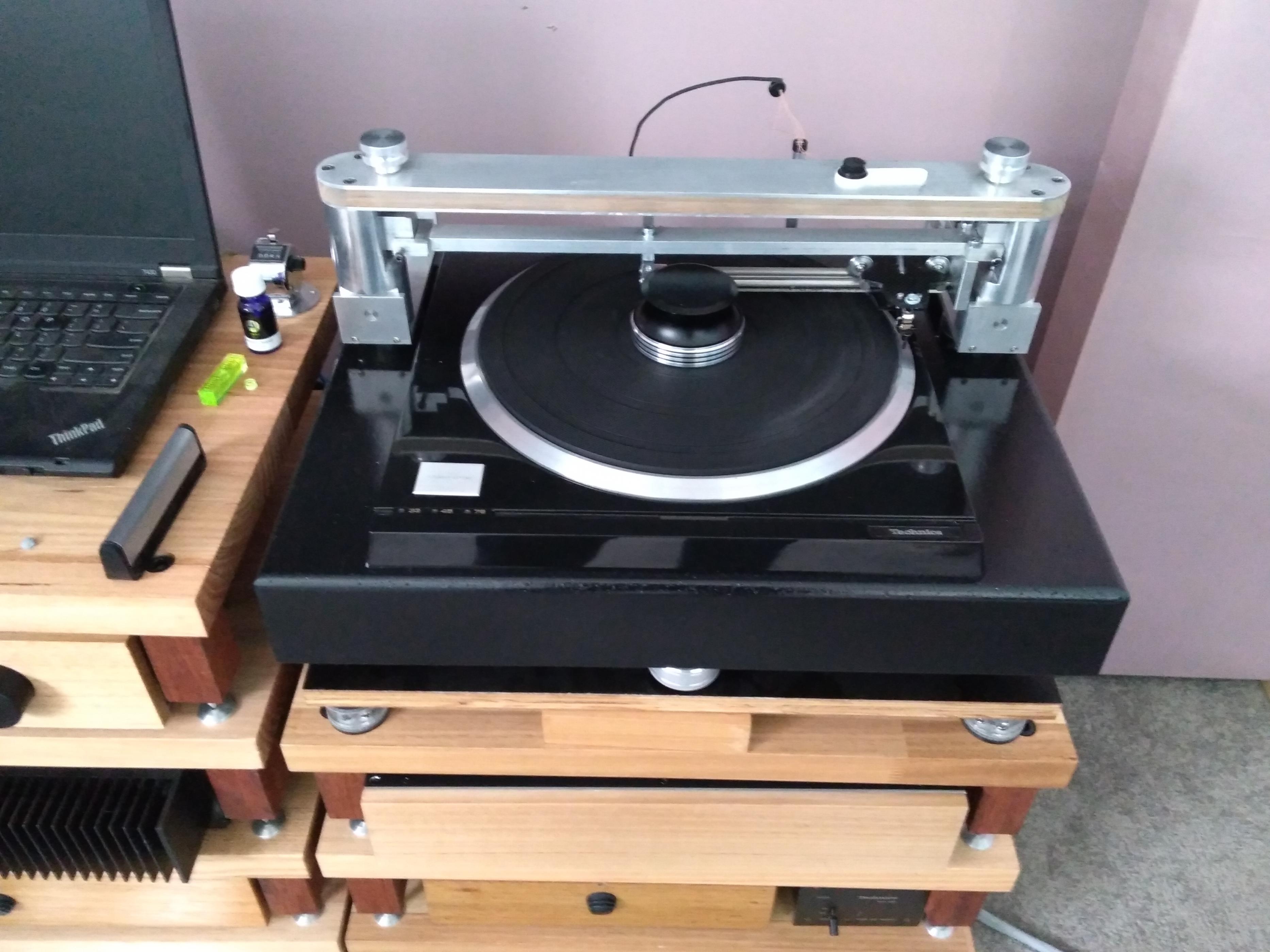

I finally get one of my air bearing arms fixed and up running.
This is the damping device. I designed the damping device with an emphasis on vertical damping.
This time I completely redesigned the arm and have a machinist made the parts for me. The total mass of the arm is 102 grams. Usually, I won’t run a medium compliance cartridge on a heavy arm, but I have no choice. The cartridge I fitted on this arm is Ortofon A90, a medium compliance cartridge. I did an eccentricity test. From the video, it seems to me it runs very nicely. Please see the video.

Hi Jim, that looks pretty darn good.
I saw this thread before I started down the LTA path. The only reason I went with the rail and wheel is my house is very small and I would need to put the compressor outside and plumb it in.

I have built Niffy style arm but it's on a bridge mounted both sides of the TT. Carriage weight is 52g with cartridge, my Stanton 881s is very high compliance
It is very good. Bass is way better than any pivoting arm I have had and it's much quieter less clicks and pops. I'll never go back to a pivoting arm after hearing this. Even my first prototype with overhead glass rods was as good as my EPA100 but with better bass.

Very impressive tracking performance. Yet another nail in the coffin of the tail wagging the dog myth. I'm still green with envy over your cartridge collection, especially this one. (and your speakers too)

I thought 102 grams might be too heavy for medium compliance cartridge such as A90. However, it looks A90 works just fine. Ortofon's cartridges have a very balanced sound. It can be boring sometimes for some people. But once you listen to it more and more, you may find nothing is missing.

Really an outstanding result, the best l've seen for passive LTs; congratulations, Jim.

Damping seems designed to act more vertically than horizontally, am I wrong?

Contrary to popular belief vertical damping is more crucial than lateral with a linear arm. This is dispite lateral mass being higher. It is also true for conventional pivoted arms except to an even greater extent. One of the difficulties in developing a linear arm is getting the balance of vertical and lateral damping just right. I think Jim has put quite a lot of effort into this.

Yes. I emphasize vertical damping in my design. First, I used a piece of plastic as the material for the paddle. So, it will increase the buoyancy force. The shape of the paddle is designed to fully utilize the buoyancy force, too. Although I don't have the theory of why vertical damping is more important, in my opinion, there is a relationship between vertical damping and lateral inertia. In other words, I think, vertical damping can damp the arm both vertically and laterally. For the linear arms in the market, the designers still take conventional ways to design the damping device, such as Kuzma airline and Walker Audio Proscenium.
