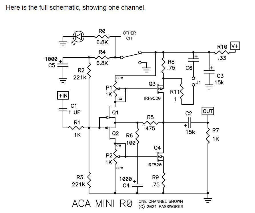

Yes.From my understanding, I should be able to run a stock B1 off the mini's BOM PSU as well (making an integrated). Is this correct or am I missing something?
What would be the benefit of a B1 in this case (integrated amp)? I am not sure what the gain of the ACA mini is (searching for it). Maybe you need some gain in front? Or maybe not.From my understanding, I should be able to run a stock B1 off the mini's BOM PSU as well (making an integrated). Is this correct or am I missing something?
The benefit is I have a B1 that's unused lol. This is for a desktop setup where I just need a volume control and not a lot of volume. Maybe the lack of gain will be problematic and maybe it won't. Will find out...
FWIW I use an ACA Mini as a desktop amp with a connect direct to the DAC ouput and I use the level control on the PC. It works very well. I expect you will have no problems w/o a pre.The benefit is I have a B1 that's unused lol. This is for a desktop setup where I just need a volume control and not a lot of volume. Maybe the lack of gain will be problematic and maybe it won't. Will find out...
In post 241 Rayma says ACA Mini gain is about 15db. The gain plot in the original ACA documentation shows it is a bit lower at just over 14 dB.So both are a bit lower than typical power amps but also so simial it would be hard to tell the gain difference between them from listening.I can't remember reading the voltage gain of the ACA mini
Is it 14dB as the ACA?
Thanks both of you
So roughly voltage gain of 5, means with the usual 2V sources more than enough gain to drive LS up to the amp's power limit, unless you run excessively high impedance LS, at which point you are probably better off looking into another amp.
Bottom line : from a pure gain chain POV, no preamp with gain is likely to be needed, and a simple passive pot between source and ACA mini does the trick. Unless I am mistaken of course, just to answer the initial question a few posts above

While I can just use a passive pot, again, I have a B1 just sitting here so why not do something with it?
The power switch does not disconnect the power, it simply shuts off the bias current.
May I ask the reason for this (I am not EE gifted)? What is the benefit over just switching the DC coming from the PSU?

Avoids thumpMay I ask the reason for this (I am not EE gifted)? What is the benefit over just switching the DC coming from the PSU?
In my limited technical understanding you would need a B1 to run long(ish) cables from pre to amp. Since you only need an integrated volume control, a pot alone should work for you.The benefit is I have a B1 that's unused lol.
With 15dB I am quite confident you do not need more gain. Just in case (as others suggested) the ACP+ has more than enough. And if not gain, it can also add a little of its own personality (that I really love).
