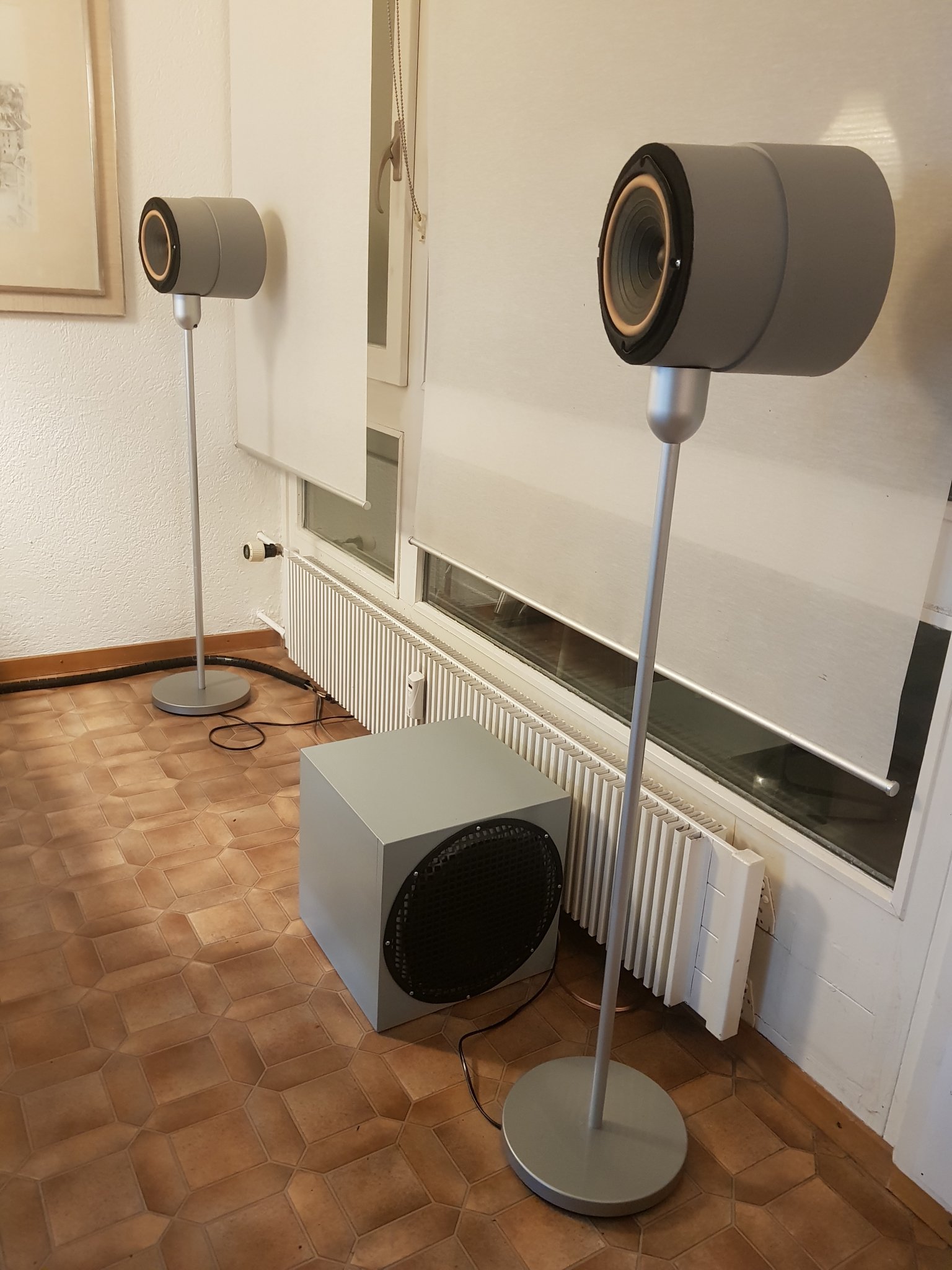

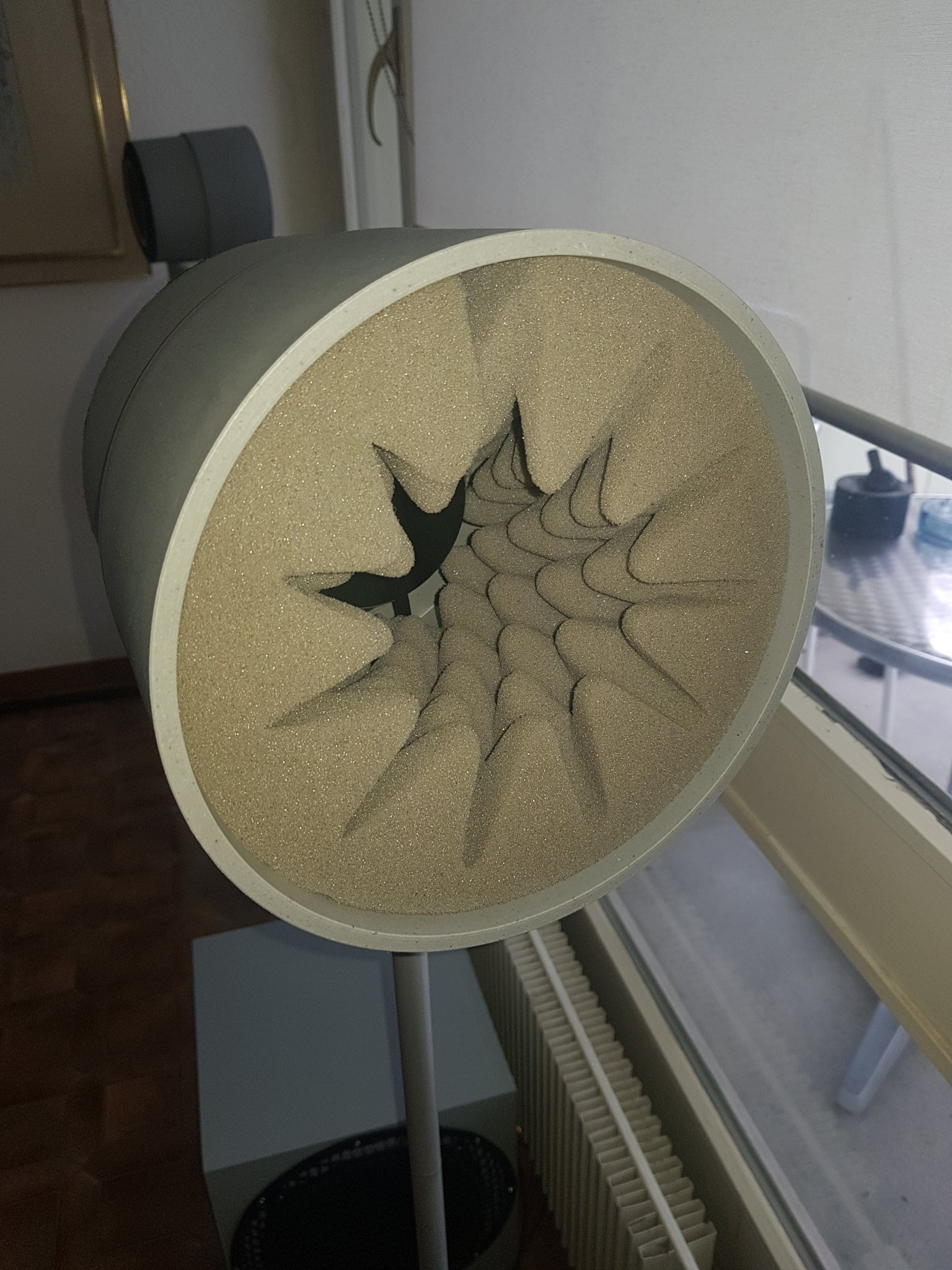

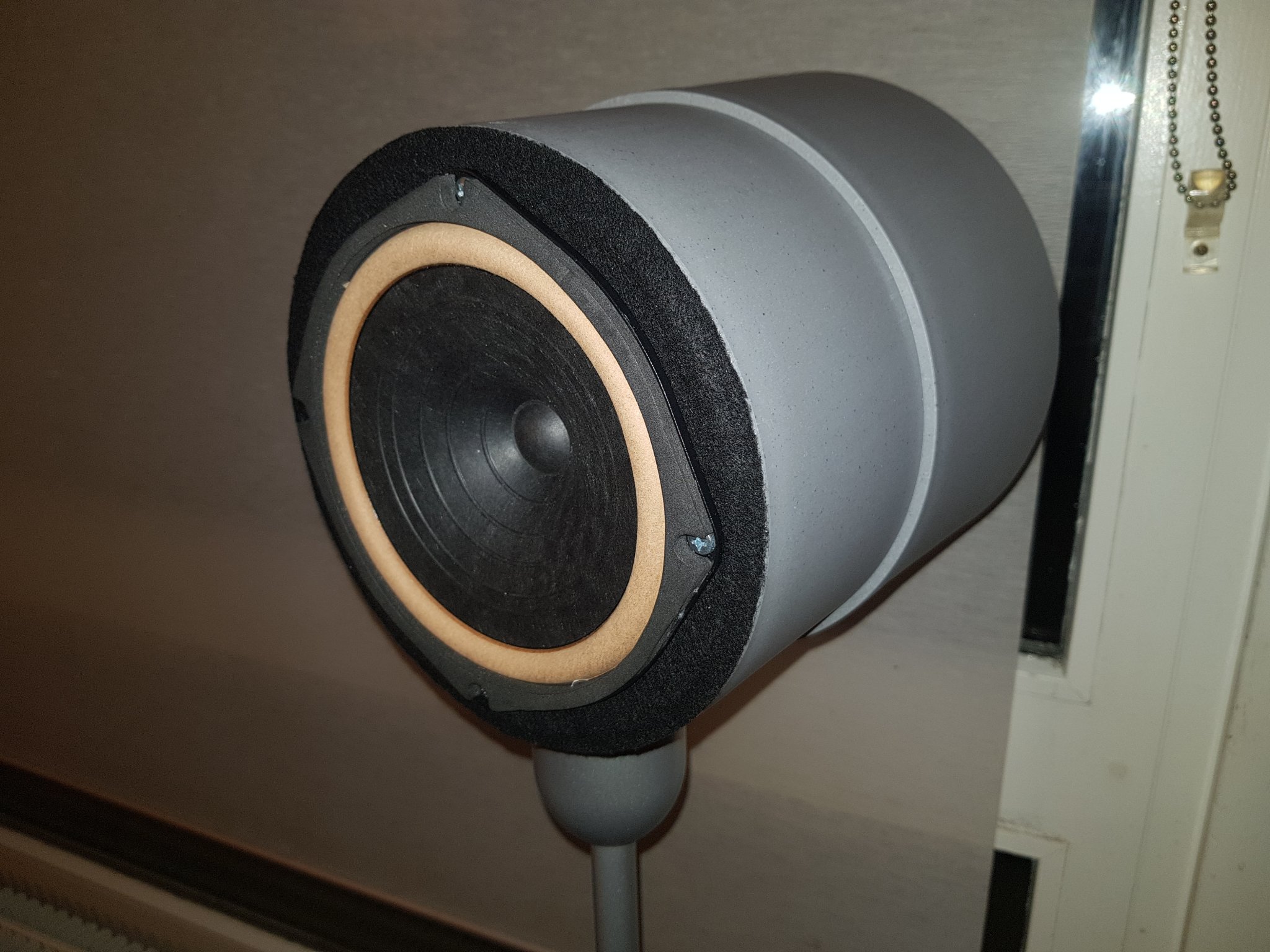

I am driving chinese Diatone P610 clones in my 2.1 kitchen system. The drivers are mounted in IKEA pots. In front of the amp a MiniDSP HD 2x4 and the sub is driven by a 100W T-amp.

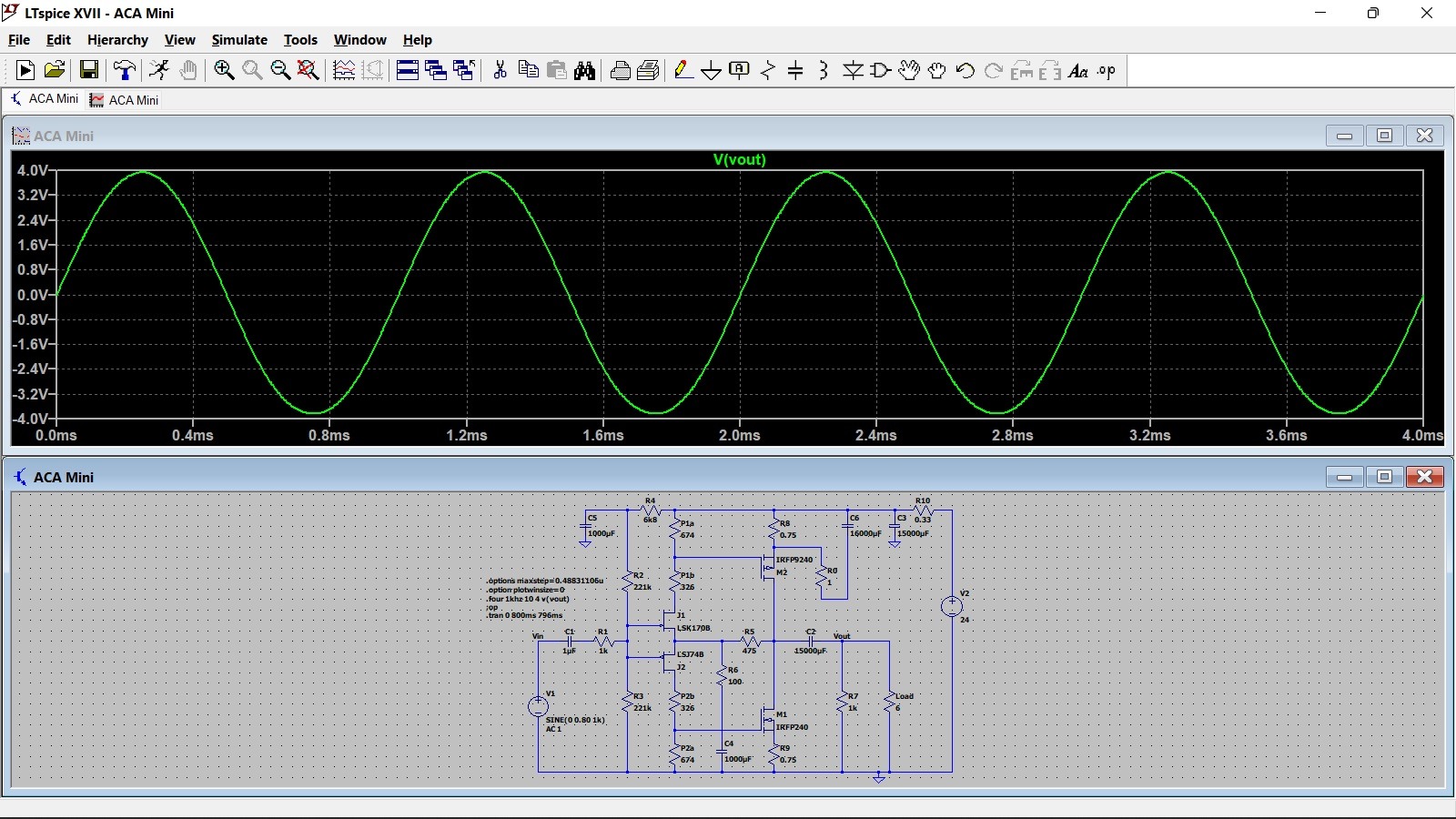

Here is a sim for anyone interested. It is not meant to be definitive and uses only standard LTspice models (so its click and run) but you can explore the operating conditions and so on.
The first FFT is with the bypass cap and series 1 ohm across the 0.75 ohm. The second FFT is with those removed. The standing current is set to 400ma. The FFT's were done with all caps set to '1' (one Farad). The load impedance is set at 6 ohm.

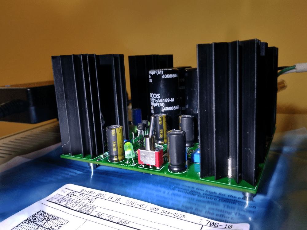

As the beneficiary of the generosity of those who made my ACA Mini build possible, and given the current unavailability of the PO89ZB kits in the Store, I’d like to offer up a couple spare kits I’ve put together with boards fabbed from Mark’s gerbers (NB: no mounting holes) and his specified BOM (KEMET-flavored). Kits and postage are on me.
I’d prefer that they went to folks who have (or will shortly) built an Mini and will share their opinions. At the very least, please have a specific and immediate use in mind for them.
Hit me up via PM with a mailing address if you’re game; I’ll reach out to the “winners” individually tomorrow. It’s not necessarily first come, first served, dig?
