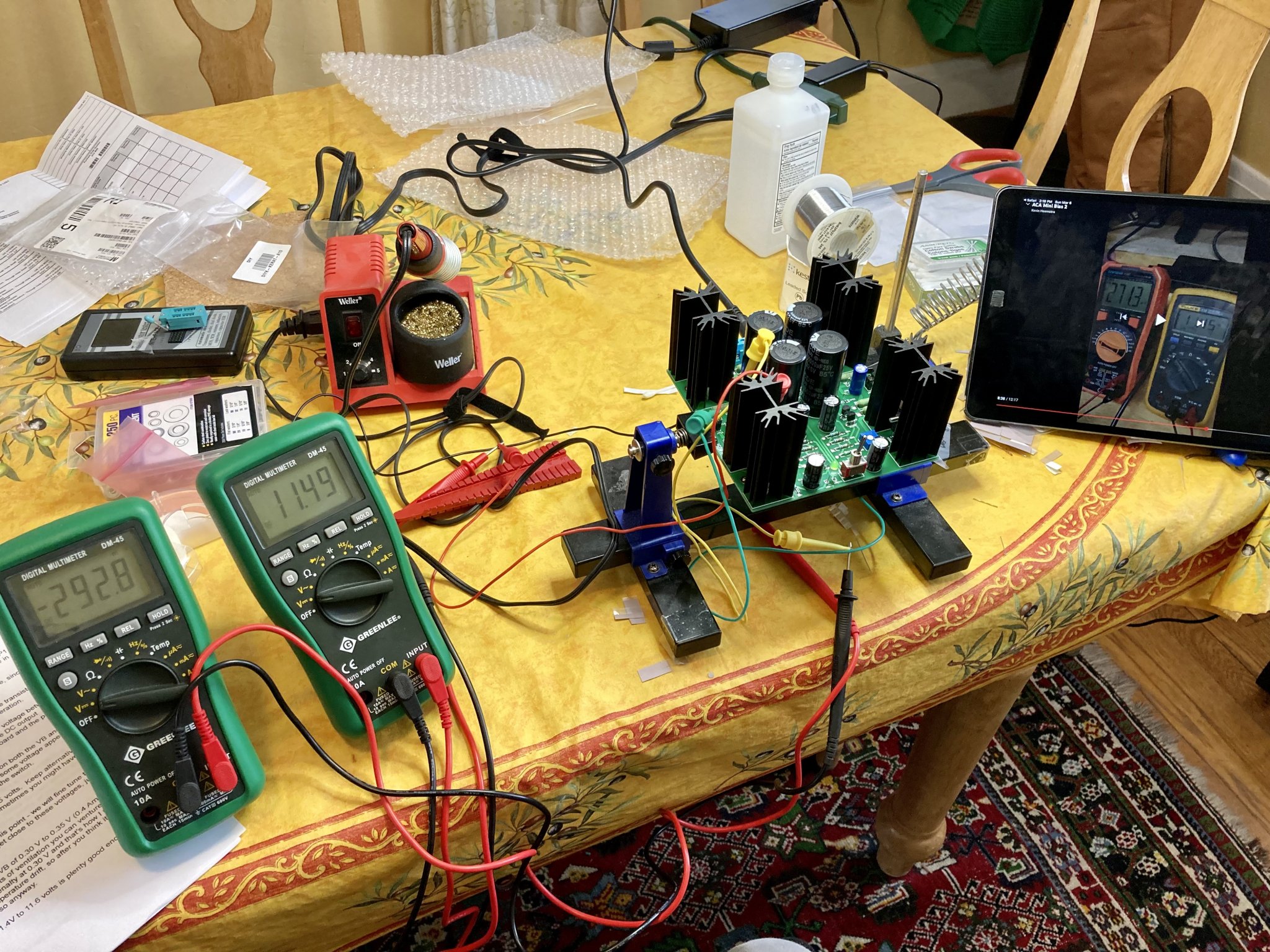

Received my "Almost clone board" about a week ago from the "Outside USA group buy".
Have been busy choosing other components than those listed on the BOM as many of them (7) were out of stock.
They were mostly resistors which are not critical as long as the same type, value and power rating is observed.
I did find a similar input capacitor at Digikey, an Epcos of the same size, material and rating, 495-4875-1-ND.
It should not be inferior to the Wima, but as a component obsessed audiophile, there is always a lingering, nagging suspicion...
Please advise...

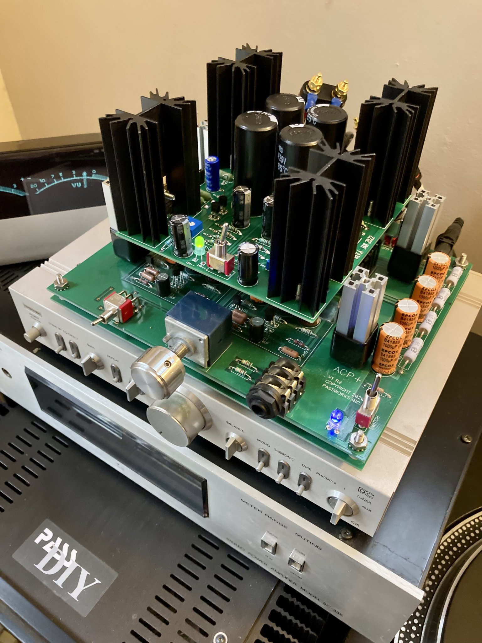

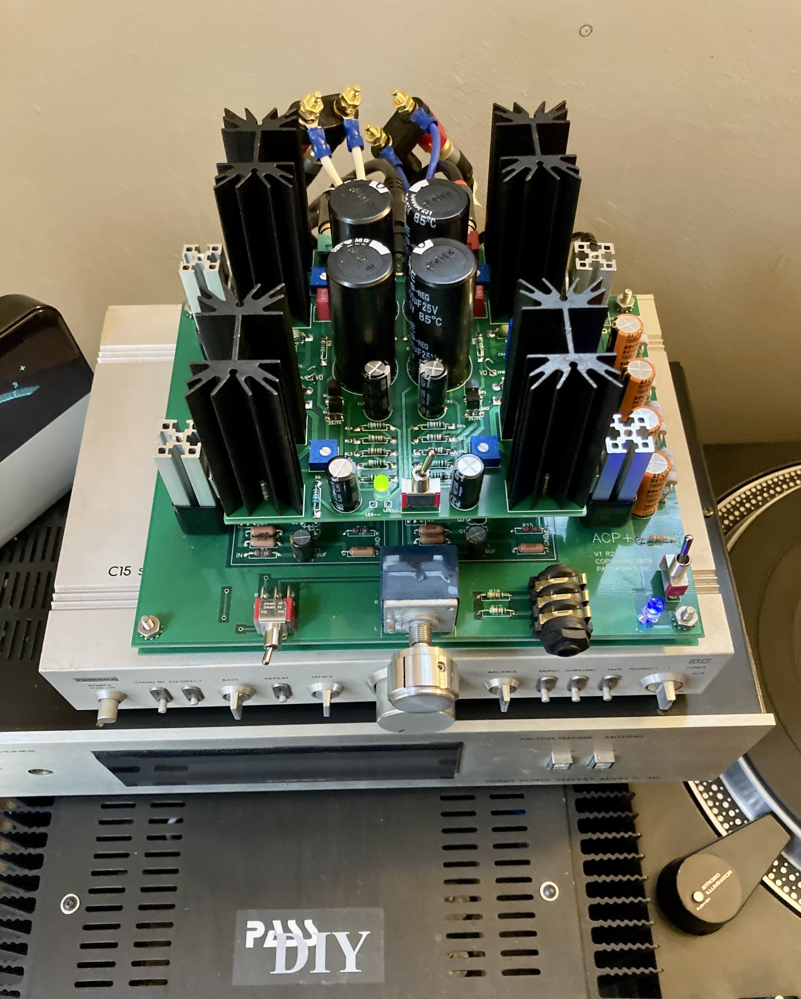

ACA Mini clone complete!
It sounds deliciously good! It’s really dead silent when not playing music. I prefer jumpers out. 😎
I attached some Makerbeam legs and plopped it on top of the ACP+. Open air goodness.
Thanks to Nelson, Mark Johnson, and Kevin Heem! This was a fun build. I am very pleased.

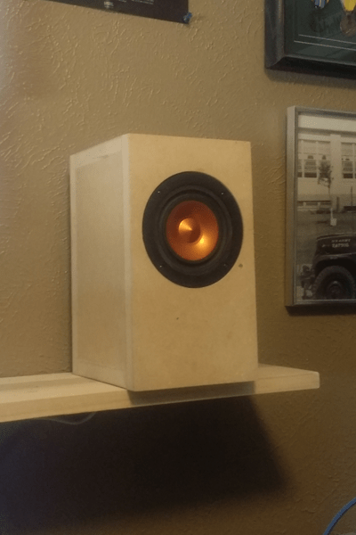

I'm using Markaudio CHR-70s in sealed boxes. F3 around 85 Hz. Plenty good for this use, I don't feel the need for a sub. They have a very clean and full sound. The bass is remarkable for their size and got better when I switched to the ACA Mini.
