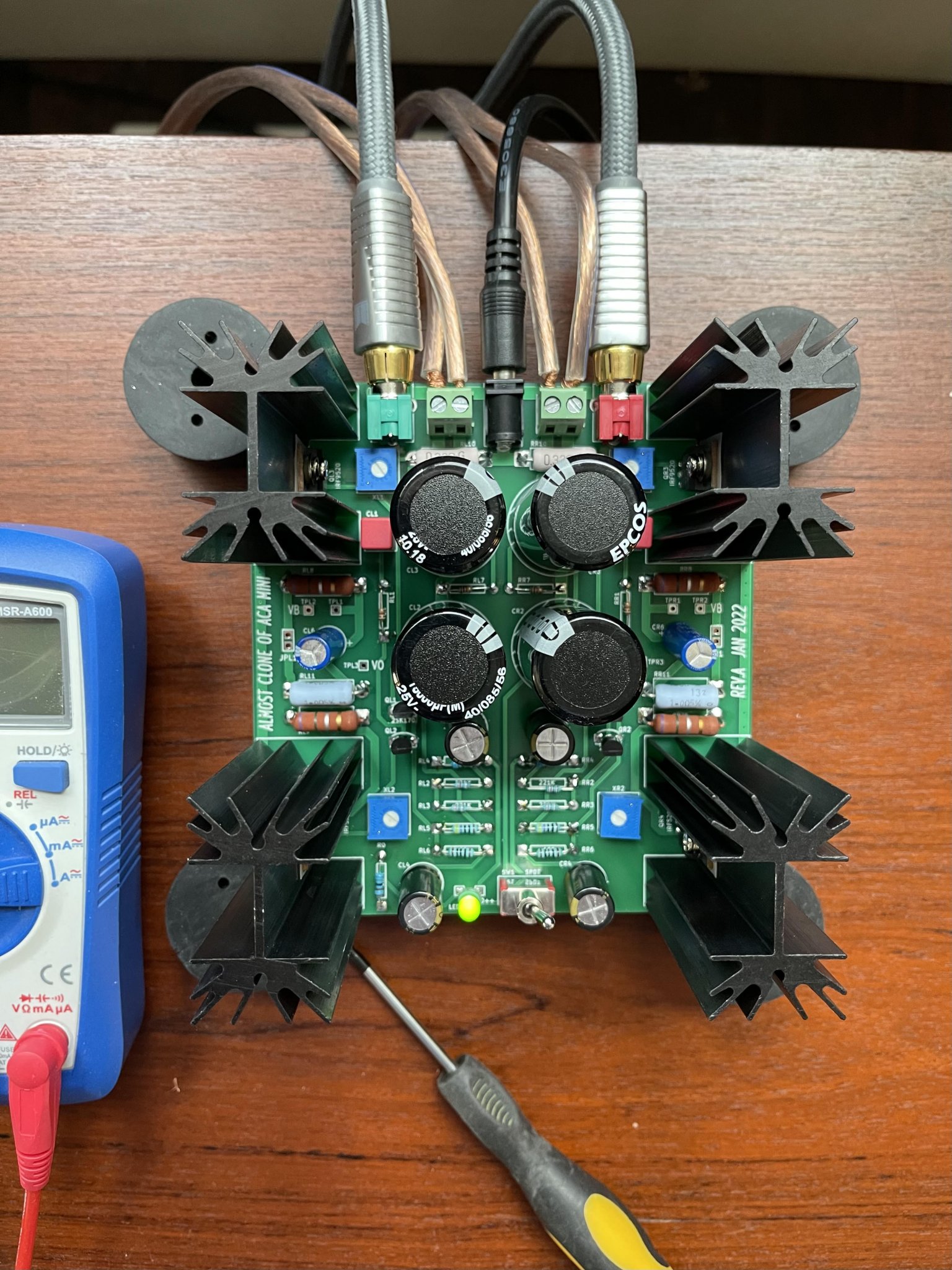

I stand corrected. And I'll thank Papa and Kevin again....That's not a Mini ACA in your picture (post #763). That's an Almost Clone of ACA Mini and KevinHeem moved earth and sky for you to have it.

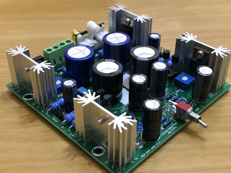

Can we use alternative JFETs other than sk170/sj74 for this ACA mini amplifier?Built a micro (ACAmicro? 😎) version of the ACAmini with 10cm x 10cm PCB. Since my target is smaller form factor with lower Output Power for my small study room (need smaller output power), I use smaller heat sinks and PS and output capacitors (4700 audio grade with lower ESRs). VB is set to 0.25A and temperature on heat sinks are acceptable. Moreover, 2N5458/2N5461 are used to replaced 2SK170/2SJ74. The result is great and love it. Thanks PaPa for this simple and great amplifier.

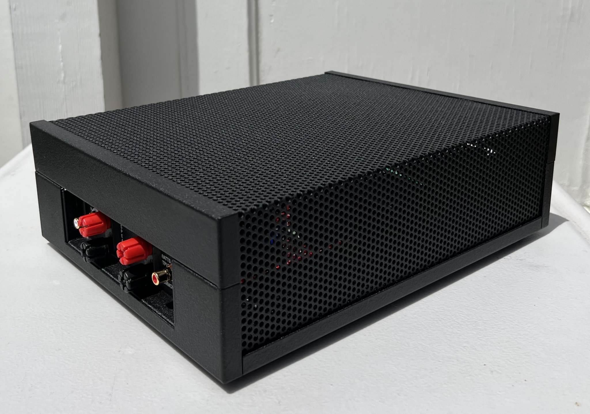

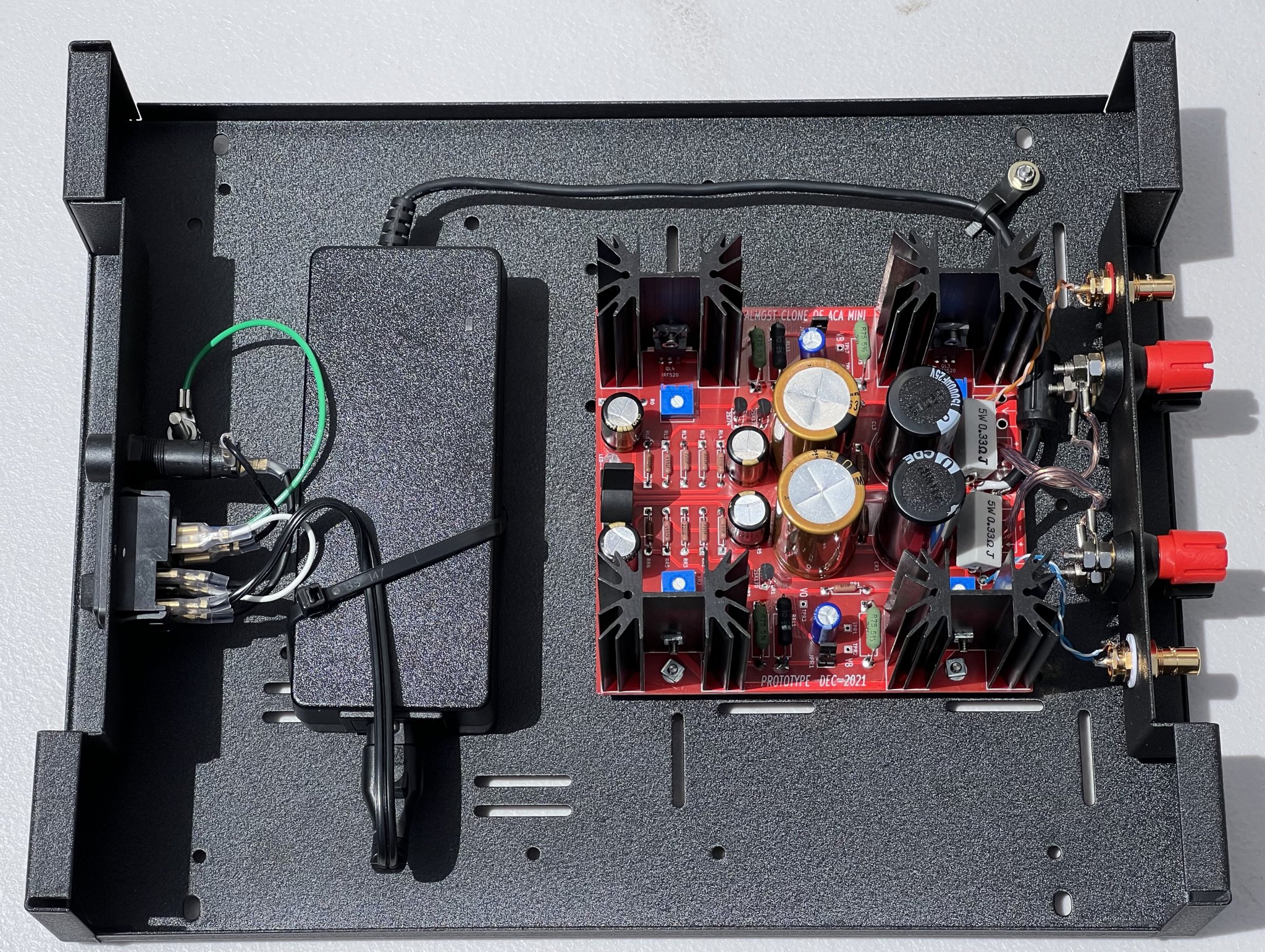

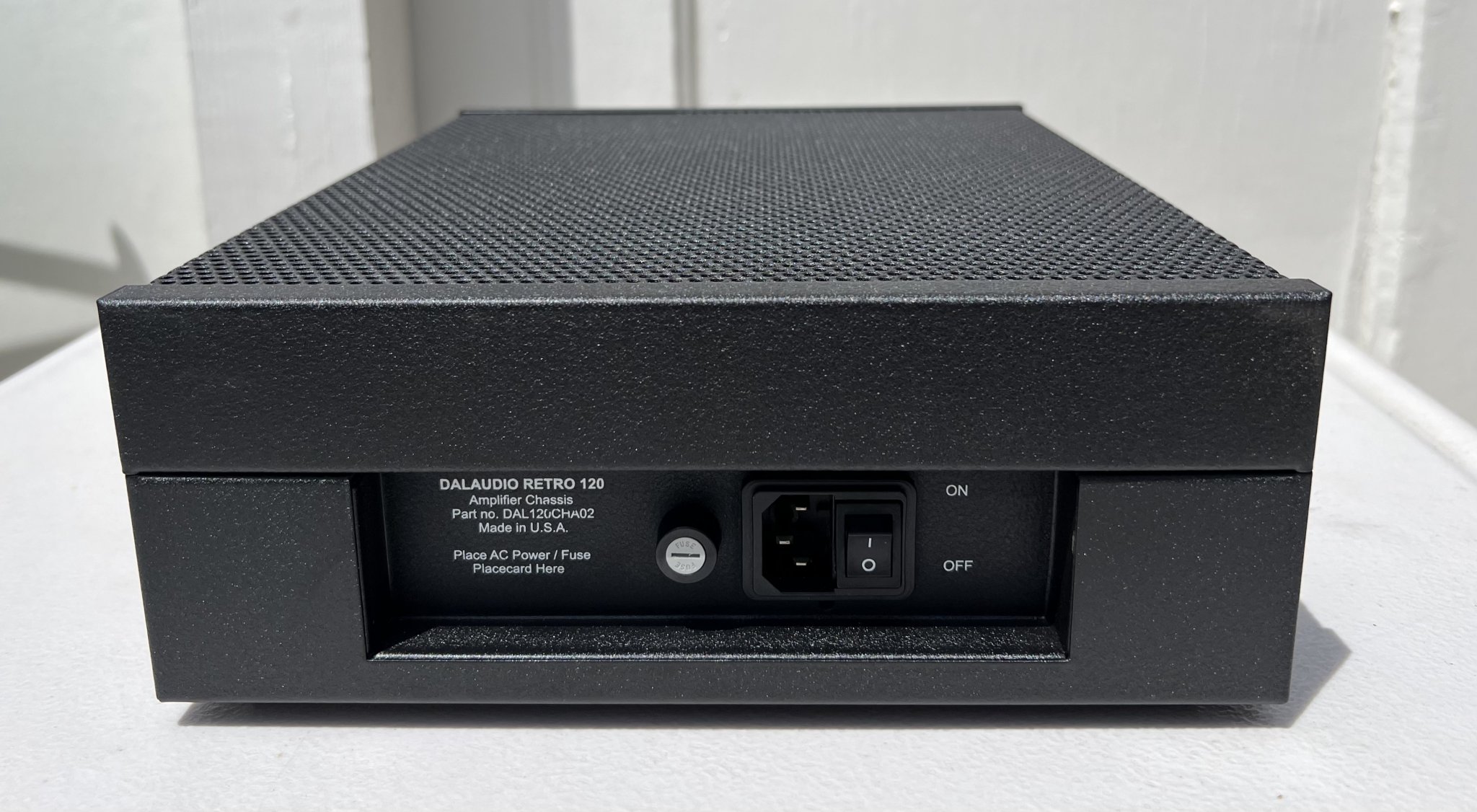

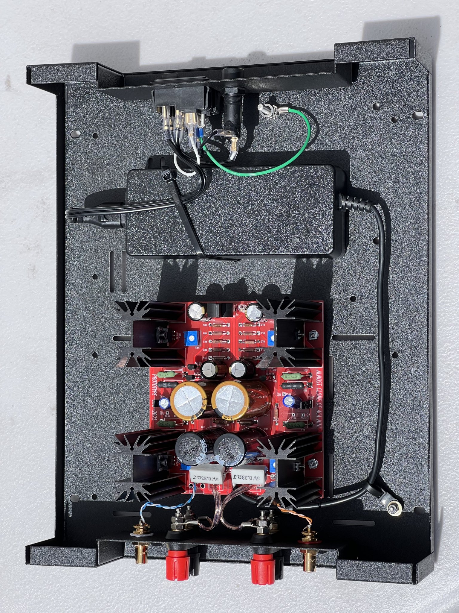

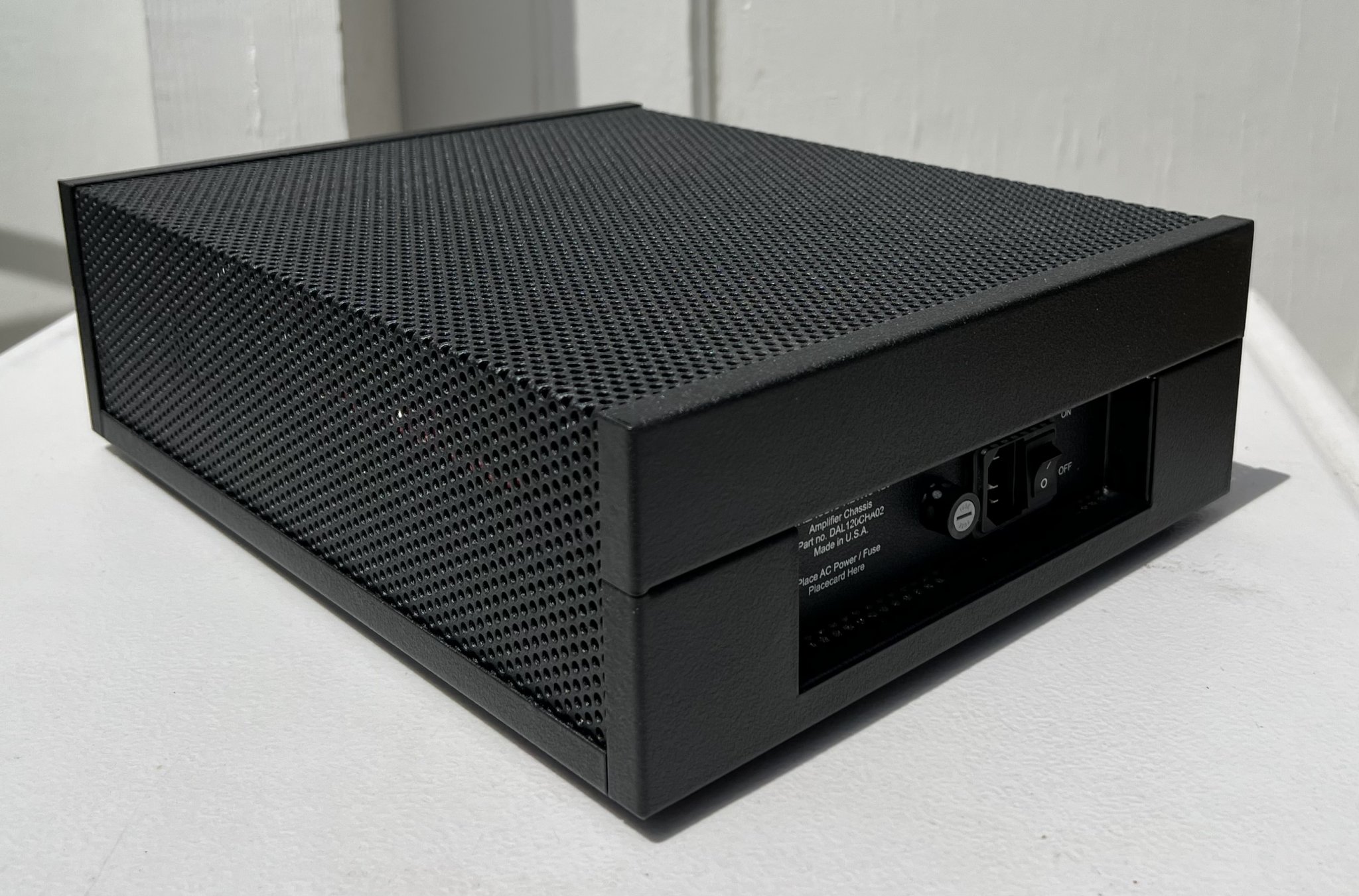

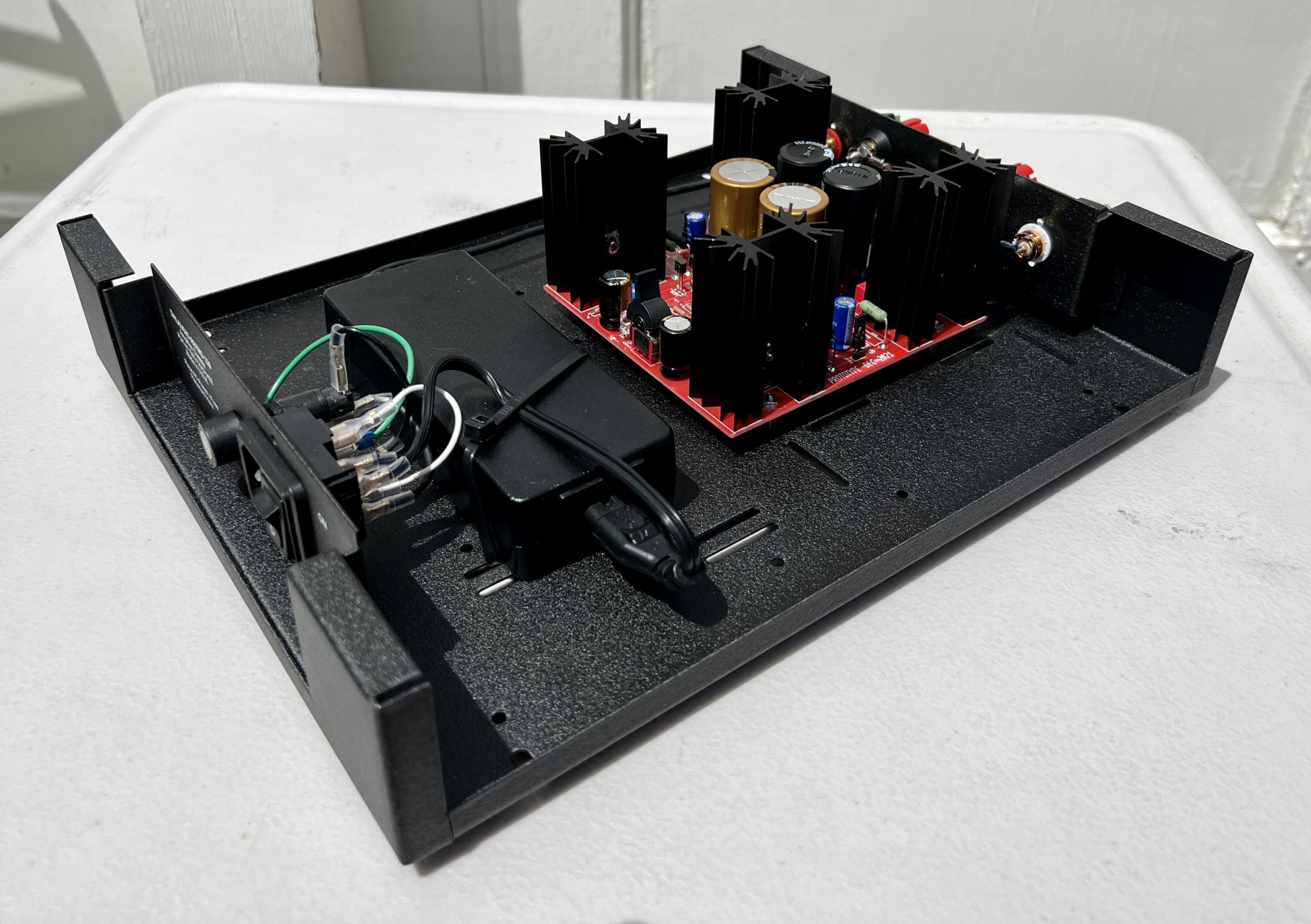

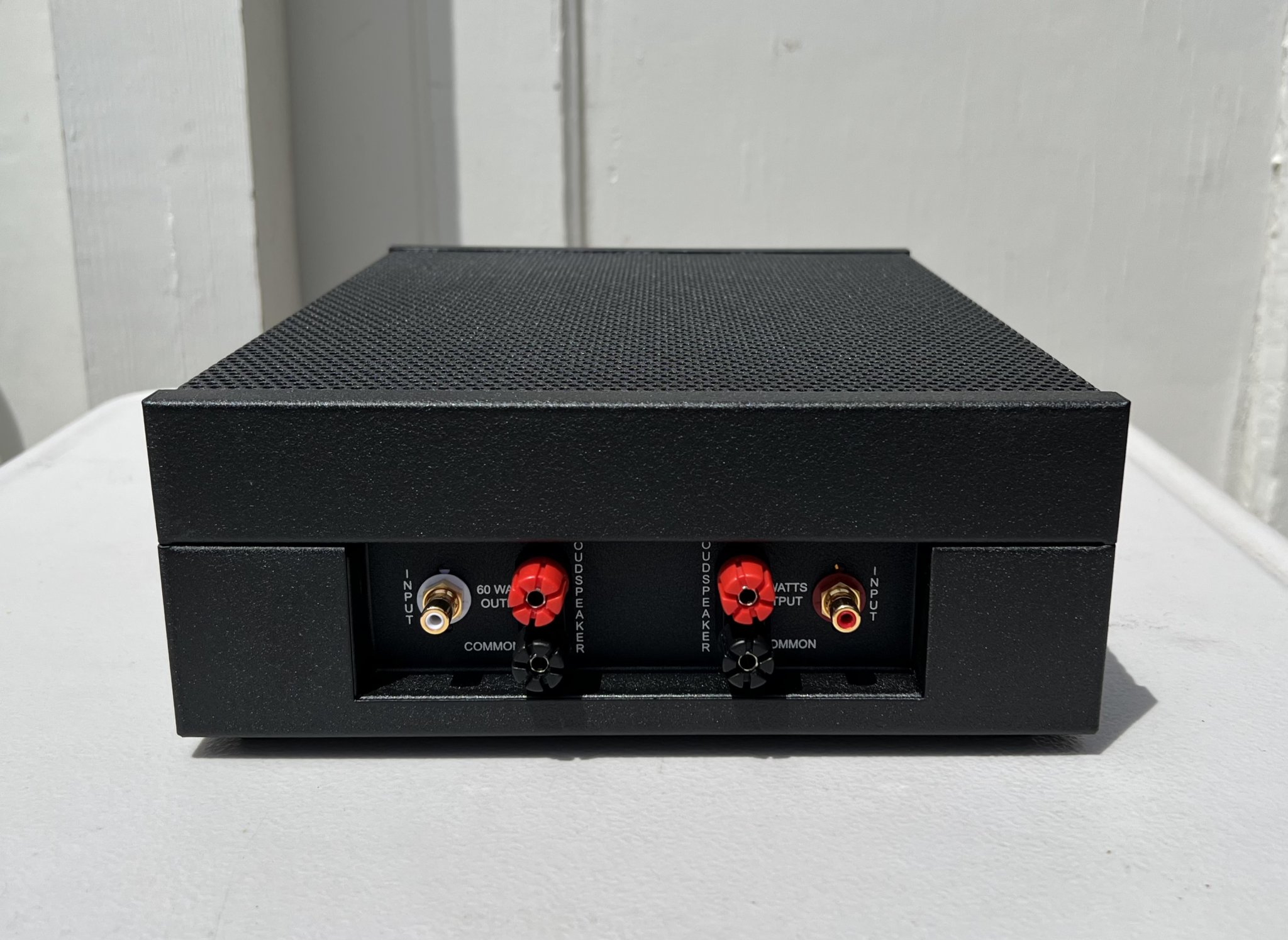

First of all thanks again to Nelson and Mark for the design and boards!!! I finished installing my almost clone of ACA Mini in a chassis. I bought a reproduction Dynaco ST-120 chassis from Dalaudio and it worked well. I was a little worried about noise by having the power supply located so close but it’s dead silent. I glued down the power supply and threw on a big zip tie for extra security. I had to drill holes to mount the board but it was not a problem using a cheap step bit from harbor freight.
A cheaper route would be a find a non-working ST-120 (most are no longer working), strip the internals and repaint the chassis.
