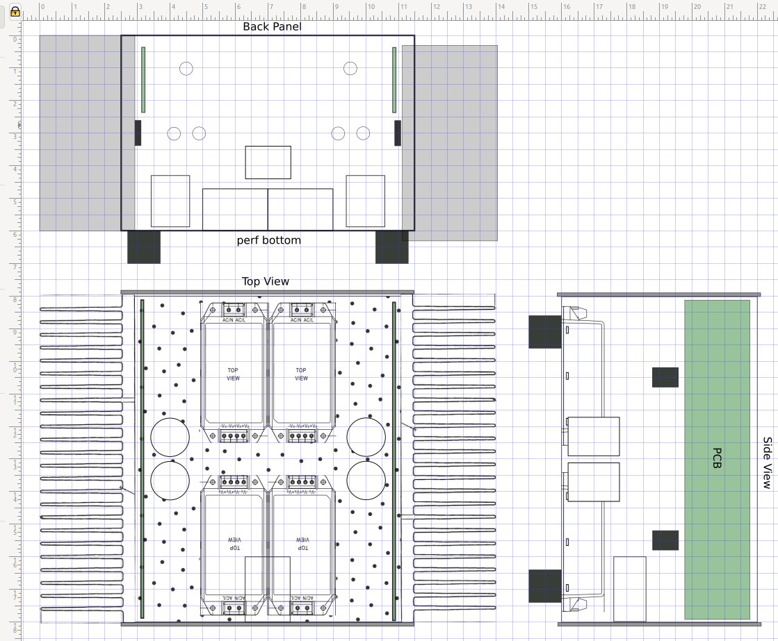

Would SMPS noise be a problem if the power module was inside a chassis with the ACA Mini? I was considering something like the Mean Well IRM-90-24 or IRM-90-24ST modules.
The question is motivated more by a idea of using 4 such module for FirstWatt class amps like the F4-F8 that use 300VA power transformers with 18V secondaries. Using SMPS modules instead of linear power supplies would provide some interesting packaging options. Here is one:

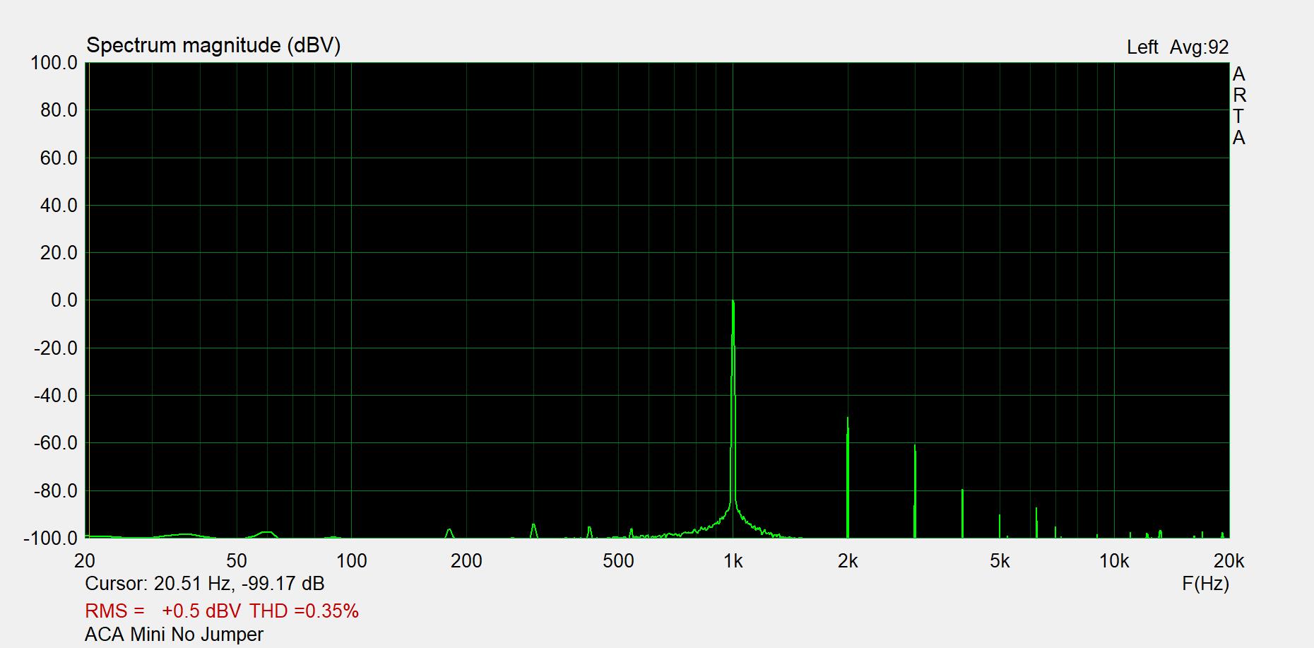

Thanks Mark and yes that would be an option were it not for the half dozen or so projects already in the queue, so, by the time I get around to this one I'm sure the kit will be available in the store.

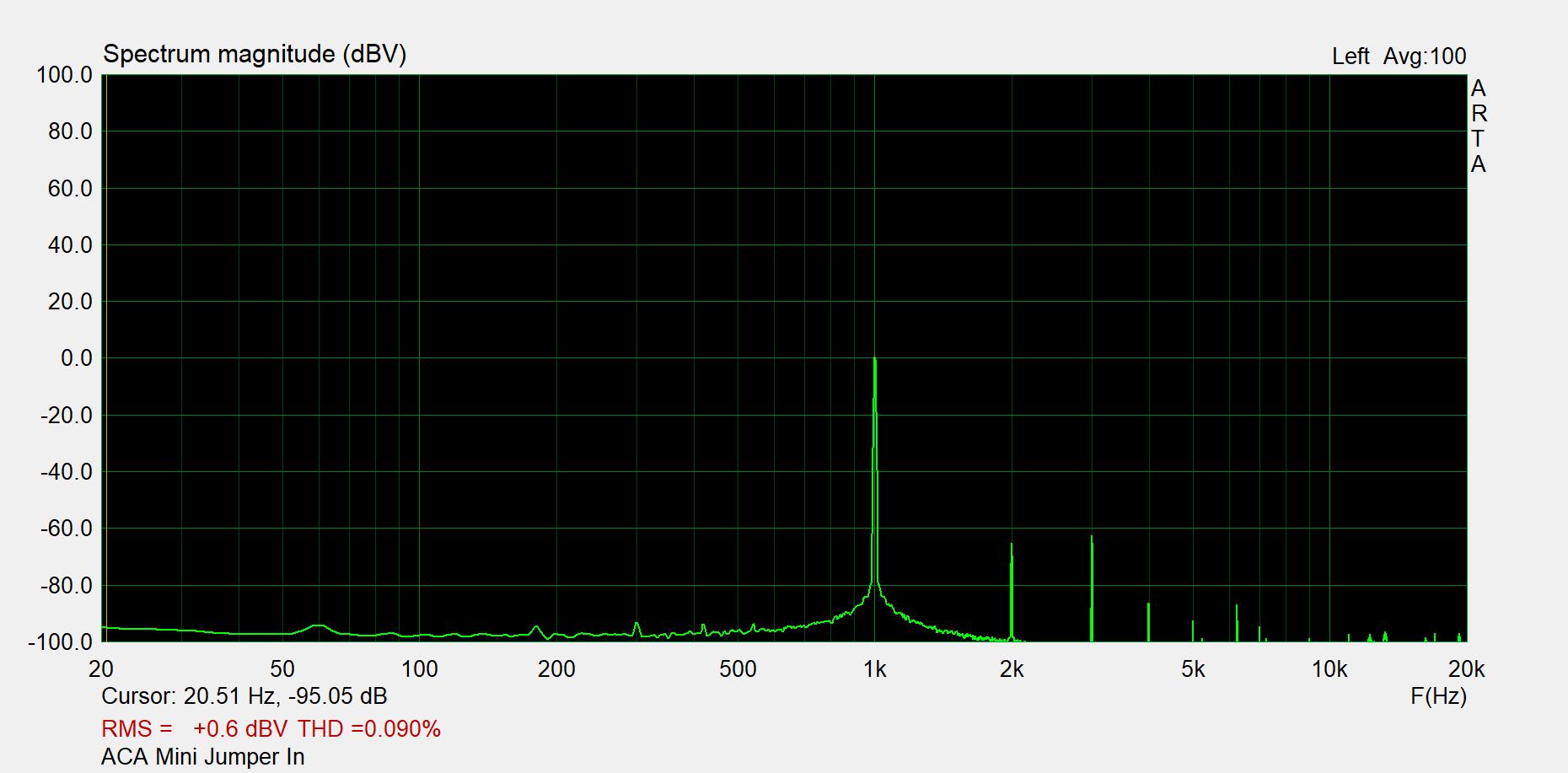

Here is the spectrum analysis I measured at 1W.
Inputs transistors installed are LS 170/74 matched at 8.5mA Idss.
Output mosfets are Harris (maybe) 9520/520 which measured consistently at a VGS of 3.20V for all P channel and 3.50V the N channel (I had 10 of each). So they are only matched with .3V
Compared to Nelson's measurements they look pretty close.
I have some Vishay parts coming in tomorrow. Should be interesting to play with those.

Of interest Kevin is the fact that your are measuring a Vgs that is 1V lower than what Nelson has measured for the Harris types. Maybe because you are measuring at a different current to what his test jig allows. At least as you say the results are consistent, as Nelson also mentioned being in a narrow band for each type.
Yes, I'm curios about that as well.
I tested the mosfets at 5mA using a 22ohm resistor, 15V power supply, and connections as outlined in Nelson's article on matching devices. I would just tweek the power supply a touch to get exactly 5mA.
