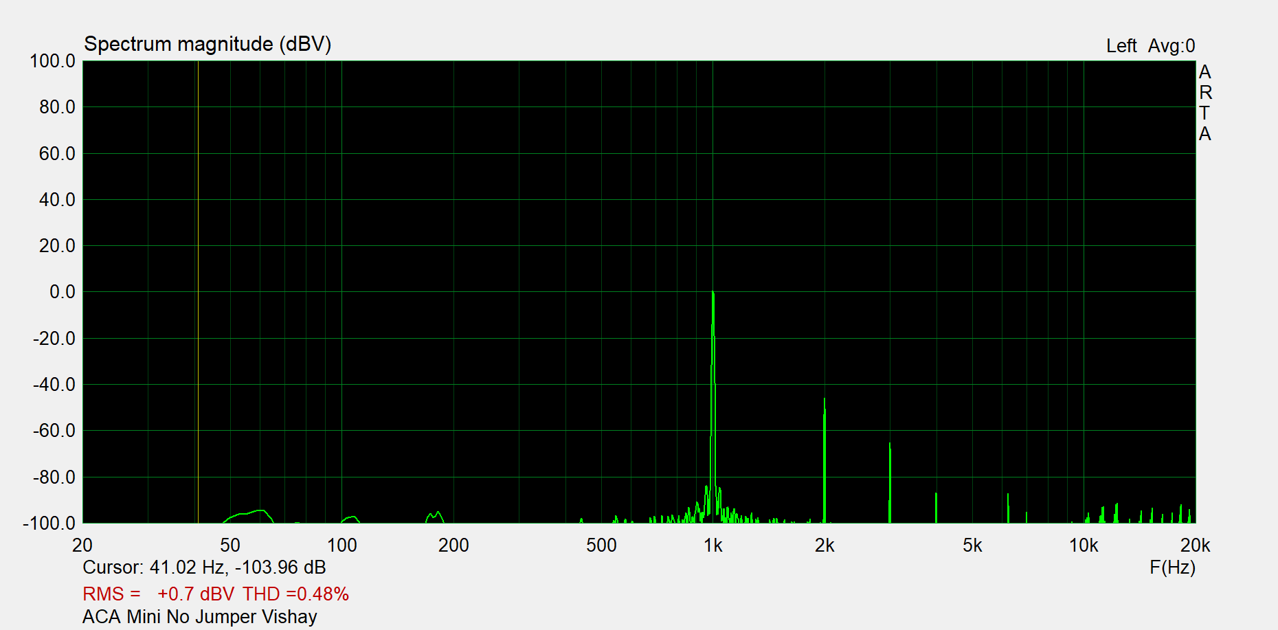

The IRF 9520 and 520 manufactured by Vishay came in from Mouser today. They measured very consistently within their type, around 3.9Vgs for the N channel and about 3.6Vgs for the P channels (testing at 100mA). So no really close matches here. I only had 10 of each type.

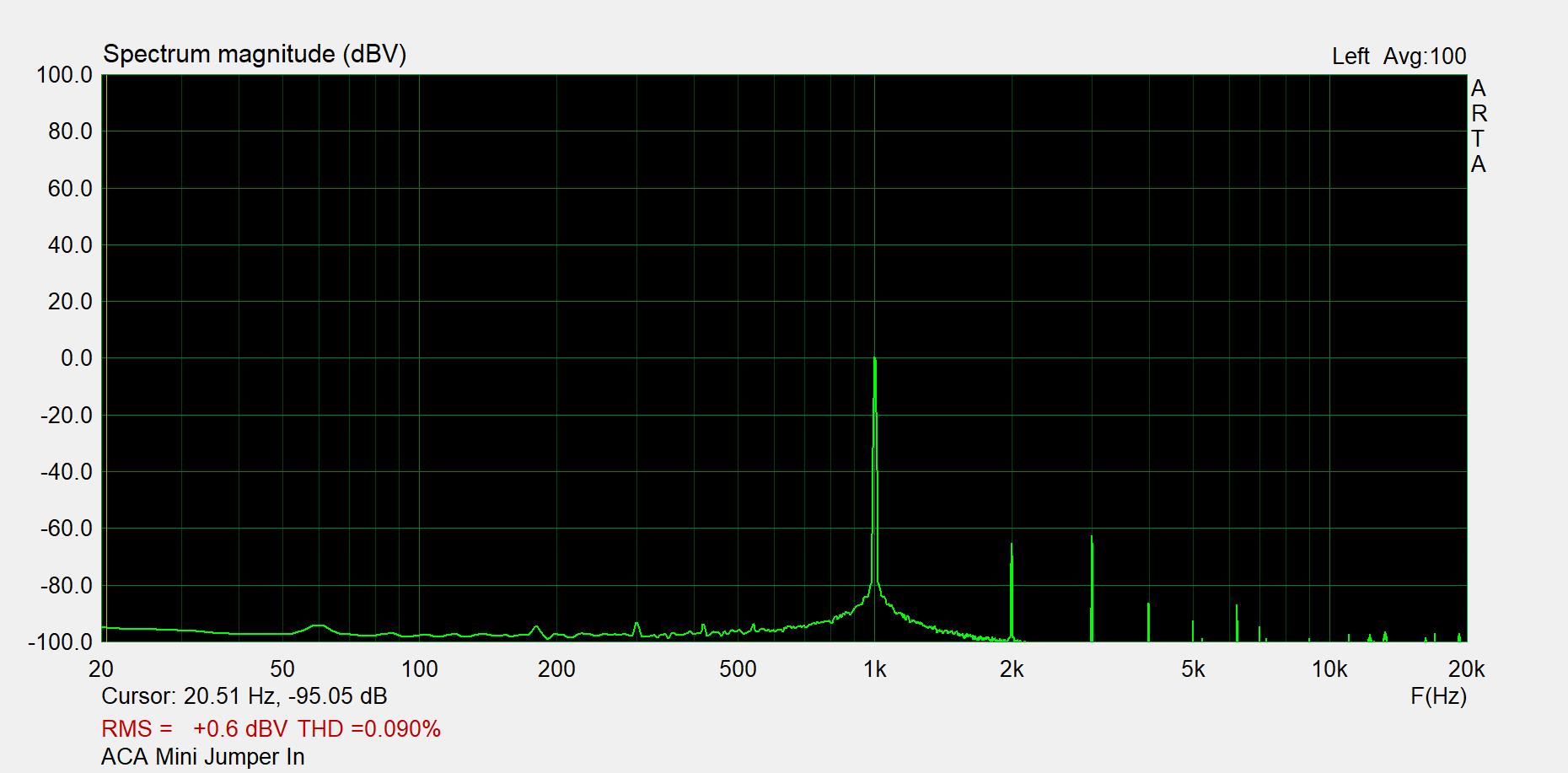

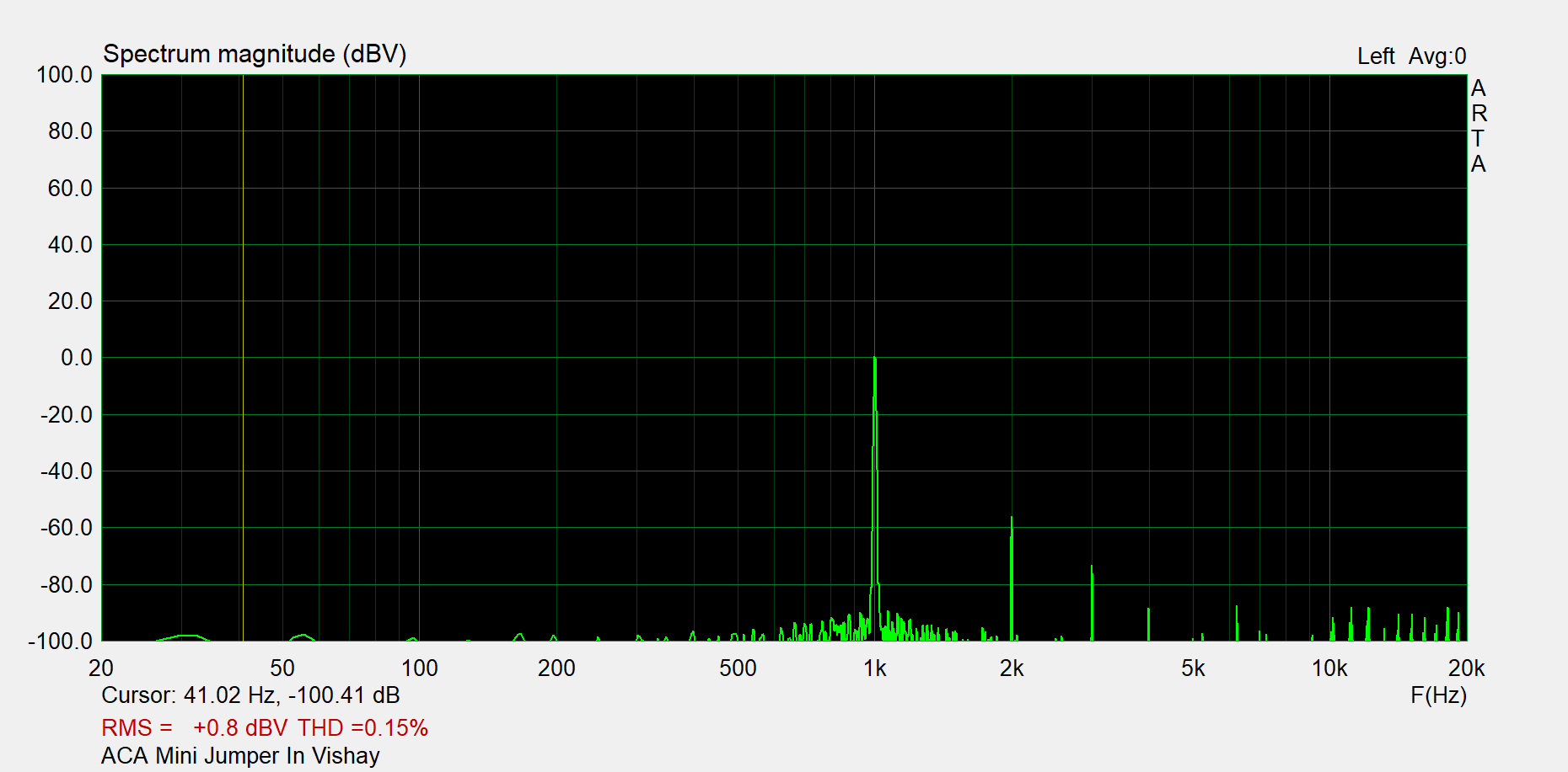

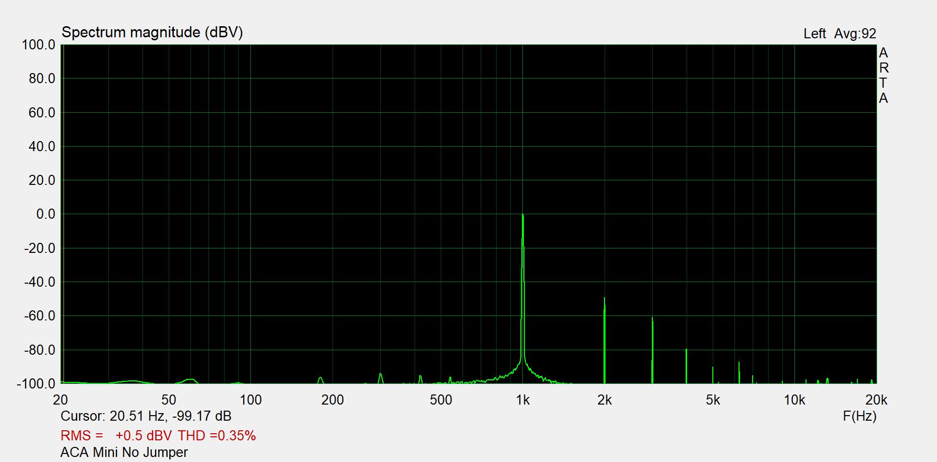

I installed the Vishay parts in the ACA Mini and got these measurements. Slides 3 and 4 are reposts of the (maybe) Harris parts for comparison.

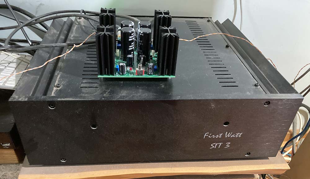

Ok, gave the amp a try in my big system. It is definitely a Pass amp: totally quiet, lots o detail without being “hifi”
Ie it’s relaxed but music is all there!
