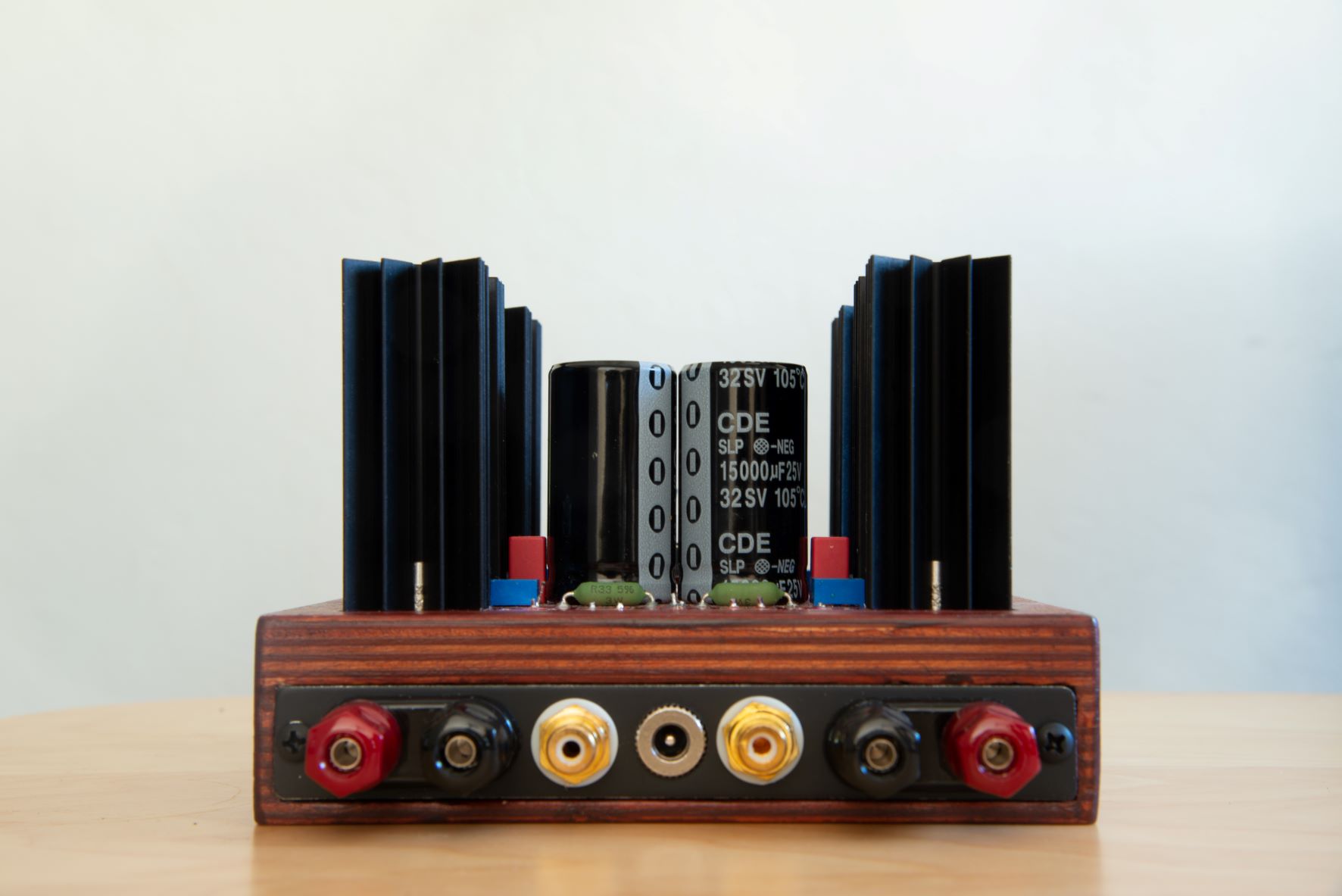

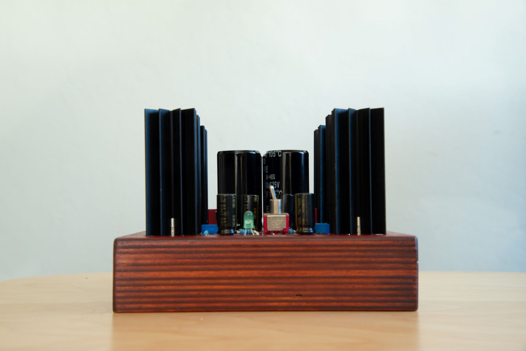

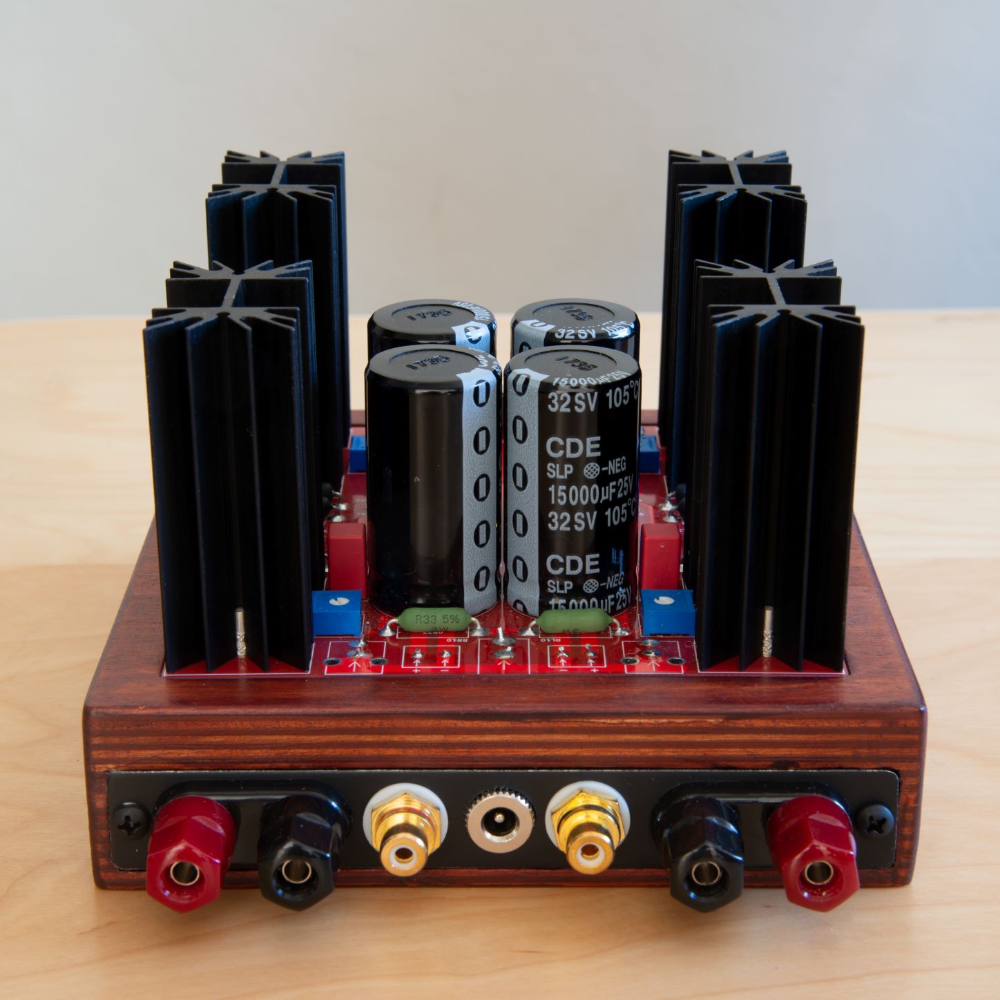

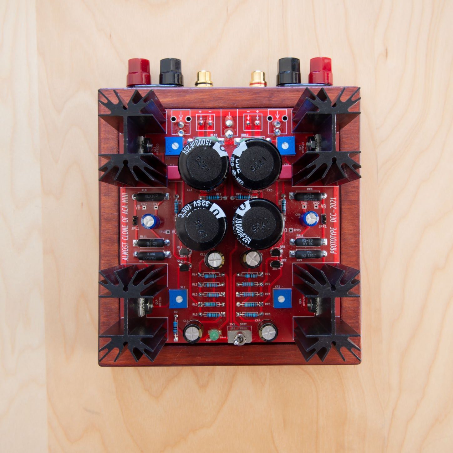

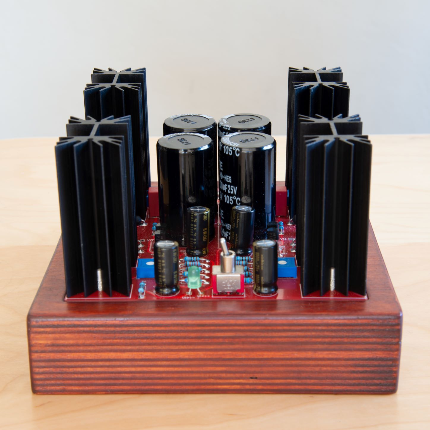

Another successful "Almost Clone" build - Thanks to Mark Johnson and Nelson Pass.
Completed the build last evening with IR MOSFETs. Sounds really nice. Here are some pictures of the build.
Wooden base was built by my son.
What he said. Very nice work on both your parts!Beautiful build!![]()
Very nice looking warm wood build and clean.
Quick question... what does the underside look like? Is it closed and boxed in with wires attached to the screwed in back plate or is it all open with the wires connected to the back plate that way?
TomV, the boards for Group Buy #1 and Group Buy #2 , which are very ably organized and administered by @KevinHeem, are clones of Nelson's PCB, the one he gave away twenty copies of at Burning Amp 2021. Nelson showed its PCB layout in the .pdf attachments to post #1 of this thread. I cloned Nelson's board size and hole placement too; he provided a mechanical drawing in post #311 and 312 of this thread. Which I copied down to the nearest 0.25 mm.
The underside is closed. The back side was routed using a trim router to a depth of 1" to screw in the back plate with connectors. The top was routed to 0.5" depth to mount the PCB.
