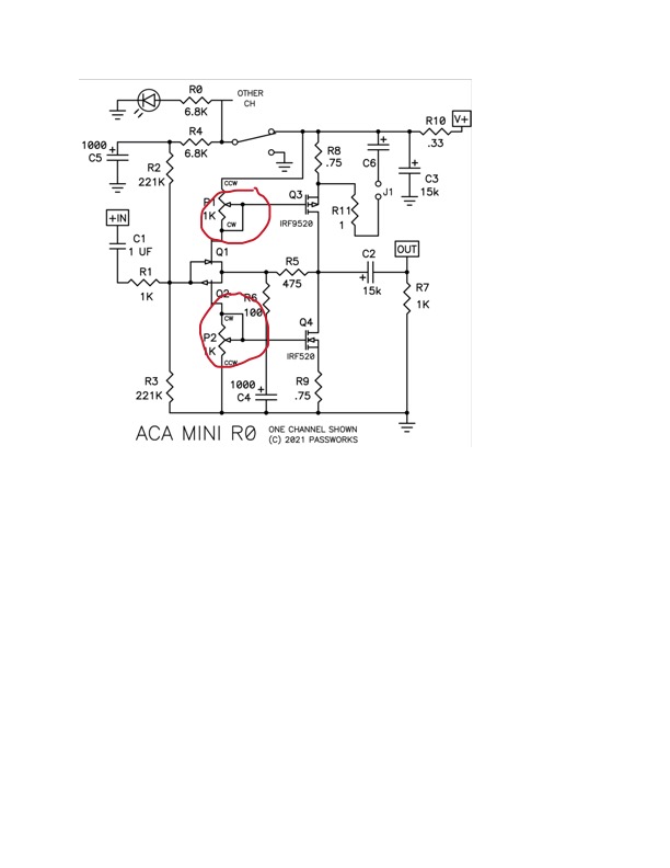

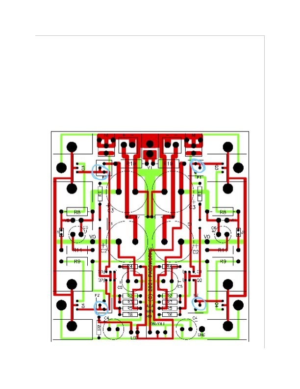

I have pairs at 8.5ma Jfet's I would like to use. I don't understand the concept of bridging the wiper and cw pins. In looking at the schematic it seems these pins are already connected in the circuit.They shipped with 6 ma idss. For less they might need a larger value on the pot.
If you use more than 7 ma I recommend bridging the wiper and cw pins on the pot to keep the Vds of the jfets at an adequate voltage. The idss limit on the jfets would be that of dissipation, but there is little advantage to the higher values

ACA mini calibration needs to be done slowly. In mine there exist only one setting that sets both the bias and center voltage where they should be. It's one of those situation where you need to make one worse with one pot to make it better with the other. 😒

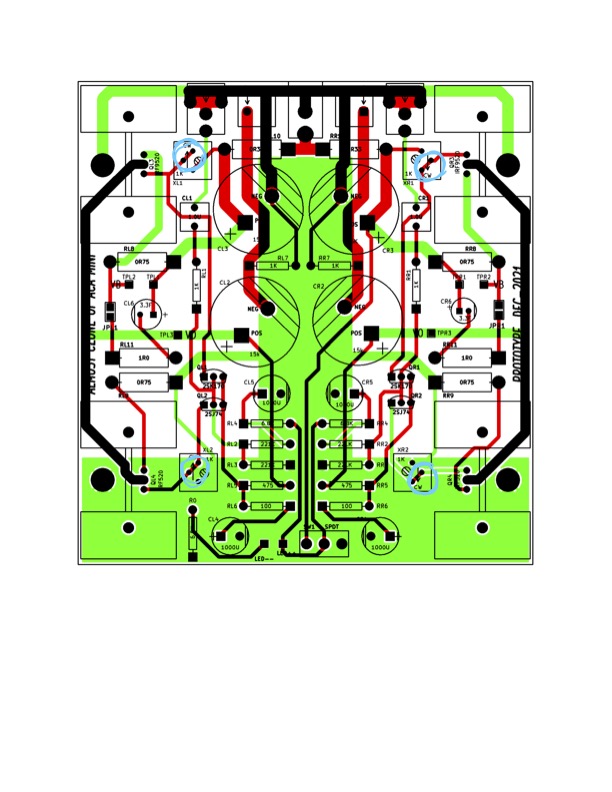

I recall reading somewhere that the earlier art work was missing that connection.
Because the original artwork was missing that connection, I simply used jfets with less than 7 ma. With higher idss you might consider the bridge between wiper and cw pins. No big deal, future art will have it. By the time it reaches the store it will also fit a standard picture frame per Variac's request.
