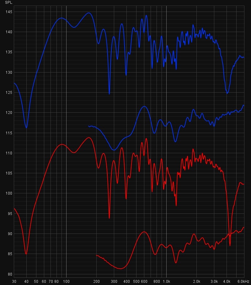

I just took some measurements of the same driver in the second enclosure (same design), and then I tried the second driver. Traces look very similar (both have that same drop in the 250-300hz range. I will upload a picture of the traces shortly (raw without any adjustments).

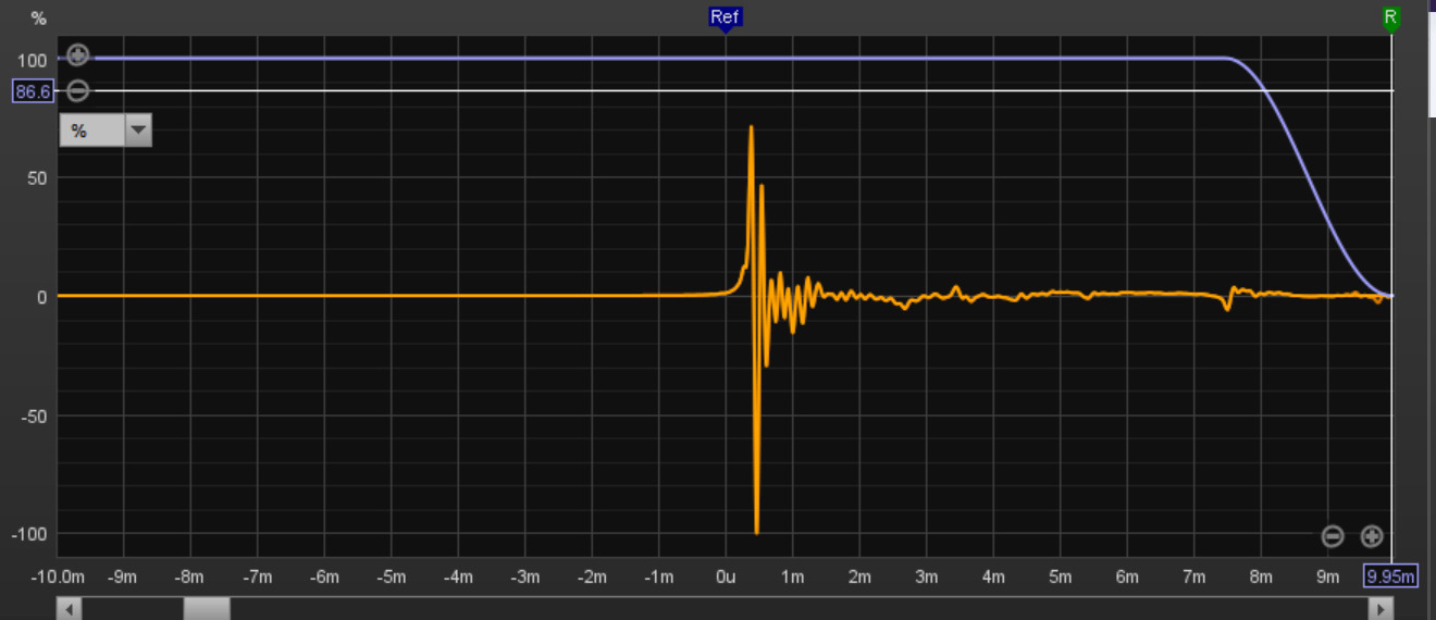

I still think your measurements are off. Could you post a graph of the impulse response? And a pic of your microphone setup?

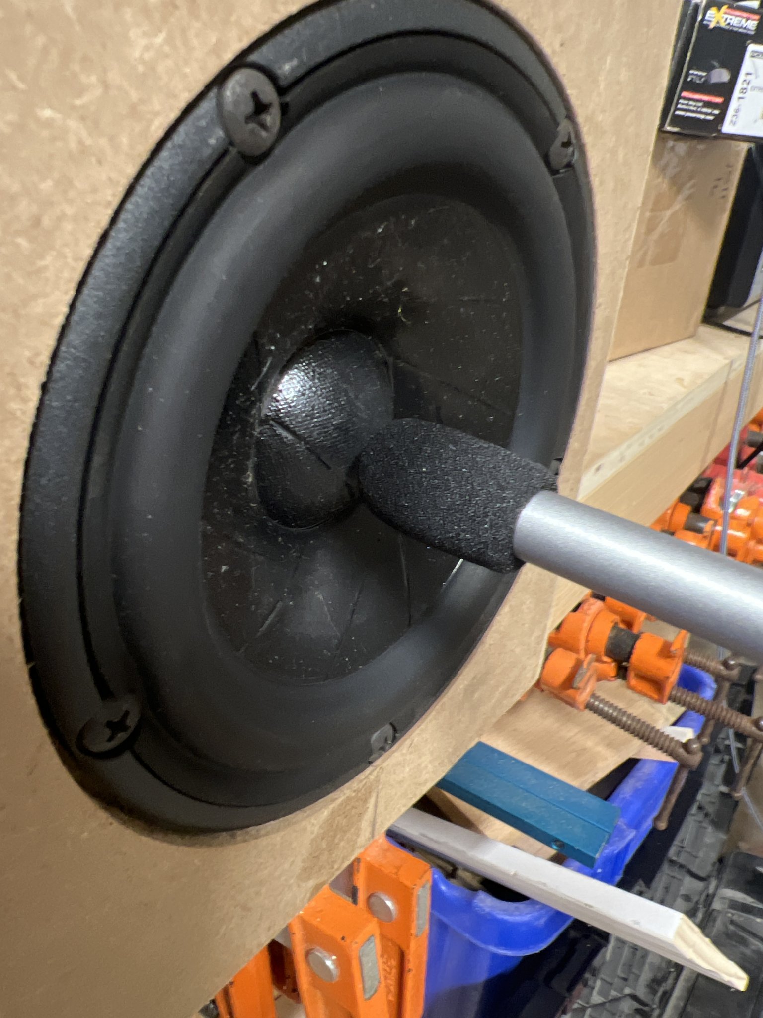

This is generally my microphone setup for near field. Far field is the same… just a few feet back. (this is a mockup btw. real testing was done without anything on or around the speaker, other the the speaker stand and the microphone stand. The computer, amp and such were all behind the enclosure.

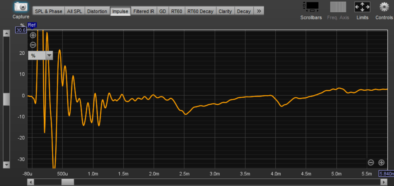

Here is the impulse response. I moved the window way to the right so you can see the full impulse response. The first response was taken at 0deg, outside today(green color). The second picture (orange color) was taken the other day in the warehouse I mentioned previously. The third picture (purple) was near field taken in the warehouse the other day. They do look different from one to the other, maybe I switched the pos/neg wiring from one day to the next.

The reason the TW doesn't have data below 1000hz is I only swept from 1000hz and up (I was worried about damaging the tweeter with a sweep starting too low). For the woofer, I stopped the frequency sweep at 6khz. do you think I need to sweep the tweeter starting at a lower frequency?

You can go lower with the tweeter, I usually start at 500hz. You should go full range with the woofer.
@wafflesomd ... by full range you mean up to 20khz? since I am crossing under 3khz, do I need to rerun full range?
Doing full range woofer measurement will only give you more data to help in xover design, there's no downside. Cutting it short however can negatively impact what you have to work with to make filters. Many woofers have break up fairly high up that needs to be in the measurements.

Thx. Your impulse response isn’t clean. After 2ms there is something odd and it’s there in all measurements. Since your level sweeps are far from flat, it’s worth trying to get rid of it. 2ms equals about 2ft extra path length. It’s a pretty broadband signal, it seems to start just above 100Hz and maxes out in the midrange. Also the microphone clip you use, will reflect and cause non-ruler flat measurements at high frequencie.

Your stand looks just short of 68.8 cm (2 ms), judging from cabinet height (32 cm according to ASR). My guess is that you either placed something just in front of the filing cabinet, thinking it being in its shadow wouldn't affect the measurement, or it is the filing cabinet itself, if I underestimated the height of the stand due to perspective.
In any case, your measurements include a strong reflection of an object that should be easily identifiable.

In all of these cases I am seeing something in the impulse at 2.5ms and 4ms. (blue is tweeter, orange is woofer). How worried should I be with these blips?
You must exclude all reflections, and a gate of 2.5 ms is not good enough.How worried should I be with these blips?
