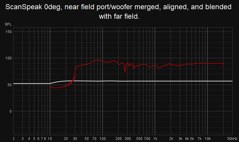

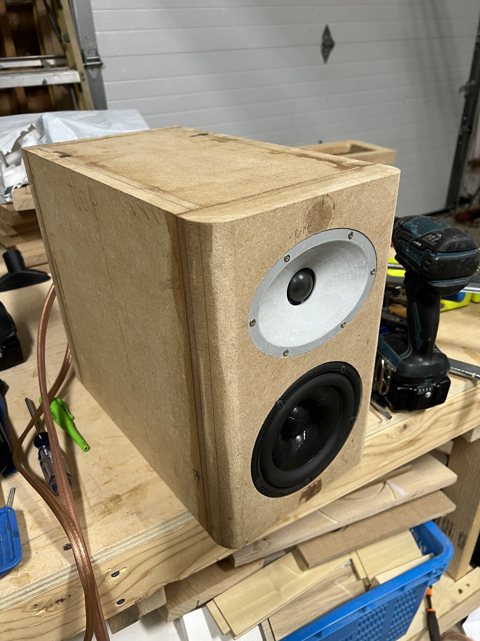

I am trying to replicate the Revel M105 copy project from ASR, but with a different tweeter. I built the cabinets, the waveguide, mounted the speakers and am ready for the next step (crossover design). I have taken horizontal measurements of both the tweeter and woofer while mounted in the enclosure (driving each one separately).
In the case of the woofer I have collected near field measurements and the same for the port. Microphone placement was about 0.2" from the cone center, and in the case of the port, the microphone was pretty much inside. I used REW, a UMIK-1 to collect measurements all driven from a yamaha amp without changing the output volume (near field measurements were at a lower volume due to clipping).
I combined the port and woofer near field measurements and adjusted the port SPL using the appropriate formula (20Log(portdia/woofereffectivedia). I then adjusted the near field for the baffle diffraction. Once I had a cleaned/combined/adjusted near field I blended with the far field 0deg measurements to get the response shown below.
The woofer is a Scanspeak 15W/8530K00 and the tweeter is a Morel ST1108 supreme.
I have a few questions and am looking for some expert advice.
1. How do I determine what the port tuning frequency is at right now? (Jeff bagby paper references a drop in SPL, which should occur at the tuning of the enclosure, but I don't really see it). I am targeting about 40hz for enclosure tuning and cut the port length appropriately (2" diameter port).
2. What is going on with the scanspeak at the 250-3550hz range. Why is SPL dumping out? Should I be concerned? Where should I be looking to try to address this?
The enclosure is made from 1" MDF walls (2 pieces of 1/2" glued) and the front is 1.5"MDF (3 pieces of 1/2" glued). The internal is braced and I glued some melamine foam to the interior.
Here are some pictures. I appreciate any help you can provide.

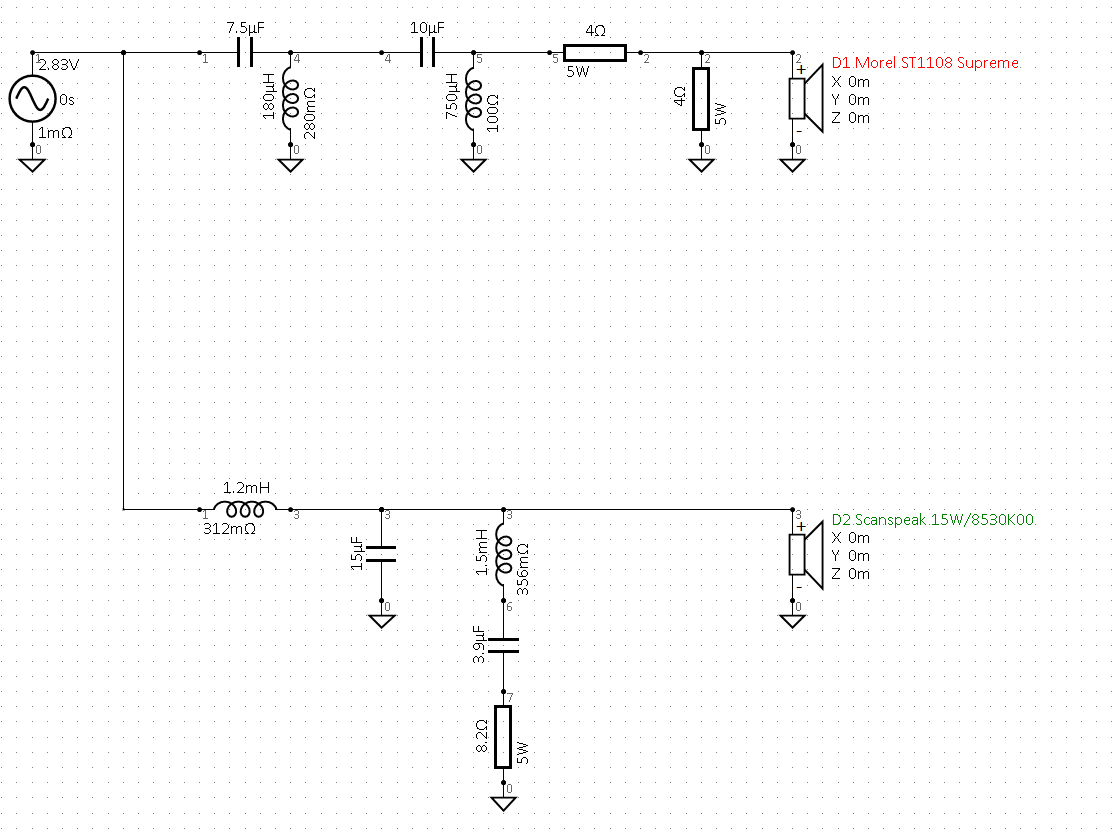

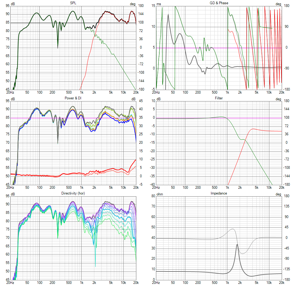

Here is my attempt at a crossover.

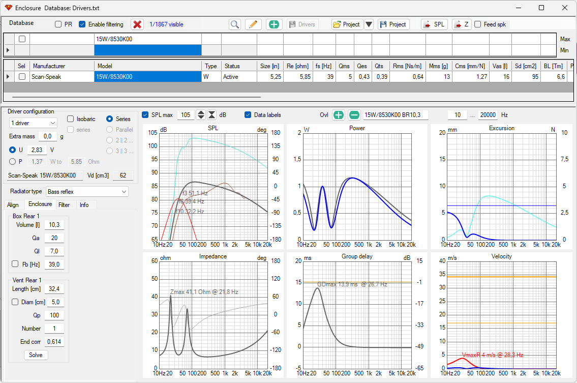

Yeah, at tuning (Fb), the woofer basically stops moving with all the output coming from the vent.
What is the cab's net volume (Vb) after deducting driver, vent, any bracing volumes? Vent design details?
Thanks for both your responses.

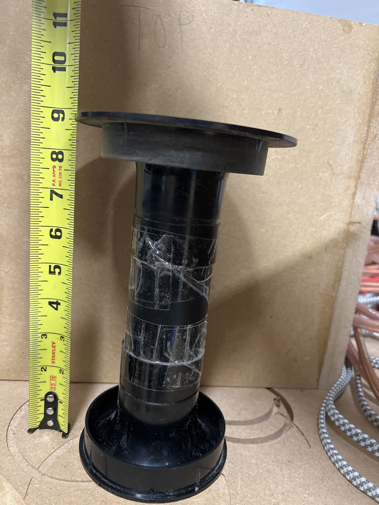

Enclosure internal volume (after deducting woofer, tweeter, vent, and bracing) is 12.17L. Vent is a 2" diameter vent (precision port 2") with dual flared ends. Overall length is 8.66" (or maybe even as low as 7.66"...I need to open the enclosure and remove the vent to measure...my build notes are somewhat conflicting on this point). I also think when I calculated the port length I forgot to deduct woofer, tweeter, vent and bracing.... interesting point on the vent..it is sort of a chicken and egg thing. You don't know the vent volume until you make some starting assumption and calculate vent length. I suppose it becomes an iterative process.

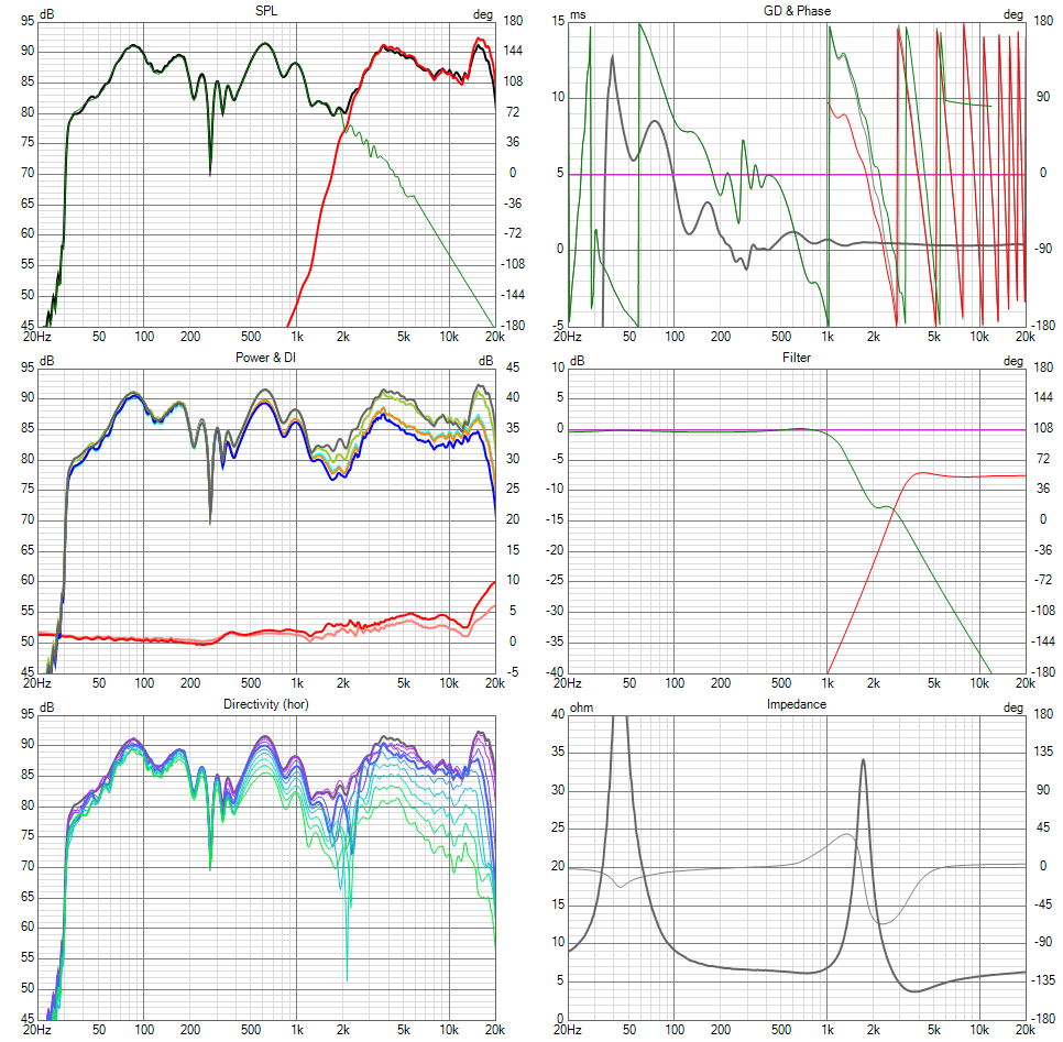

I don't know what is up with my 6-pack plot from my initial post. it doesn't seem to look like my current plot (specifically the impedence curve, the other curves look the same. I think I grabbed it when I had tried using the manufacturers impedence curve trace.
For impedence curve, do I just use a trace of the manufacturers datasheet? If not, how do you collect that data?

Fiddled a bit with 12.17 L net, flared port @ 8.66" long and once all end corrections are accounted for it's closer to ~4.6" long acoustically = ~55 Hz Fb, which sims near enough perfect to your measured peaking/roll off response due to being too high/under-damped for the driver's specs, though not your impedance measurement, so it's definitely wrong for whatever reason.

@Lojzek I have uploaded the responses requested and here is a picture of the crossover as designed which is represented in the 6-pack of images. (I am not any sort of expert on this, but just took a swing at making the response look like other designs have shown).

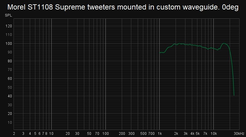

Tweeter: Morel Hor 0 <-- measurement taken at 21.5" away from baffle.

I also included the combined/correct near field port and scanspeak, as well as the blended near/far response.
@GM Where do you get your impedence measurements from? I don't think I have any equipment to really collect these, other than the accurate Re measured with a multimeter.

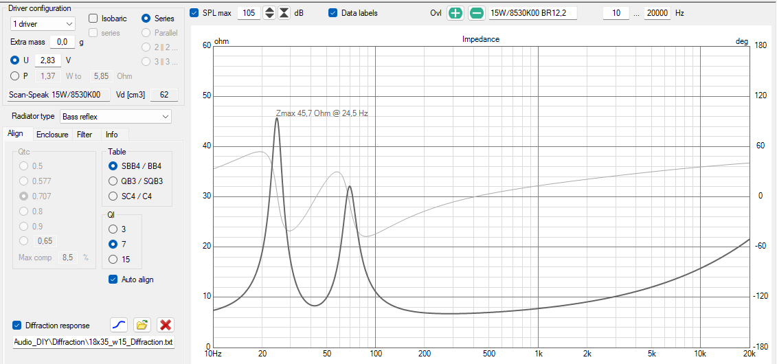

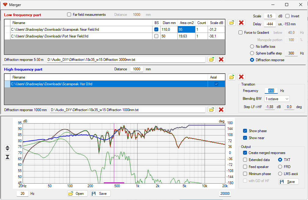

That is the impedance calculated/simulated by the VCad Enclosure tool. You have to input in the VCad main program the impedance of the SS 15W measured in your cabinet by means of REW or the Limp tool in Arta.
This is what you get in Vcad when you input your data related to your volume/vent.

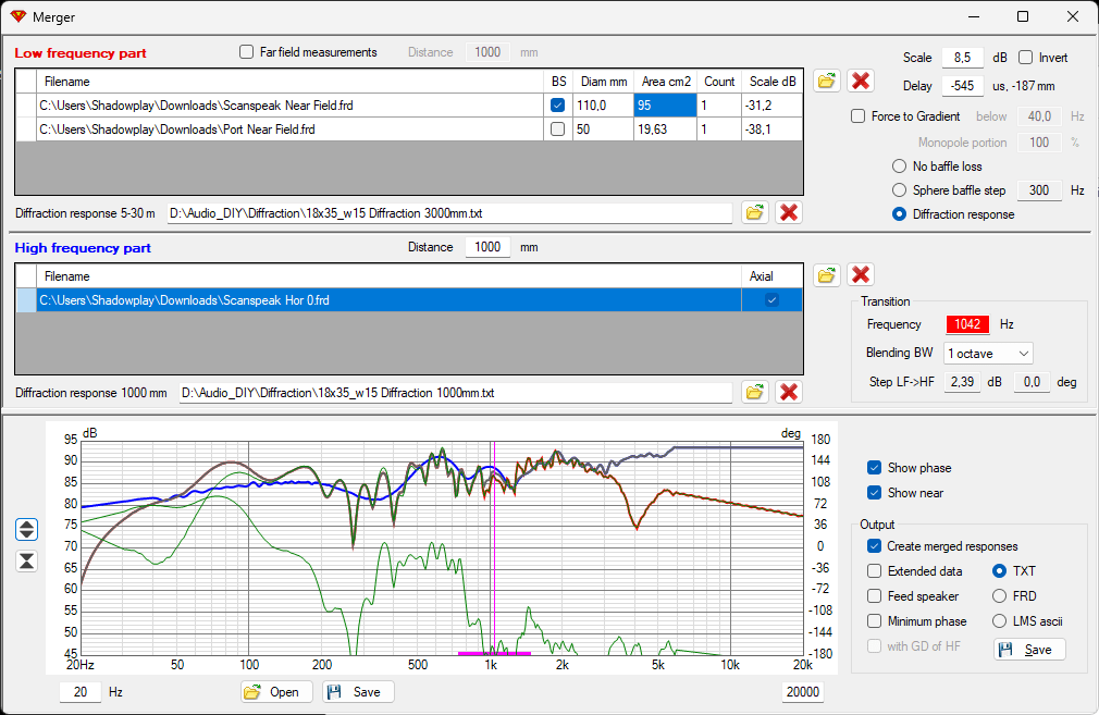

This is the merging with your FRD files and the diffraction response I simulated for a baffle of 7x14" (18x35cm). It seems like the mic is catching some room/box resonance mode in the measurement of the cone.
Besides, the measurement is interrupted above 5KHz so you cannot use it for calculate your crossover, the same happens for the TW under 1KHz.

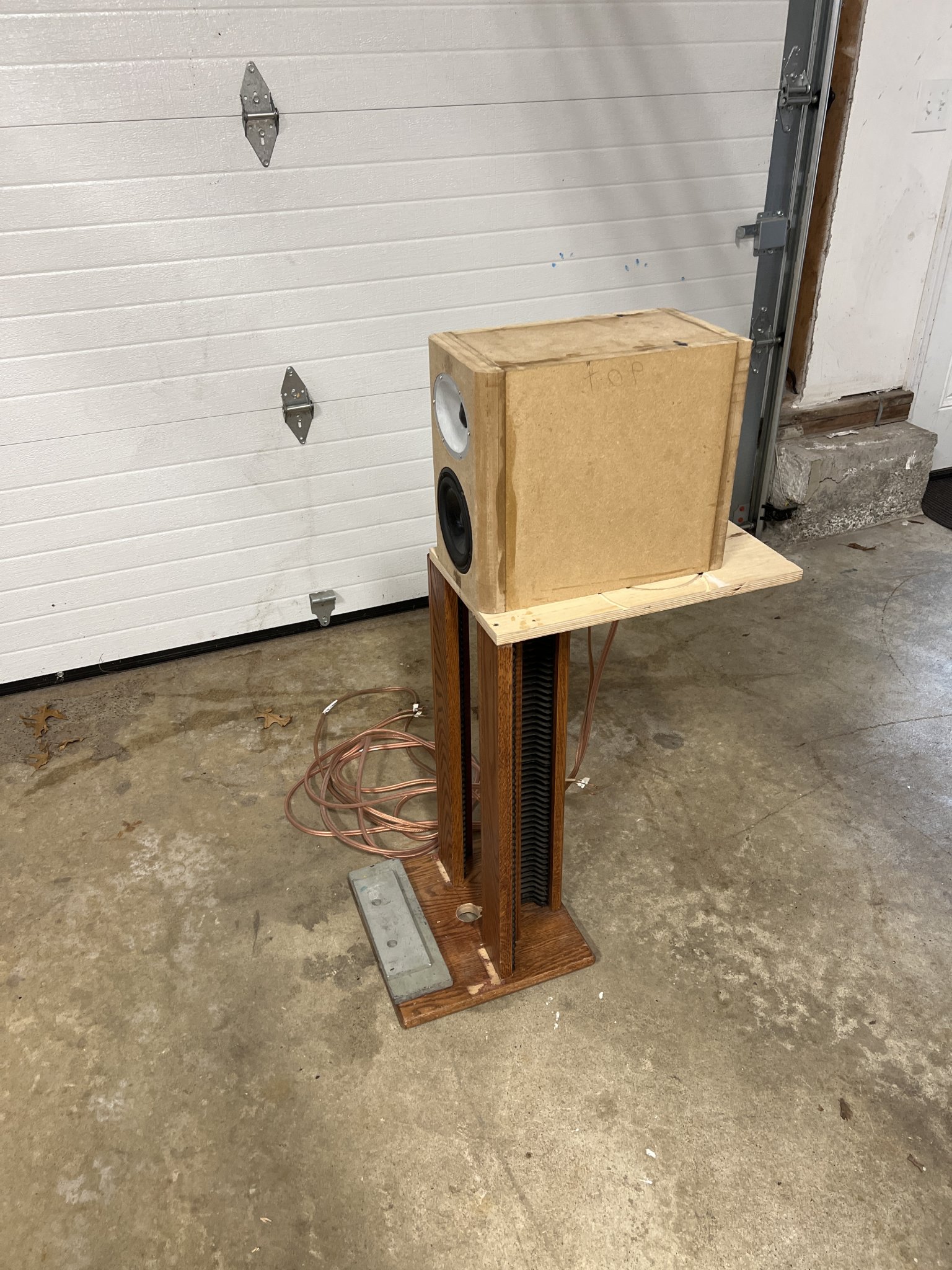

@markbakk I took the measurements in a warehouse. So the 0deg measurement didn’t have a wall opposite the speaker for over 100meters. To the left and right maybe there was a support beam at about 10meters or so (at a diagonal). I will mock up my setup and post a picture later today. Maybe my stand was causing it?

This is the measurement stand I placed this on top of a filing cabinet to get the center of the woofer at/about 5ft off the ground. The cabinet stuck out about 8” to the left of the bottom of the stand.
Does it make sense for near field data to be affected by room reflections? I was under the impression that near field was so close to the speaker that it isn’t.
If you're measuring in your garage, try doing a ground plane measurements, and do the measurements with the door open.
