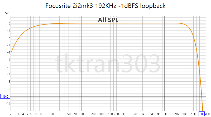

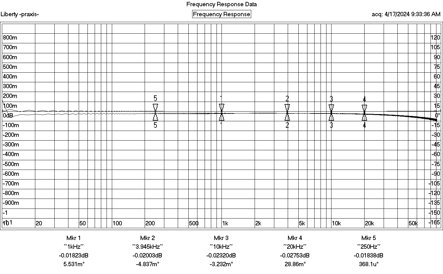

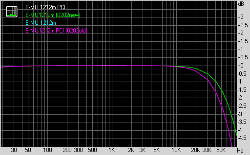

The limiting factor seems to be the class D amplifier.
Plenty of audio interfaces and class A/B amps make it past 50Khz…
Reference:
https://www.ixbt.com/proaudio/emu-1212m-pci-pro.shtml
Reference:
50kHz yes. 70kHz a lot less. 🙂Plenty of audio interfaces and class A/B amps make it past 50Khz…
Also, that is at -3dB so for a freq resp you have to correct accordingly.

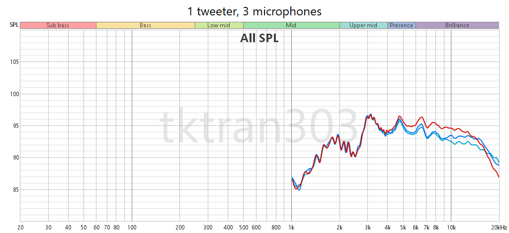

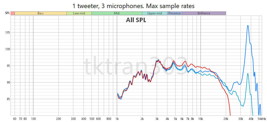

Here's the same tweeter measured by 3 microphones: All microphones come with electronic compensation files from their respective manufacturers.
1 mic <1 week old, 1 mic <5 years old, 1 mic ~10 years old.
There are some minor difference in the top octave. This is not unusual.
Since I'm an amateur, I'd be more likely to trust the new one. But all are OK for personal use, and if I only had one mic, I would just tweak the speaker to taste.
What do the professionals here do? @IamJF @Boden @b_force ?others?
Would you send them off for recalibration if you had these deviations in the top octave?

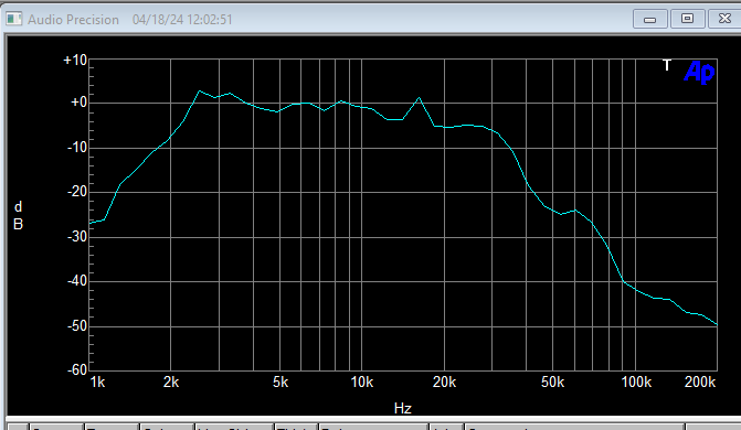

Here's the same tweeters when I extended the measurements as far as I could go:

That depends how much you care about it, lol 😀 😀 😉Would you send them off for recalibration if you had these deviations in the top octave?
As long as you know there is some small discrepancy above 10kHz I personally wouldn't bother that much.
In the end tweaking is sometimes also done by ear anyway.
It's different if you just simply don't have any clue what's going on at all.
Especially with troubleshooting that becomes a guessing game, which in my opinion just really sucks especially in those moments you can't use another unknown variable.

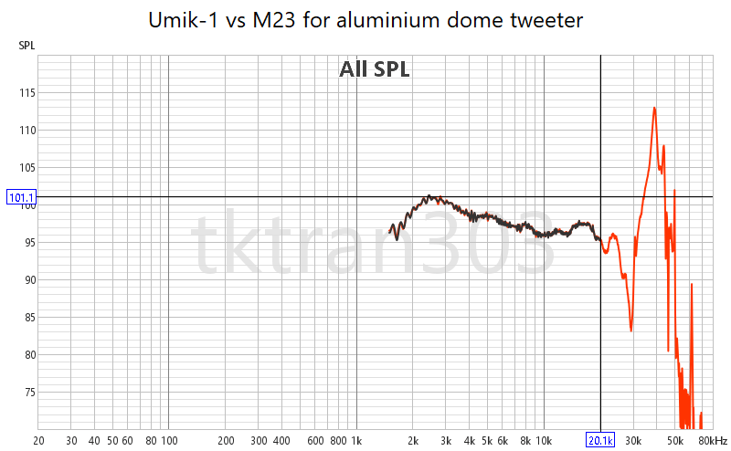

That being said, from the 2nd picture, the resonance peak seems to be totally gone?
Do the lower harmonics still come trough (they should be)?
The M23 and M30 have useful measurement capability past 23KHz, even as far as 50KHz, albeit uncalibrated. I’ve had some correspondence re: this. Thank you William.
This is an undocumented feature of the Earthworks microphones.
With the Xref20, the resonance appears a little subdued. The lower harmonics do come through, so there’s a hint…

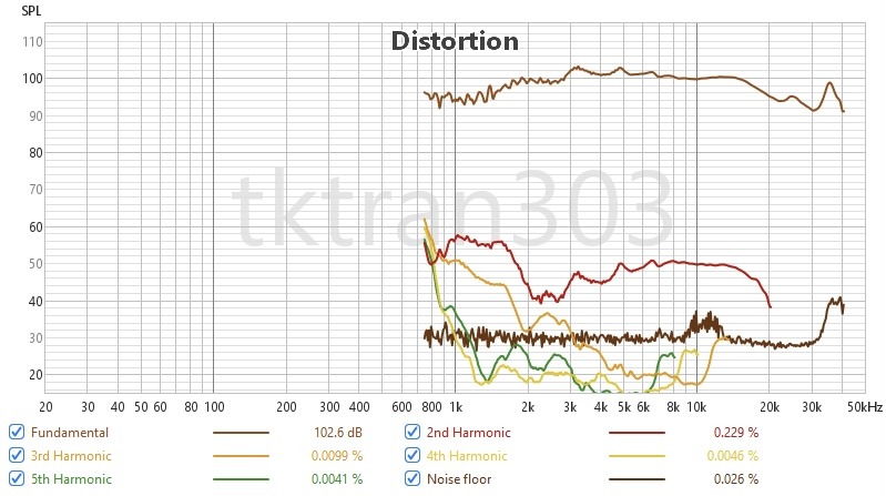

The 2nd picture is a measurement from the Umik-1, which is a USB enabled mic with an ancient 16bit/48KHz ADC, limiting the measurement to 24KHz. A Omnimic might also exhibit this, although I have not confirmed this. Without it may appears like there is no resonance (Umik-1, Omnimic)
This is a blind spot if measuring hard dome tweeter, which indeed is.

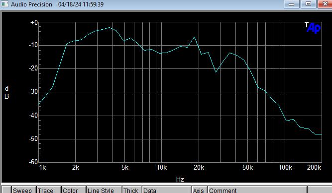

I just remeasured the pioneer ribbon with different hardware- same mike. The horn smoothes the response however it also costs some HF lowering the corner from 45K? to 30K. Regardless this ribbon is not that useful above 40KHz. I need to find a transducer that is. I could reverse the 4136 if I had the right hardware and use it. But thats getting pretty crazy.
Pioneer has some tweeters that claim 100 KHz but I'm not spending $1K to find out.

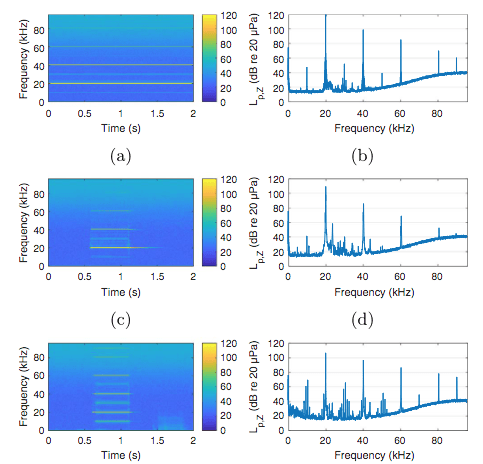

I don't know what would be "useful" in your application, but transducers used for ultrasonic cleaning and welding are relatively cheap.Regardless this ribbon is not that useful above 40KHz. I need to find a transducer that is.
https://acta-acustica.edpsciences.org/articles/aacus/pdf/2020/04/aacus200008.pdf
Ultrasonic transducers also generate audible harmonics of the fundamental frequency, 20kHz in this example:

Blue one looks most realistic. What tweeter is that, reminds me to ScanSpeak Beryllium.Here's the same tweeters when I extended the measurements as far as I could go:
Good sources for HF measurements are
a) T25B without grid, resonance at about 50kHz and pretty flat below.
b) A ring radiator, ScanSpeak with strong magnet keeps level best. These go down at high frequencies but have no resonances - so they are easy to compensate. High H2 of course and are beaming at high frequencies but can be used pretty high.
This is an aluminium dome tweeter with optimized geometry.

@bwasloA Sony SS-CS5 speaker does a respectable job to near 80kHz as a source. Cheap, too.
This is several inches above the supertweeter axis (to avoid an interference cancellation)
Is your microphone calibrated to 80KHz?

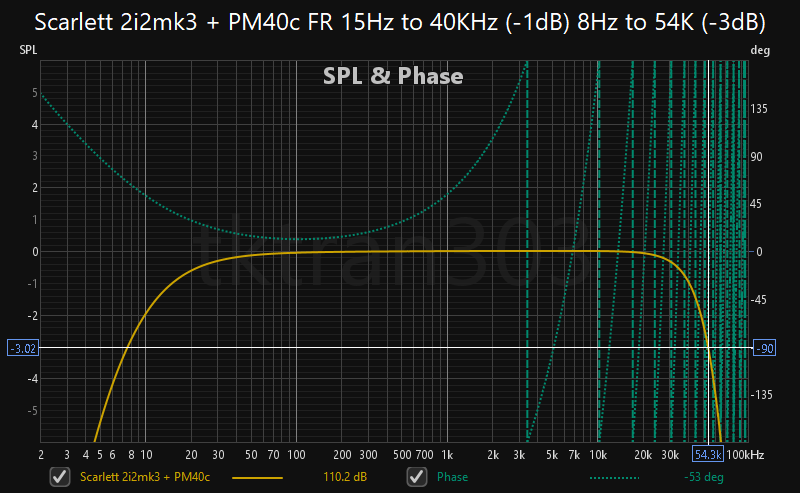

With "prosumer" grade 2 channel ADC/DAC with balanced in/outs and phantom powered mic inputs, this what achievable for $120 in 2019:
In combination with a low power class A/B amp- Thomann PM40c's LM3886 based amplifier is good to about 50KHz (-3dB 54KHz).
Compare what happens when one is measuring up to 20KHz vs 50KHz.
The piezo suggestion finally clicked. I'm an inveterate collector of maybe useless stuff. In that collection is an Endevco high level piezo microphone (good to 180 dB SPL) (also mentioned in the B&K lit) https://buy.endevco.com/ContentStore/MktgContent/Endevco/Datasheet/2510M4A_DS_082019.pdf And being piezoelectric its also a transmitter. And it seems to go maybe past 150 KHz as a transmitter. That a region where I need to remove the grid on the B&K to get any meaning. A quick test was encouraging. I'll set up someting more formal soon.
@bwaslo

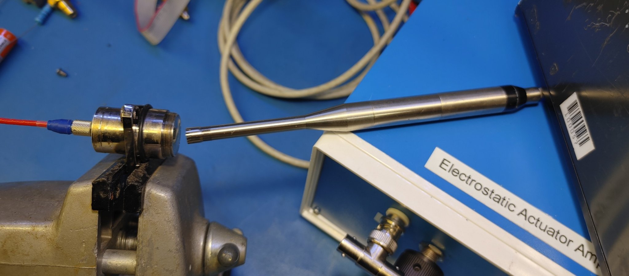

Yes, quite recently by electrostatic actuator. I also have a 7016 microphone, also calibrated, and get essentially the same measurement.

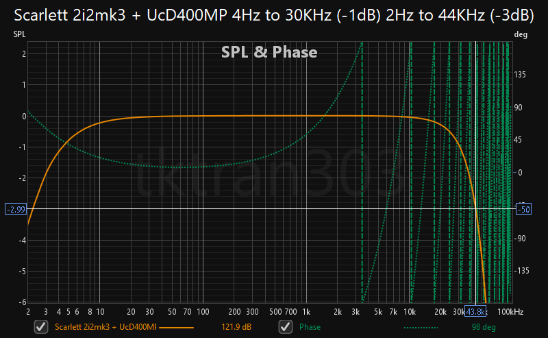

But that scary plot is 1dB/div, all of 10dB down at 80kHz. The amplifier gain is falling but still usable well above there. That affects the measurement dynamic range, improved by coherent averaging, but not the ability to measure frequency responses. The signal path doesn't need to be flat, it only needs to be taken into account and be linear without compressing or aliasing.
The measurement was ratio metric, spectral content at the microphone divided by spectral content at the speaker terminals.
