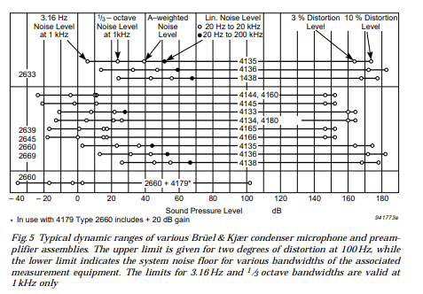

AFAIK, Brüel & Kjær spec their capsules at 3% THD, and peak SPL at 10% THD.

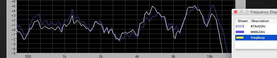

The chart below is of the response using the RTA 420 and a Panasonic WM62 measuring a speaker, same position for each, maximum deviation of less than +/- 2dB:
The RTA 420 response was -1 dB at 40 Hz, -2dB at 30Hz, -4 dB at 16 Hz compared to the Brüel & Kjær 4004.

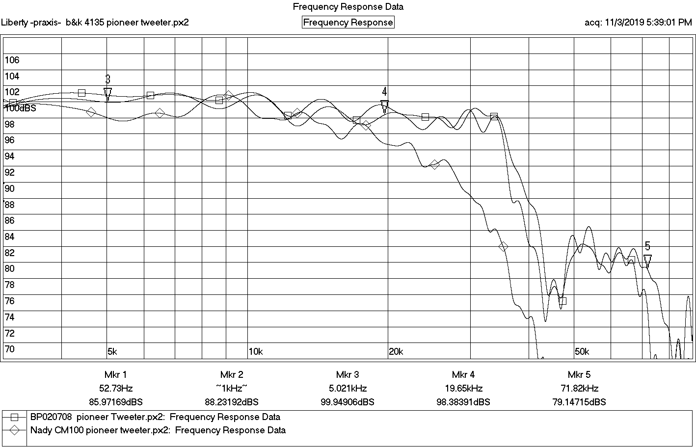

Here is a comparison of three microphones in my collection. The B&K 4135 is quite expensive even used but its specified to 100 KHz. The Girardin BP020708 is made from a Panasonic capsule mounted on a length of brass tubing Including a cal file it was quite reasonably priced. The Panasonic mikes were around $1.00 in qualtities of 100. The Nady is a typical example of the cheap pseudo measurement mike.
I used a Pioneer ribbon tweeter which was supposed to be good for maybe 70 KHz. It clearly makes it to 35 KHz. There are issues of diffration etc. that mess with the response but it still gives clear indication that the Girardin Microphone is adequate to response testing and I can keep the expensive stuff safe.
To add to the chart this is what B&K specs
