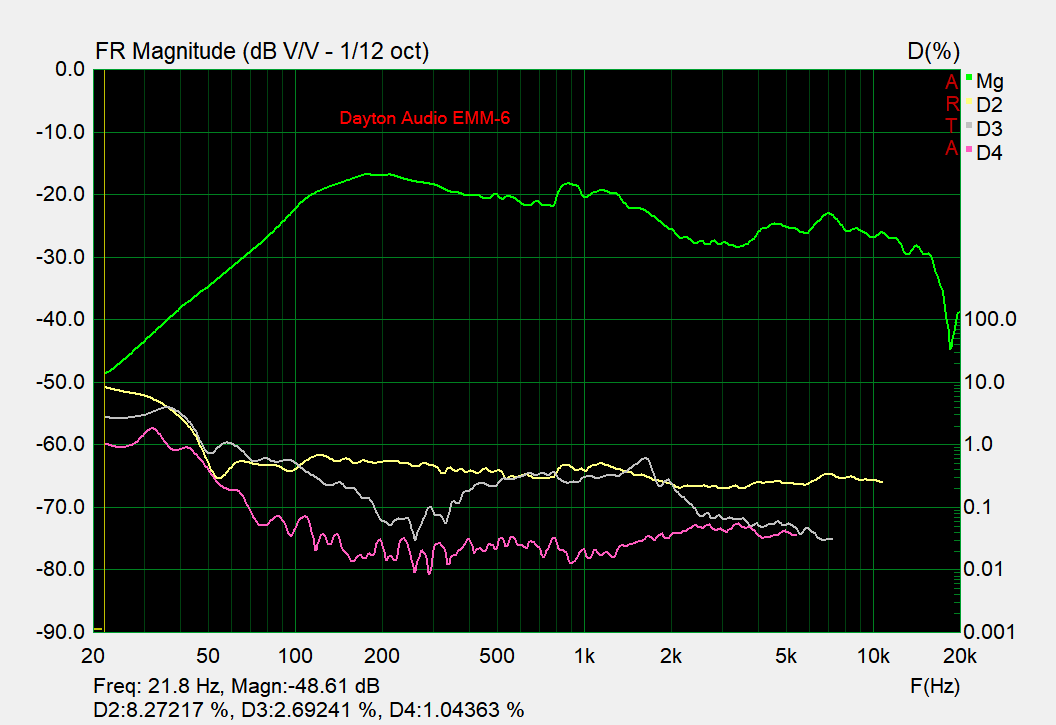

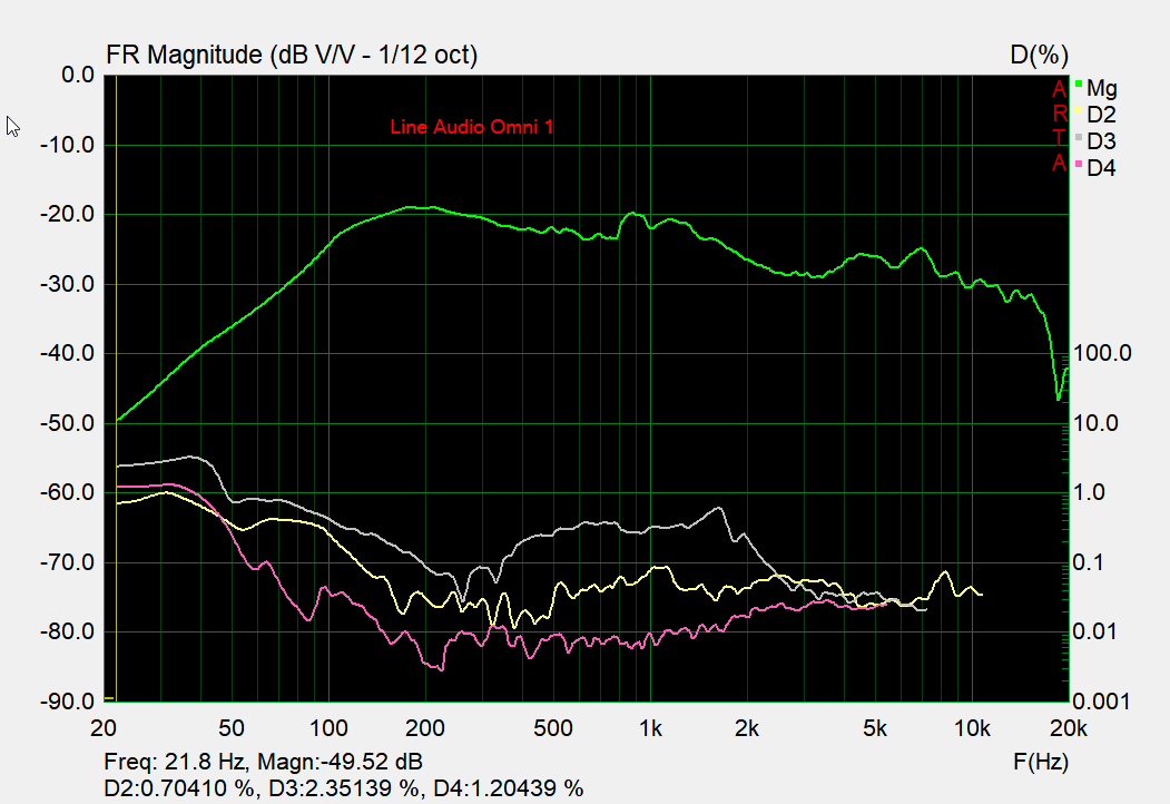

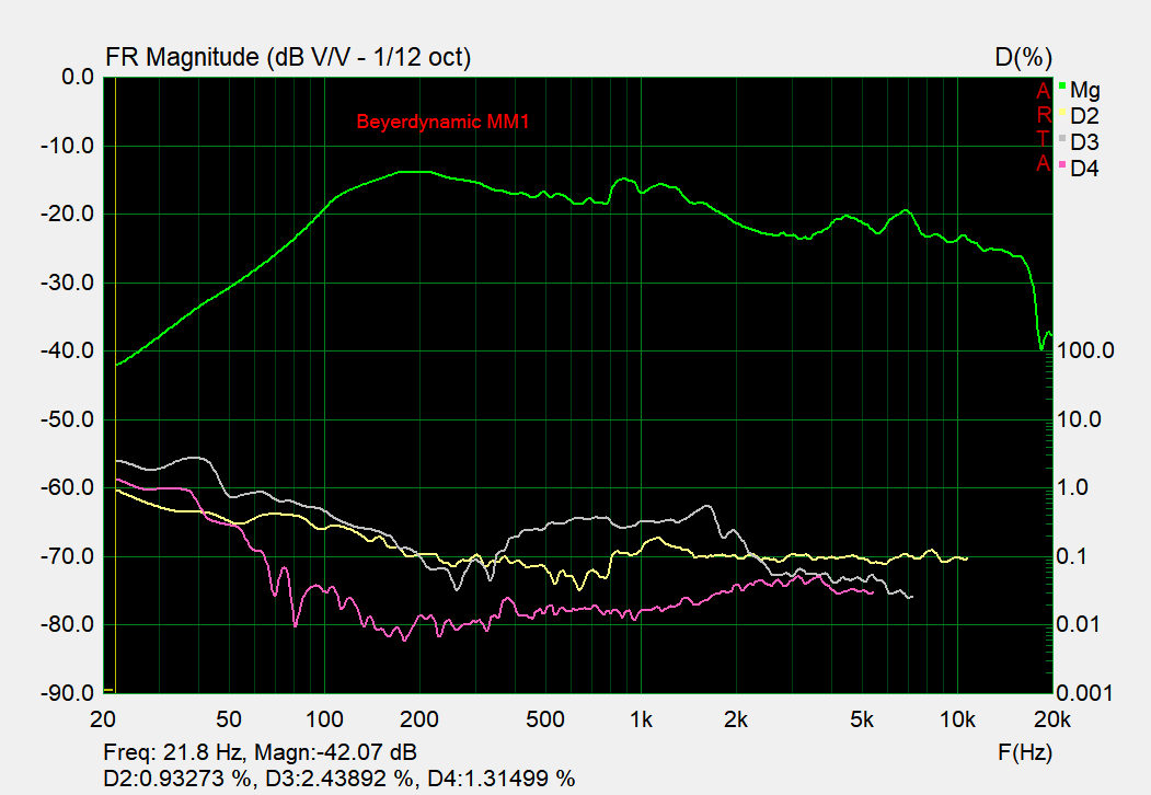

Since I have some work coming up this week and most of my stuff is STILL in moving boxes, I though you know what, let's just do a fun comparison since I have everything out anyway.
This is all measured at 95±3 mm distance, with a sampling rate or 44.1kHz and a sequence length of 64k (important! )
Mics in this test:
- Dayton EMM6
- Beyerdynamic MM1
- Line Audio Omni 1
Amplifier: LM3886
SPL was later checked and calibrated with the Dayton EMM6 with a B&K 4230 (just because of no particular reason) at a 115dB peak @ 95mm.
Although I will do another proper check again to make sure.
It doesn't really matter, it's about the relative differences! 🙂 (but nice to have the right numbers there 🙂 )
Speaker: no idea, some kind of Kenwood cheapo whatever, the rest is still in moving boxes 😀
Don't pay attention to the exact differences at the higher frequencies, except for the distance, the mics were NOT 100% exactly lined up (so above a certain frequency you will see differences)
But hello H2/D2/K2, didn't see you coming.
The effect is much worse at even higher SPL's, will show you after dinner or so 🙂
btw; pixel peeping will be punished! ☝️ 😉

Well not really, the Beyerdynamic and Line Audio are similar.I guess you refer to the low figures of the Line Audio eh?
Only the H2 of the cheap Dayton mic shoots up like crazy, while H3 stays basically the same between all of them.

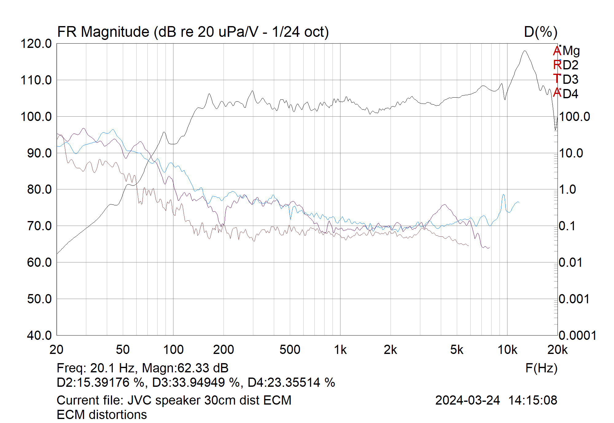

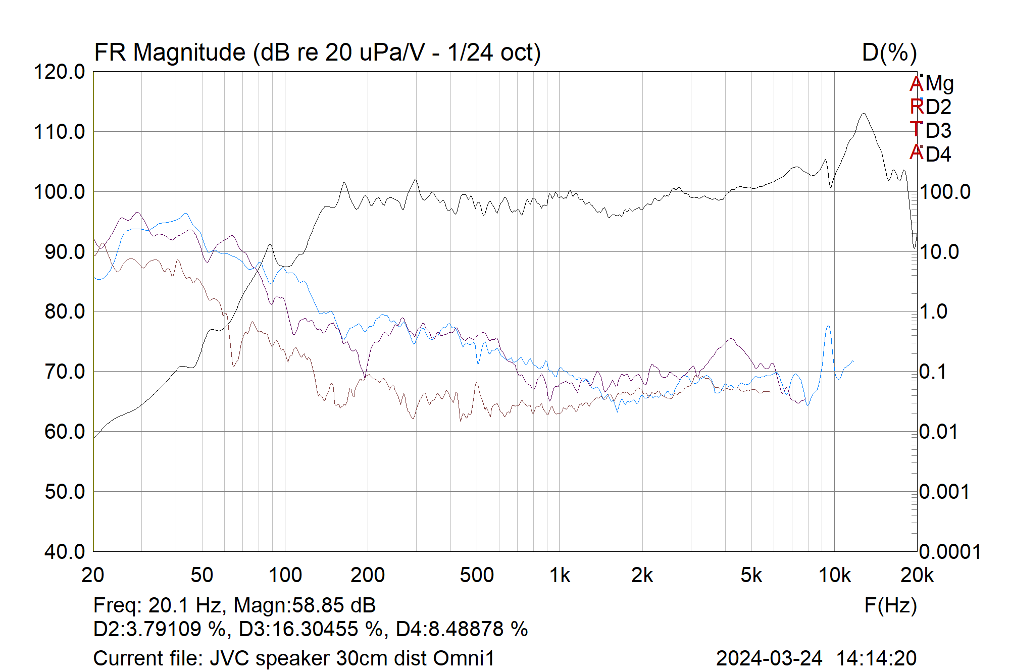

What I mostly wanted to show with these measurements btw, is the similarity with a lot of other measurements.
Sometimes you can clearly see a lot of 2nd order distortion around the same frequencies.
(I can show an example later)
Which makes you wonder if you're looking at the distortion of the woofer or just the mic?
I have seen cases where it just didn't make a lot of sense.
On the other hand (counter argument), it also make no sense why this would be a bigger issue at those frequencies and/or not the same with similar woofers (since they provide the same amount SPL)

Mics in this test:
... 115dB peak @ 95mm.
- Dayton EMM6
- Beyerdynamic MM1
- Line Audio Omni 1
H2 is what increases on microphones towards the upper end of their SPL range. This is absolutely usual and expected.
H3 is virtually unchanged between the three, because it neither hits an upper limit (measurement chain distortion) or lower limit (measurement chain noisefloor). So this is actually the driver's distortion, not that of the measurement chain.
H4 differs, obviously because it's so low it lies in the noisefloor of some of the mics. This would be even more visible if you included more higher harmonics, meaning H5, H6, etc. These should all virtually overlay each other on the worse mics (especially the EMM6), because they're all such a weak signal that they don't exceed the microphone's own noise.
