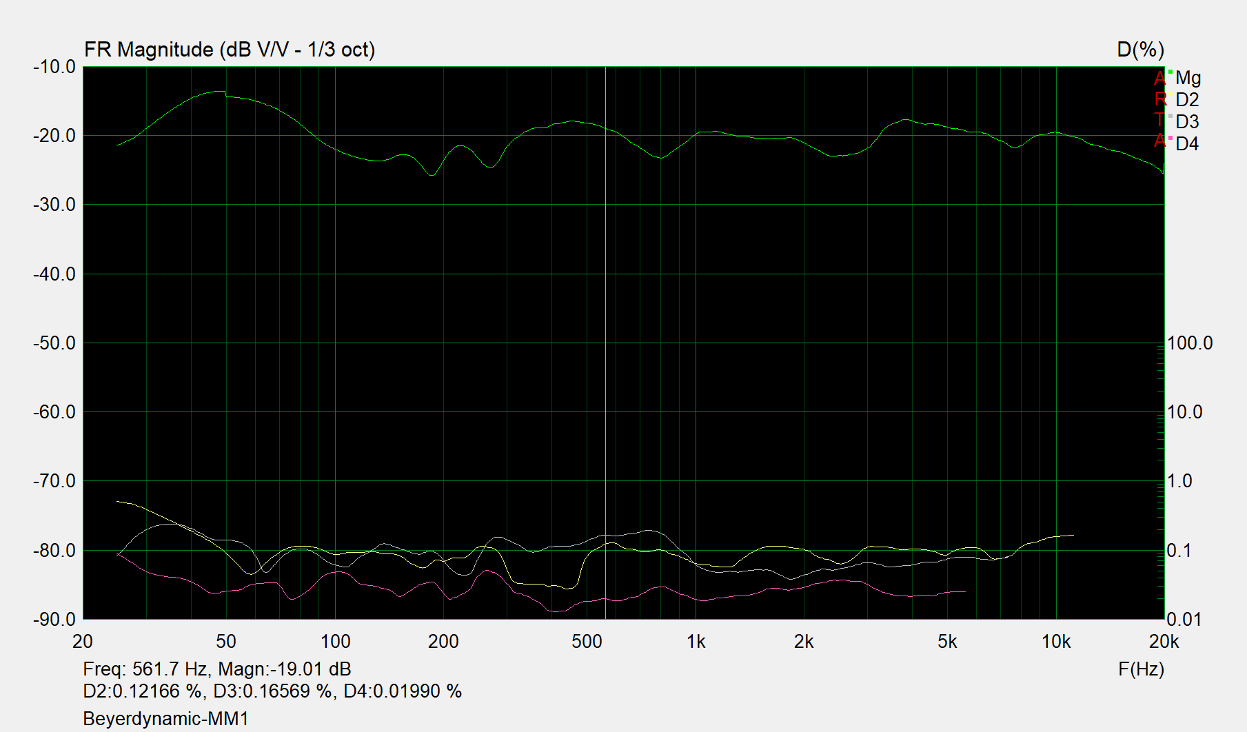

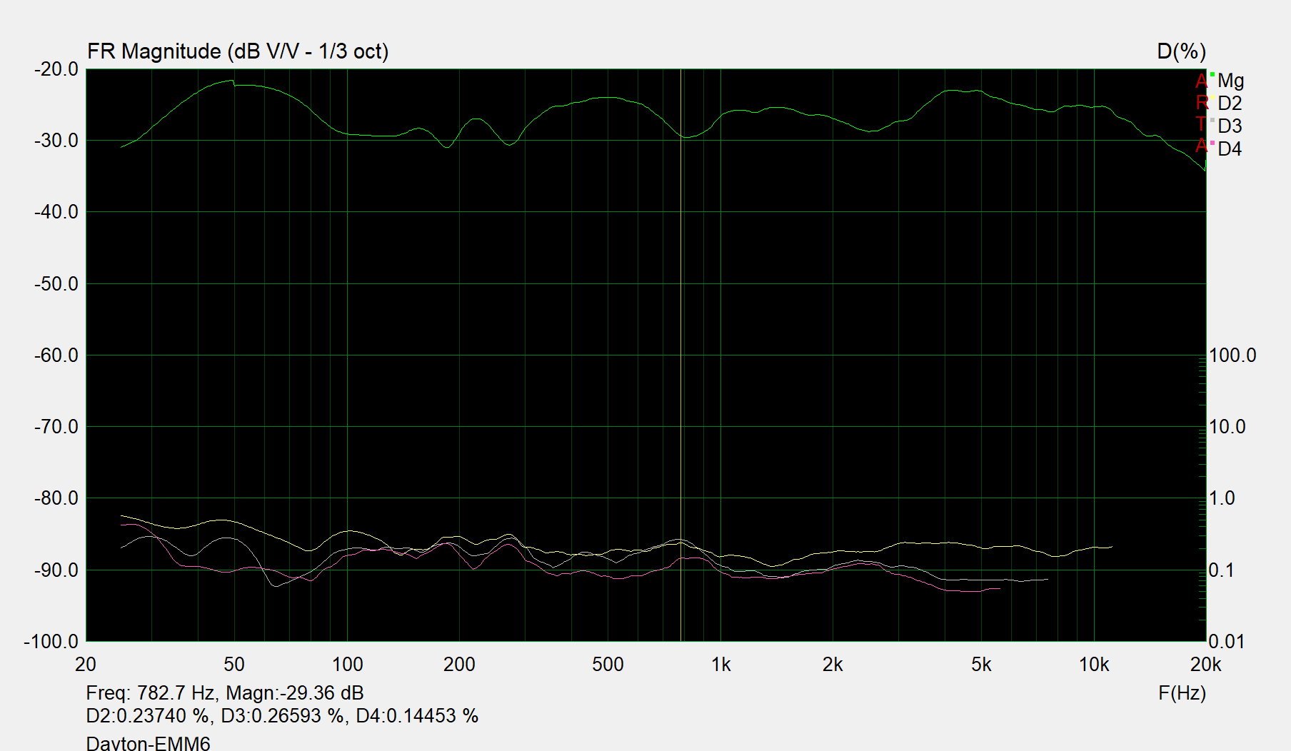

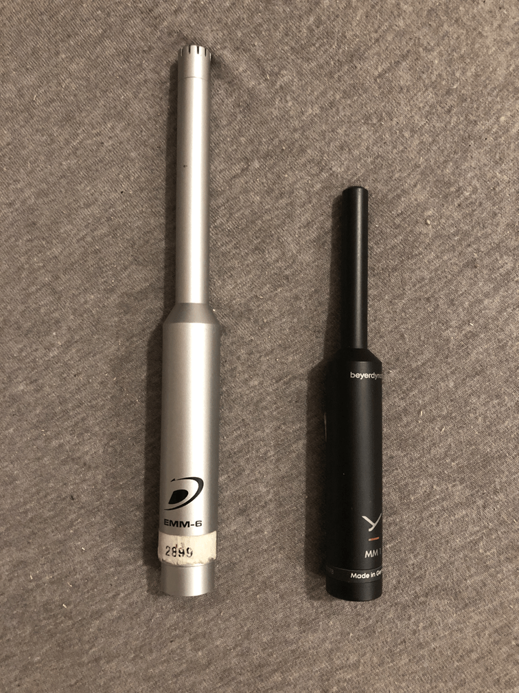

Not a very precise test, but it gives a glimpse about other popular Mics. The Dayton EMM-6 looks quite similar to mentioned above Behringer ECM-8000. A 4 way speaker system had been measured. Not many prepartions, with minimal covering of near by hard surfaces. Level about 90-91 dB. The results suggest sort of similar, like for behringer, rise of HD values by about 0.1% as compared to more quality Beyerdynamic MM1.

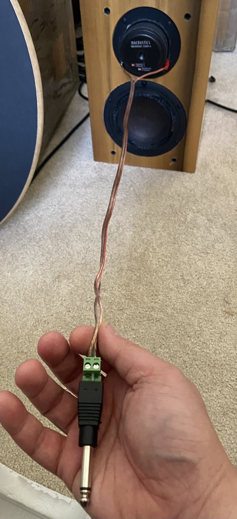

Have you considered using the RTA a reversed mounted driver method?
If anything ever goes go wrong, it’s a lot cheaper to replace a tweeter or midrange unit. Perhaps even lower than the cost of recalibrating a lab grade mic capsules…
And you can plug it into a standard audio interface. Save your G.R.A.S capsules for other work…

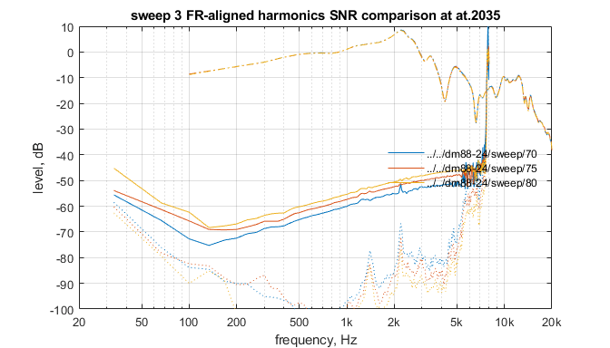

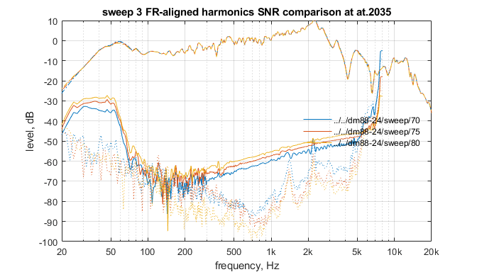

Of course, knowing your mic's SPL non-linearity limits is very important - but why do you limit yourself to 1/4" mic and stone-aged AP? You don't have to. I use a "measurement mic" only to calibrate 1" mic with 16x surface, and then I "do something .... with analyzing spectra". The results: 80dB dynamic range at 76dB SPL (70 at 1m) in a regular living room (dotted lines show the noise level).It's the Audio Precision stepped level sweep - there is no averaging or other stuff going on. The good thing is there are no calculation influences on the results. Downside - with some optimisations you could probably get a better S/N range. I wanted to be sure that at least the measurements we get are reliable.
You could try to do something similar with analysing spectra ... but that would be way more work as I spent here already. (cause you would need a lot of points to get a useful graph)
if I swap precision for resolution, I get a 100dB. I can learn about a driver that the designers had no idea of.
BTW, strictly speaking, AP does provide repeatable results, but these results are not measurements. Measurements must come as X+-Y, [say] 90% confidence interval. Just an X is not a measurement.

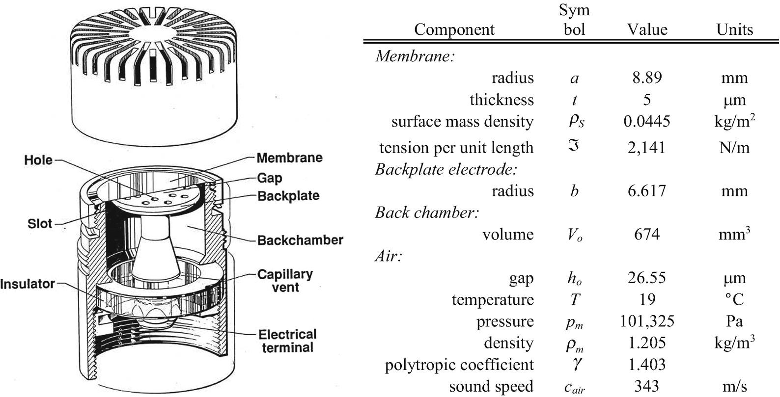

I just found a GREAT resource - the distance between the membrane and back electrode of a B&K 1/2" capsule is 19um! There is no stretching with that little movement of a 1/2" membrane!
https://doc.comsol.com/5.6/doc/com.comsol.help.models.aco.bk_4134_microphone/bk_4134_microphone.html
p.s.: I worked for AKG in the studio mic departmant many years ago ... don't worry, I know my mics. None of them got damaged, even the cheap electret capsule of the Behringer is fine after the torture. Don't do that over night but they are tougher as you might think. They need too cause a single slamming door is way harder as what I did here.
And a sketch of a 1" measurement capsule.
Distance is bigger here - 26,5um. It needs to be cause ... the membrane is less stiff and does more movement. To prevent sticking you need more distance.
You loose sensitivity with more distance - but you gain even more area, so overall sensitivity rises with bigger capsules.
Impedance converter design is WAY easier for bigger membranes cause they have a higher capacitance which means you can allow a lower input impedance of your electronics. These needs to be in the multible Giga Ohm area ... (yes, there are SMD resistors with 10G value.)

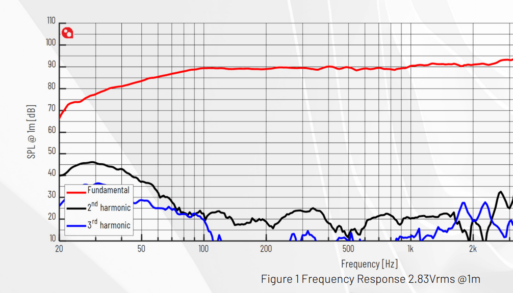

If one wants to measure distortion in the near field, the microphone used MUST be able to measure the required SPL without contributing significant distortion itself.
eg. To verify the H2 <-70dB and H3 <-80dB for 100Hz to 500Hz for a transducer that is fed 2.83V, as below:
How can a microphone measure distortion at < -70 or -80 dB, when it is observing some 116dB? *
Reference
* https://www.diyaudio.com/community/threads/measurement-mics.406766/post-7634814
This author's preliminary assessment shows that the microphone must be capable of 156dB (3% THD) if it to measure distortion of H2 of 0.03% and H3 of 0.01% for frequencies below Shroeder in the nearfield.

Each have their advantages and disadvantages. For most DIYers, the near field is undoubtedly the most convenient as it the only method that can be completed in the living/kitchen/hotel room (Monte Kay). 😱 There are a number of caveats to this- 1. one needs to perform compensation for the baffle diffraction loss and 2. measure sufficiently close (millimetres) from the cone to get an accurate frequency response.
Reference
