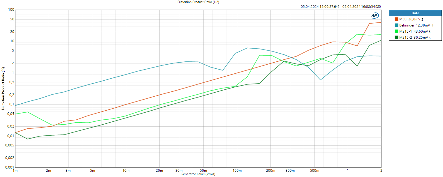

You used the values of the graph - but for e.g. H3 this is not THD, it's noise of the fixture! ONLY noise, it has nothing to do with H3. You need to calculate these values!
Microphone Measured H2/H3, courtesy @IamJF Brand Model 94dB 102dB 104dB Behringer ECM8000 0.09/0.01/0.009/0.006 0.24/0.004 0.27/0.008 MicW M215 (worse of 2 samples) 0.05/0.04/0.09 0.024/0.016 0.03/0.01 Earthworks M50 0.013/0.006 0.022/0.002 0.02/0.002 G.R.A.S. 40DB 0.28%^ 0.12%^ 0.08%^ ^limited by noise floor
e.g. M215 at 122dB -> about 0,1%. -> at 102dB 0,01%. 94dB about 0,004% That's for H2. (remember -20dB -> Factor 10. )
H3 of the Behringer mic falls down in a rate of -20dB -> factor 100! What seems to be right, higher harmonics go down way faster.
At 115dBSpl it has 0,05% - that would be 0,0005% at 95dBSpl. You wil never measure this - it's burried in the noise of the microphone! And any electronics adds probably more H3 to the result as that.
M215 - pretty hard cause there is only a small area where measurements seem serious. I would estimate 0,05% at 135dBSpl. 0,0005% at 115dBSpl. 0,000005% at 95dB Spl. Remember - THD produced by the microphone capsule.
H4 - the Behringer already has about 0,001% at 115dBSPL, M215 about 128dBSpl ... it's lower as what a speaker produces. Always.

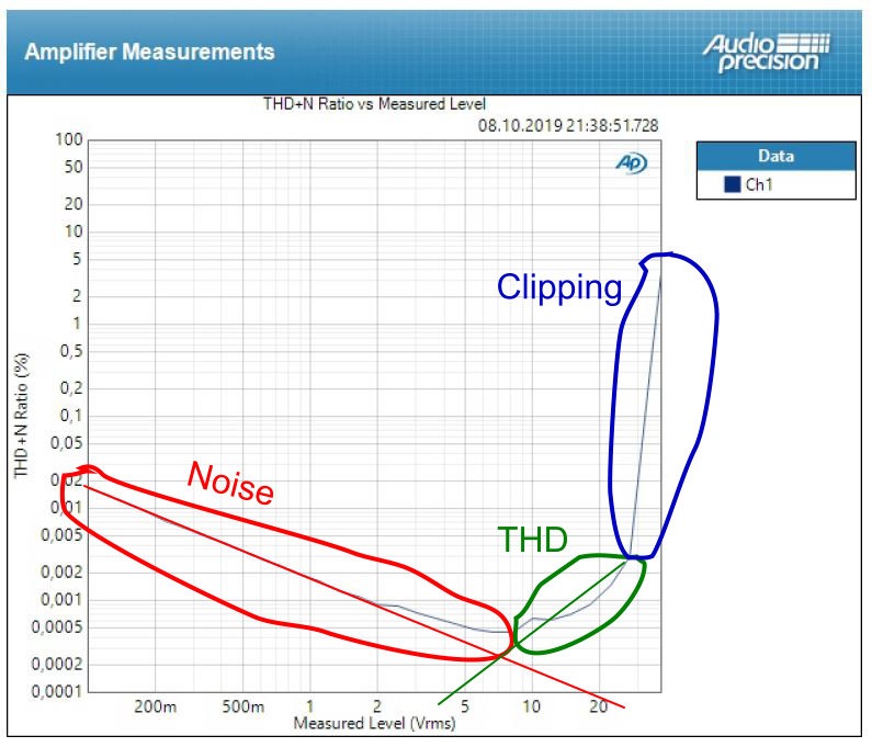

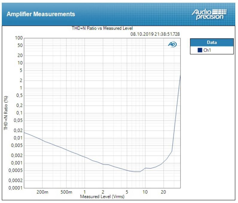

It seems there is some confusion about THD over level measurements - so I made some nice graphs.
Let's start with electronics cause it's easier to measure and maybe to understand.
At low levels - most circuits produce VERY little THD. They are linear. Small signal behaviour. But there is noise and when you try to measure harmonics you will find a signal - but it's not the actual harmonic, it's just noise at the same frequency.
When you do a % graph and have a fixed noise level - it get's less % of the signal level when you rise the signal. ....
In other words, when your noise level is fixed and signal level rises, you get higher S/N. It's shown in % instead of dB in this graph.
Here measurements of a Hypex power amp I modified - most of the graph is noise dominated.
At the right part you overdrive your circuit - it can't produce this high level, your rail voltage is not high enough. You run into clipping, THD jumps at that point. Don't do that with a speaker 🤓
And then there is a pretty small part with actual THD! This is a highly optimised circuit with a lot of feedback - there is little THD.
In the transition zone we have noise and THD mixed. I estimated noise with the red line and THD with the green line (roughly).
At 7Vrms we measure some noise and some THD. When you want to estimate THD at 5Vrms ... it's ABOUT 0,0001% - and it's masked from noise.

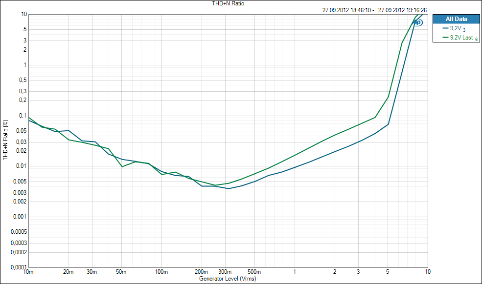

Here a graph from a FET input buffer with no voltage feedback. Less feedback - more THD. Noise on the left, THD in between, overdrive right.

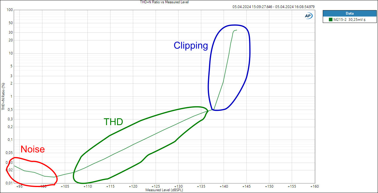

Back to our microphones - M215-2:
We only have valid THD data from 110dBSpl to 135dBSpl. The rest is noise or clipping from the preamp. But this data is reliable!
(as we had proven with our 1/4" mic measurement. This is important to do, otherwise you have no idea what you are measuring!)
Always check your data. Twice at least. Where is my noise floor. Is my result possible in theory? Is it similar to others measurements? What is the behaviour of my measurement devices? What influences the result - how can I minimise this influence? (e.g. the frequency response of the device when you measure THD/IMD over frequency! It needs to be linearised to be comparable.)
For most of you this is already clear but I hope it helped someone to understand these funny colourful lines in graphs like that better. 😉

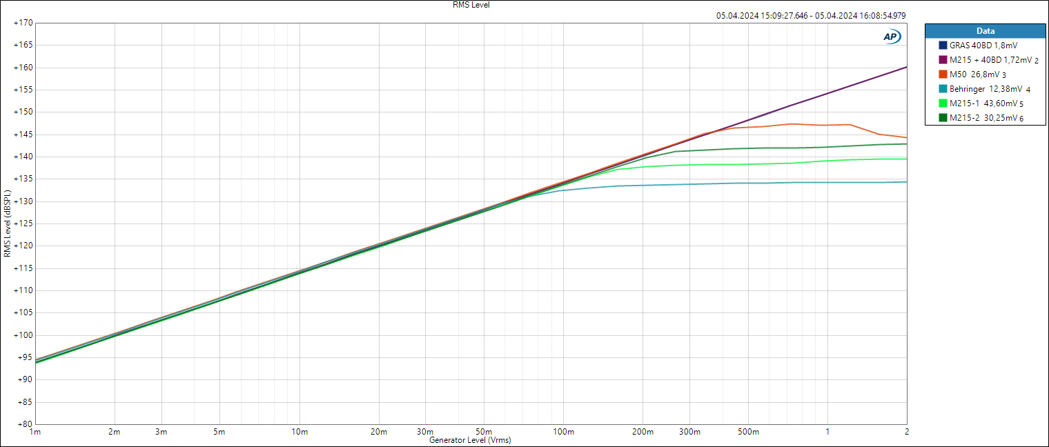

(5mV - 108dBSpl. 10mV 115dBSpl. 50mV 128dBSpl. 100mV 135dBSpl)
This is what I used to create the tables:
Eyeballing
1mV: 94dB
3mV: 104dB
10mV: 114dB
30mV: 124dB
100mV: 134dB
So are we not that different? (my reference 100mV -> 134dB)

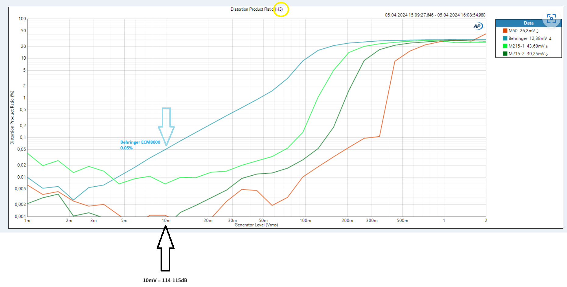

Then I looked at % H2 and H3:
eg. H2:
H3:
eg. 10mV ->114dB. Behringer H3 = 0.05%
If my numbers in the tables are incorrect by a couple of digits eg. 0.008% instead of 0.006% H3 @104 dB for ECM8000, I probably need to visit my optometrist. 🤣
But that was my process. Please advise.

Seems correct!1mV: 94dB
3mV: 104dB
10mV: 114dB
30mV: 124dB
100mV: 134dB
Also correct.eg. 10mV = 114dB. Behringer H3 = 0.05%
Just don't use measurement points where we measure noise instead of THD.
