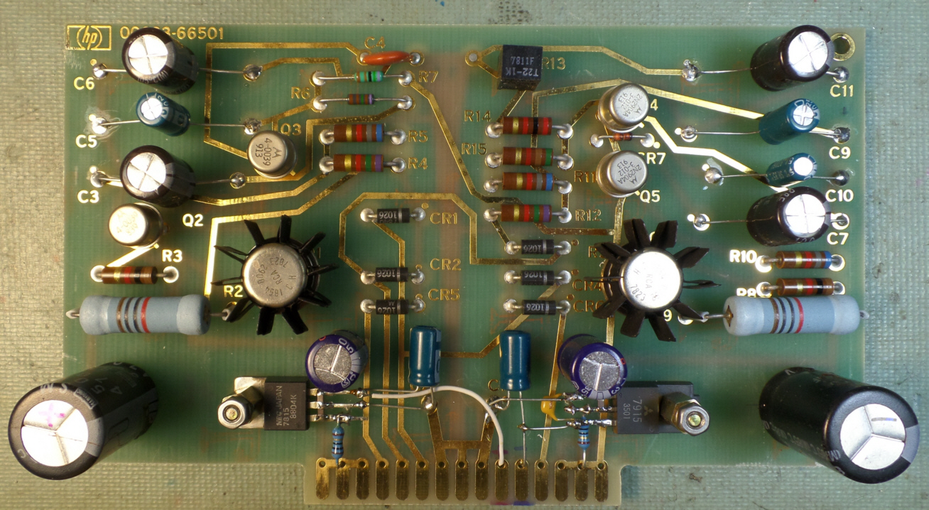

I'm talking about changing the power supply a little to reduce charging spikes. Add some resistance between the rectifiers and the capacitors. It will drop some voltage (good) and filter out the hash (also good) and greatly reduce the peak charging currents. The end result is that everything runs a little cooler.
I have some of those here as well. I haven't had a chance to try this on a THD analyzer, but the concept works on audio equipment.

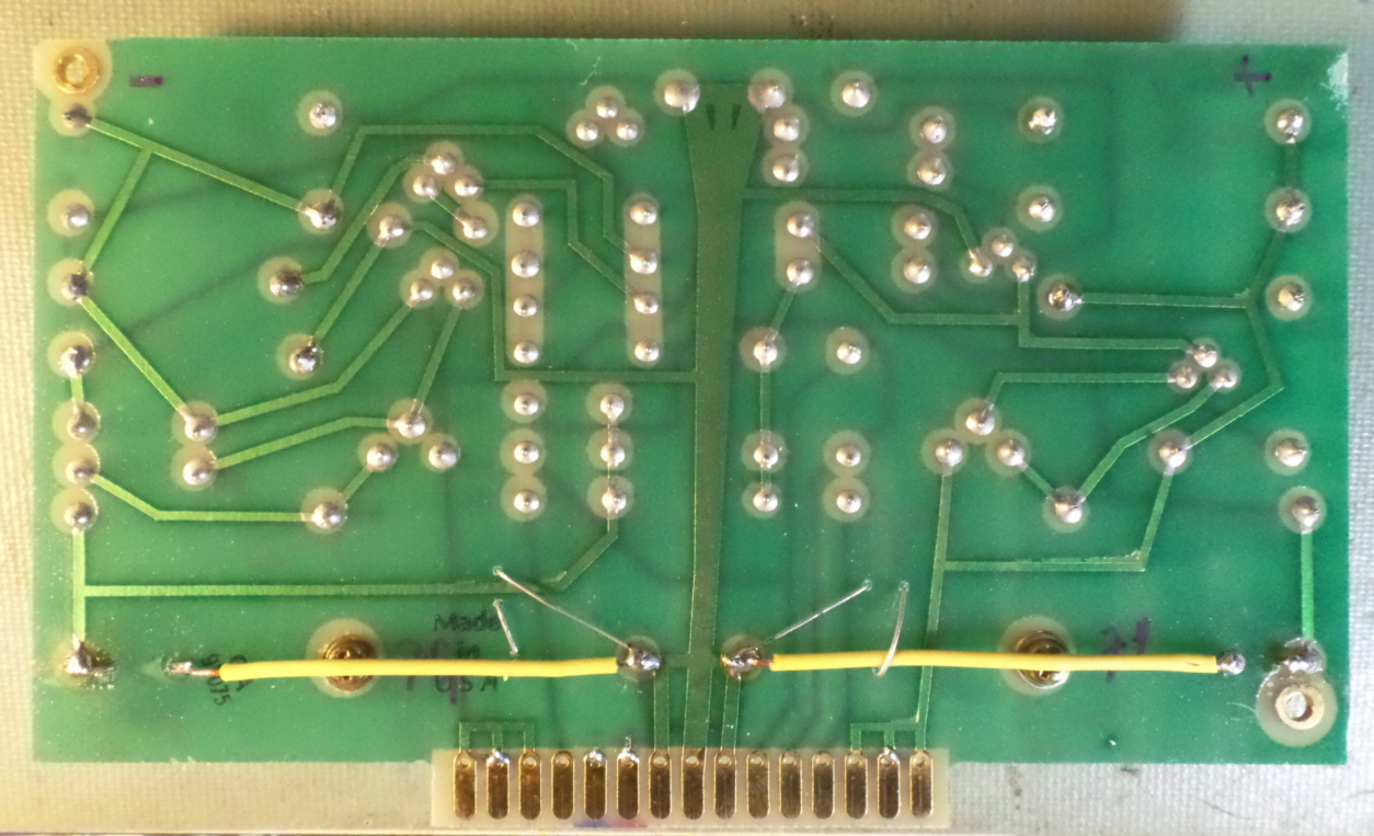

I would like to test with the external DC supply, but that means I have to get a bunch of batteries to make up the required 2x30V. I moded the A1 board by installing two 15V regulators for the eventual Op Amp mod, and I noticed the CR5 and CR6 diodes on the board, and you right they not connected to anything. If I would have the batteries I would install the DC connectors to the rear. The noise on the +-25 Rails are less then a mV now. The 200uF's on my A1 board was 500uF (now 470) and the bridging is already on the PCB.

Hi Miklos,
-Chris
Hi Chris,
I also used to do that in power amps, to dampen the top off conduction of the rectifiers. I will try to implement it here to.

Hi Miklos
I see that the PCB routing is much better that the schematic shows. The schematic lead me to suspect that charging currents could be a problem. You should add some insulation under leads from C5, C6 and C10. When I replace Axial Caps with Radial I lay them down and add some glue to them.

Hi Audio1Man,
Thanks. The result so far in #454, still looks bad, but I think (or hope) the bulk of the hum coming from my measurement setup. I do the gluing of the caps to, mostly with silicon rubber, but these ones are steady without the gluing.

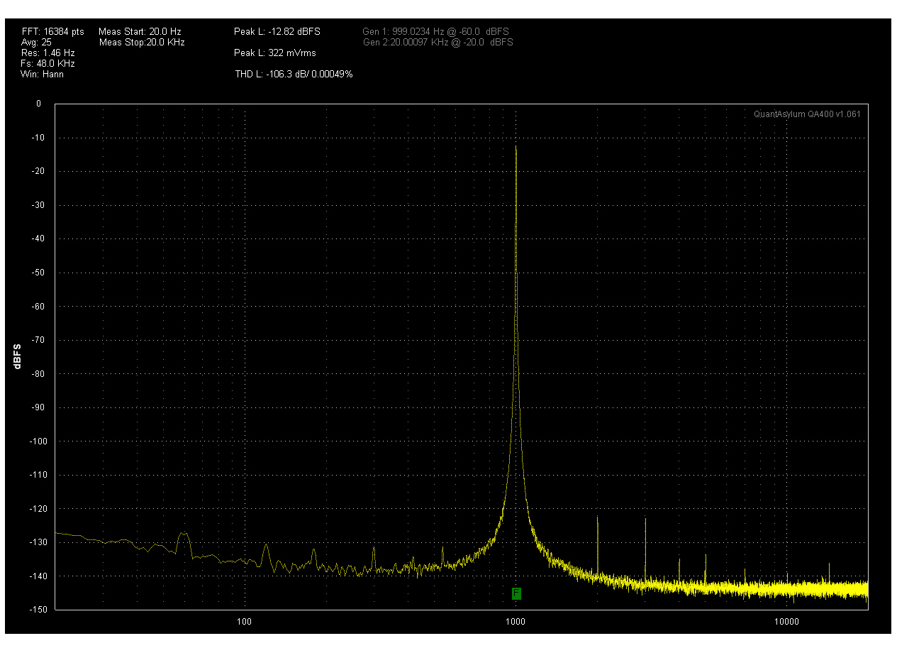

Hi Miklos
Good work. This look's about 20-25dB better. I think that some more improvement could be made. The COMMON TX lead and other common many be sharing the charging currents. I don't have the wiring diagram only the schematic. If you look @ both ps you can see some minor differences in each and this means you have some minor unbalance in the layout.

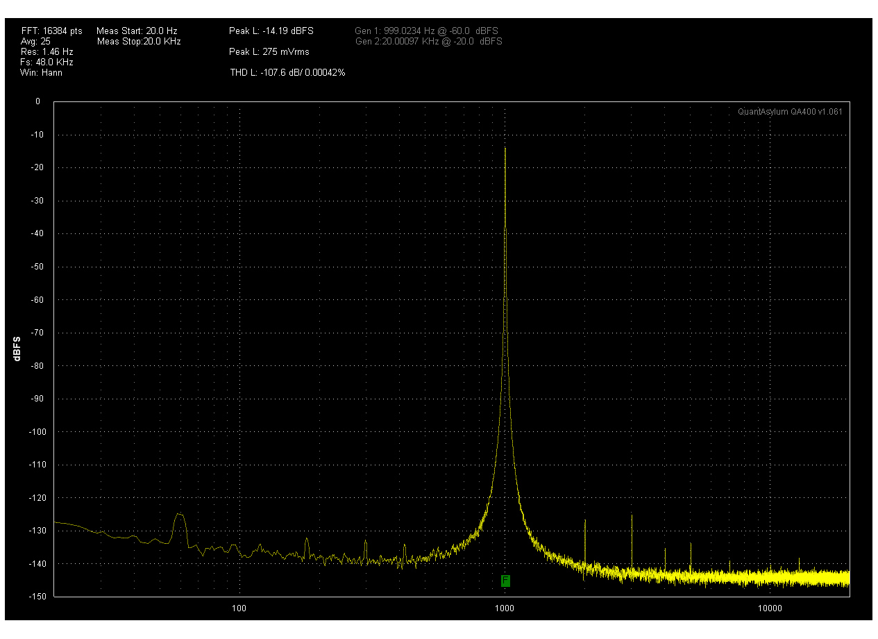

Retest.

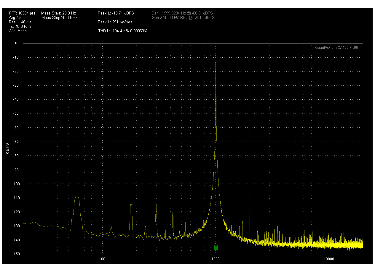

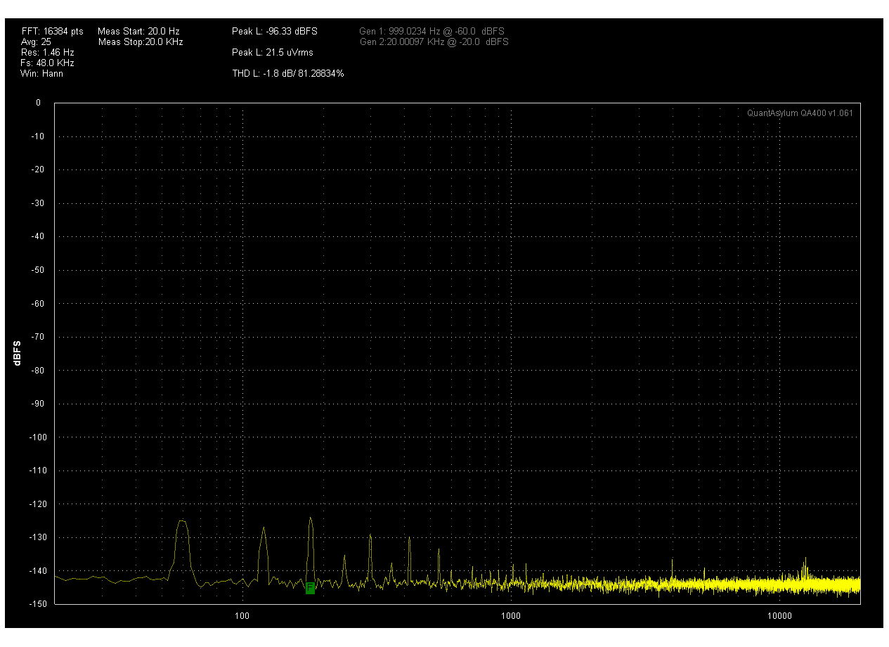

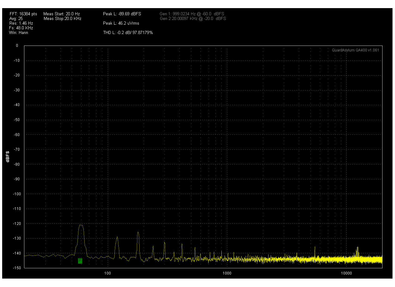

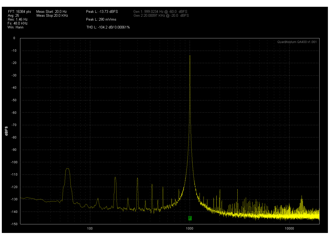

I made some new measurements, overall not much improvement on the output.
Also it looks like my Victor oscillator distortion is quite high for this work.
After the floating now the HP334a ,things improved a bit, I added the oscillator to, it is now floating on the same transformer, but on a different coil, so it's galvanically insulated from the 334a. That helped the impedance converter stage at C14, but not the rest of the unit. I tried to separate the outer and inner chassis ground, and tried to take the ground for the output from the input. Non of them helped. I can't make testing inside, since I had to put back the top cover. THD is to high after the Meter circuit in all three modes. The pictures from the left are:
Victors oscillator,
334a Noise at c14,
334a Noise at c14 - 334a on AC filter,
334a Noise at c14 - 334a on filter - Victor PS on insulated AC, and

Place your Victor oscillator into your QA directly. You are picking up noise from the 334a. Like 1Audio said above, you may be at the dead end of performance of the 334a. Victor's oscillator is way better than what the 334a can measure.
Using the 334a for the front end of a power amp in higher distortion may work because the amp will be noisier than the 334a. However, a simple passive resistive divider would work just the same or even better.

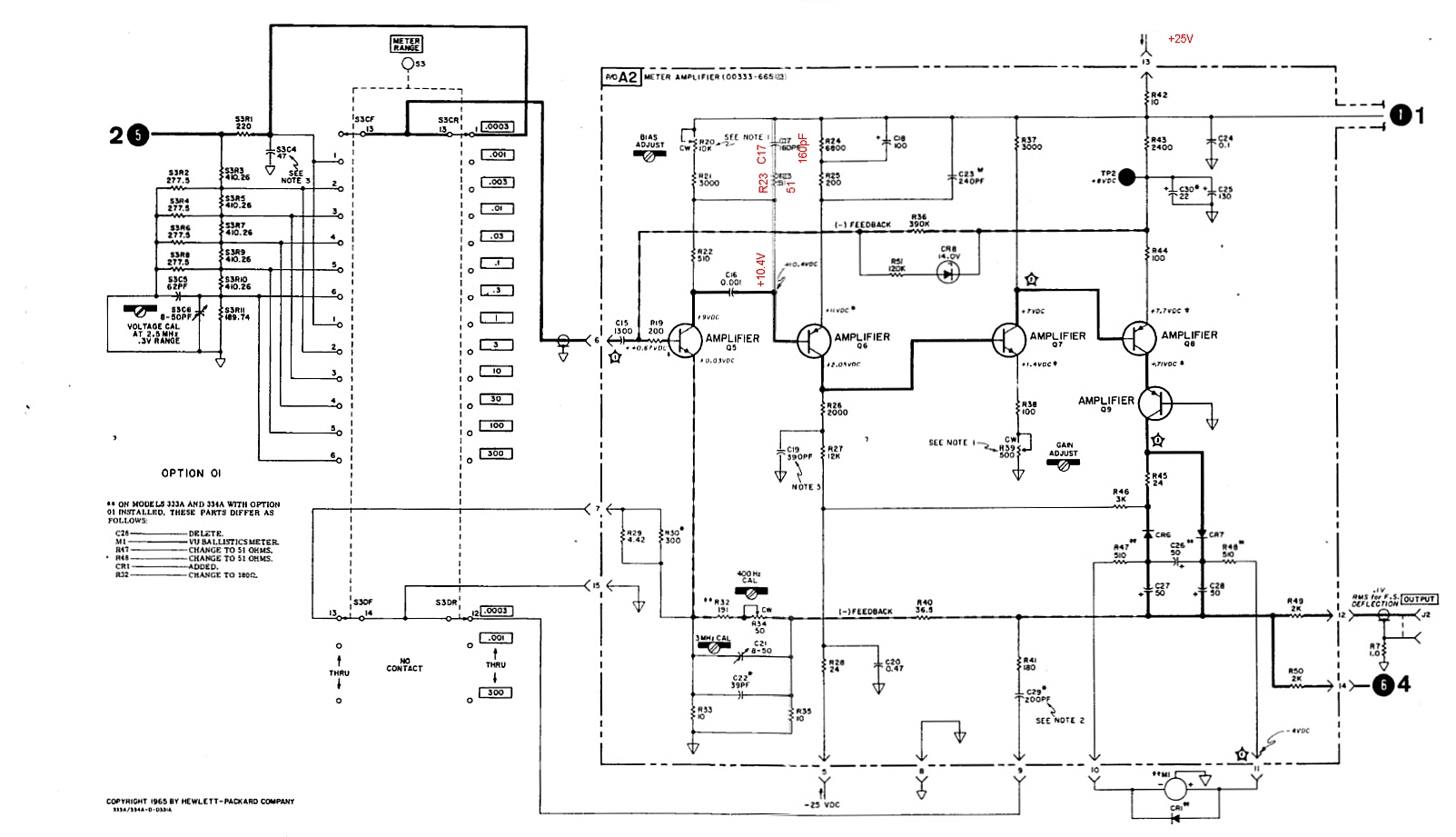

Meter amp.
This is the circuit I would like to improve on or replace. It has +40dB gain and a load of distortion. On the top off it the puzzle is the excess hum, which is not present in the impedance converter, but the attenuator takes off 40dB and the meter amp is the one which restore it, and in the Voltmeter function send it to the 334a output, where the QA400 would be.
Not surprised the noise is high from this amplifier. Any op amp will do better.
Hi miklos,
Can you pick off the signal before the meter amp and use that? This circuit was conceived to drive the meter, and not much thought would have gone into having a spectrum analyzer hanging on that output. I suspect that HP's spectrum and network analyzers would be used directly as they have far greater performance than the 334A
