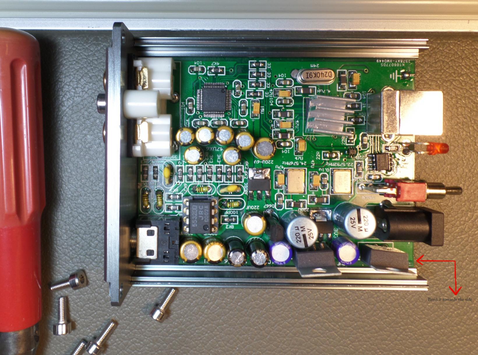

What is the model of the Breeze DAC? That you like and measured well?
What mods did you do to it?
Thanks,
Sync
Late to the party, I hope you don't mind.
This one:
XMOS U8 AK4490 Audio HIFI asynchronous USB decoder DAC with Headphone out +PSU
You can read more about here: #510 and here #512
1Audio recommended a 12V supply with it.
I bent the first 5V reg. close to the power connector ,towards the side wall.
Dremelled out a ridge in the top cover, and used heat compound on it.
Changed the 5532 to an LM4562 (not necessary).
That's it. 🙂
