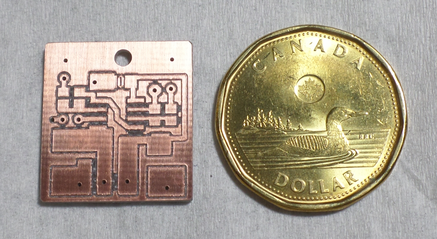

The output Miklos is grabbing on C14 of the impedance converter is in between the two part attenuator. I'm wondering if he could grab it on C15 of the A2 board after the second part of the attenuator...then try 1 Audio1Man says with a op amp buffer.

I was thinking to do just that, and use an OPAMP for the output. I believe the Meter amp is in the circuit for the distortion analyzer to, not just for the meter.

Thanks, I was planing to go for that C15 to.

Hi Duke,
I will make the measurements. I was thinking for now to keep the impedance converter, add a 40dB buffer after the C15. Made a small SM board, maybe it would fit under the A2 PCB. The space there is ca. 4mm.

Here's the result of the measurements.
The range sw. first section (front of the Impedace converter) only have two settings, 0dB and -60dB. Going to -60dB after the 7th step.
From 0.0003 to 0.3V it's 0dB and for 1 to 300V is -60dB the attenuation.
The range sw. second section, which is sitting in between the output of the Impedance Converter's C14 and the input of the Meter amp's C15 has seven steps from 0.0003 to 0.3V and after that from 1 to 300V resets to the 0.001V step and going through the steps again to reach 0.3/300V point. So the Impedance converter input never sees more than 0.3V (0.316) and at the input of the Meter amp the max voltage at full deflection is 1mV ,and the output is 100mV.

You are sort of right, but the level at the Meter amp input is only 1mV, and if I want to use the opamp circuit instead of the distorting Meter amp for the output, I have to use the Meter amp input for the source.

If you have to amplify 60dB you will have to do it in several stages to maintain the bandwidth.
At this point I would calculate or even better measure the noise at the output of the stepped attenuator.
You could end up with the same as what you have now.

I don't have a clue how to measure noise on a 1mV signal, I guess my QA400 wouldn't tell me enough. Maybe the 600kHz bandwidth is not needed , do you think two stages would be enough for ca. 100kHz bandwidth?

Hi Miklos,
100 KHz is barely enough. Normally you want at least 10X the highest frequency you are going to measure. With the extra bandwidth, this THD meter will let you know if something is oscillating ultrasonically.
So, if you must, 100 KHz is enough. Many products on the market for audio have ceilings of 100 KHz. If by chance you can extend that, do so.
-Chris

I would go for the lower bandwidth because the simpler amp it would need for the +60dB gain ,and leave the oscillation detection to the scope.

It depends on the op amps use. That what the GBP figure of merit is on the data sheet is for.
Divide this figure by the gain of the amplifier and it give a estimate of bandwidth. It's just an estimate because not all specimens of the op amp will be the same. Even if the data sheet claims they are.
As Chris pointed out try to keep the bandwidth of the 334A.
You might need three 20dB stages to obtain this. Equalization may be necessary to keep the band pass flat. There is a lot of this in the existing meter amp.
The Shibasoku 725D has a 1 db rise above 100kHz all the say out to 500kHz. This is acceptably because that's what the 725 is spec'd for. Accurate to one decibel.

Remember the target indicator of the 330-334 family is an analog meter with a 20 dB max dynamic range. Tying it to an FFT with 100+ dB range will highlight the 80 db below the normal minimum it was designed for.
1 mV full scale will probably not work out well as a minimum sensitivity.

Hi David,
Thanks for the advise. I will try to make a two stages amp, since I have the board for it. If it turns out promising, I will make a tree stages one.
