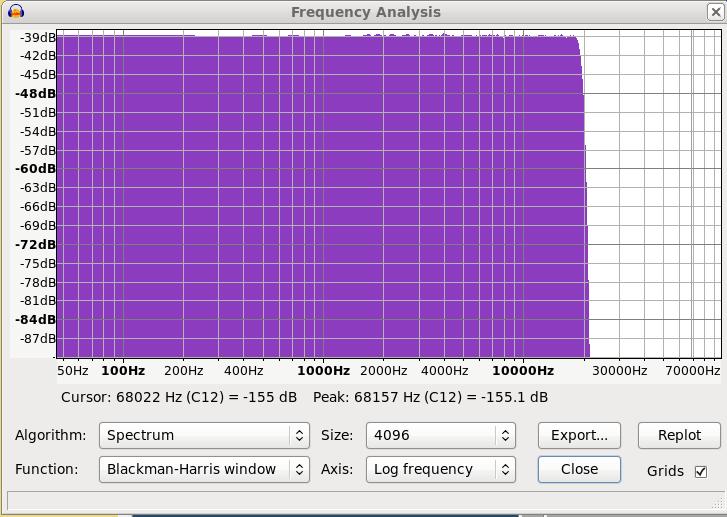

I am trying to use an Audiophile 192 (AP192) in a software spectrum analyser using the Cordell Distortion Magnifier. The problem I observe is that the AP192 ADC and DAC anti-aliasing filters appear to always kick in at around 20 KHz at ALL sample rates. Attached is the power spectrum for loopback of white noise.
I would really like to run the AP192 at a 192 KHz sample rate, with anti-aliasing filters at around 96 KHz. Is there any way to control the cut-off frequency of the AP192 anti-aliasing filters? Perhaps this is a limitation of the AP192 Linux sound card driver.
My configuration is:
AMD Athlon dual-core X86-64 5600+
4 GB RAM
Fedora 14 Linux
running Audacity and other sound software
M-Audio Audiophile 192
