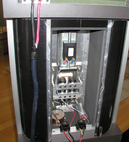

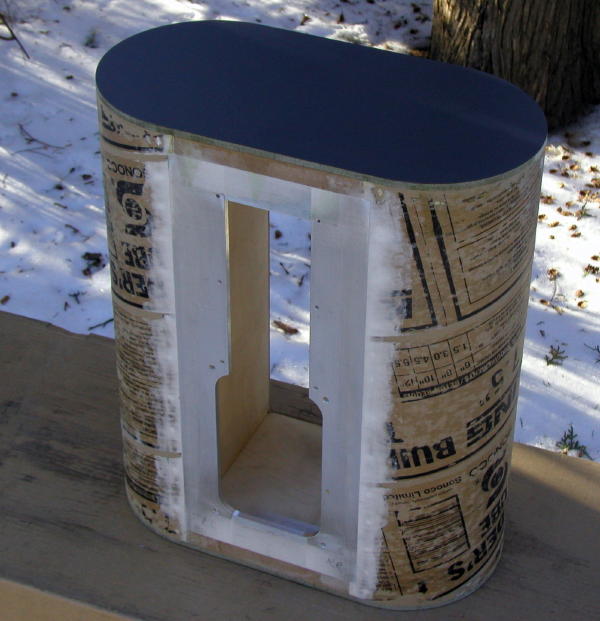

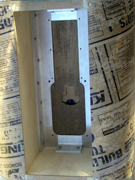

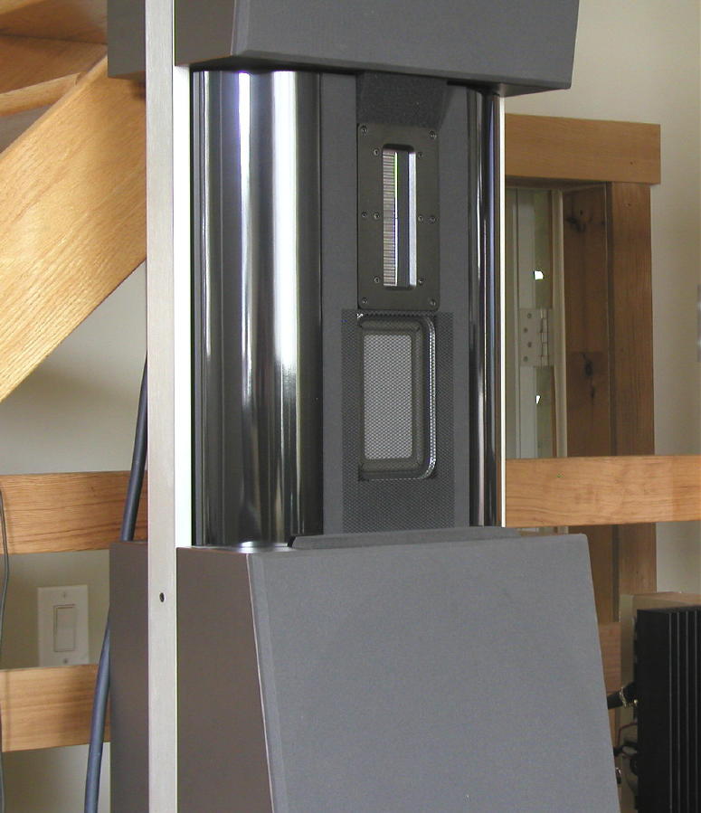

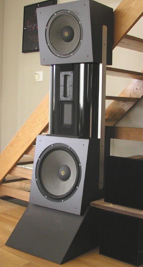

In my most recent speakers I used sonotube, plywood and 1/4" aluminum angles. Those pieces allowed me not to use conventional baffle for TM section:

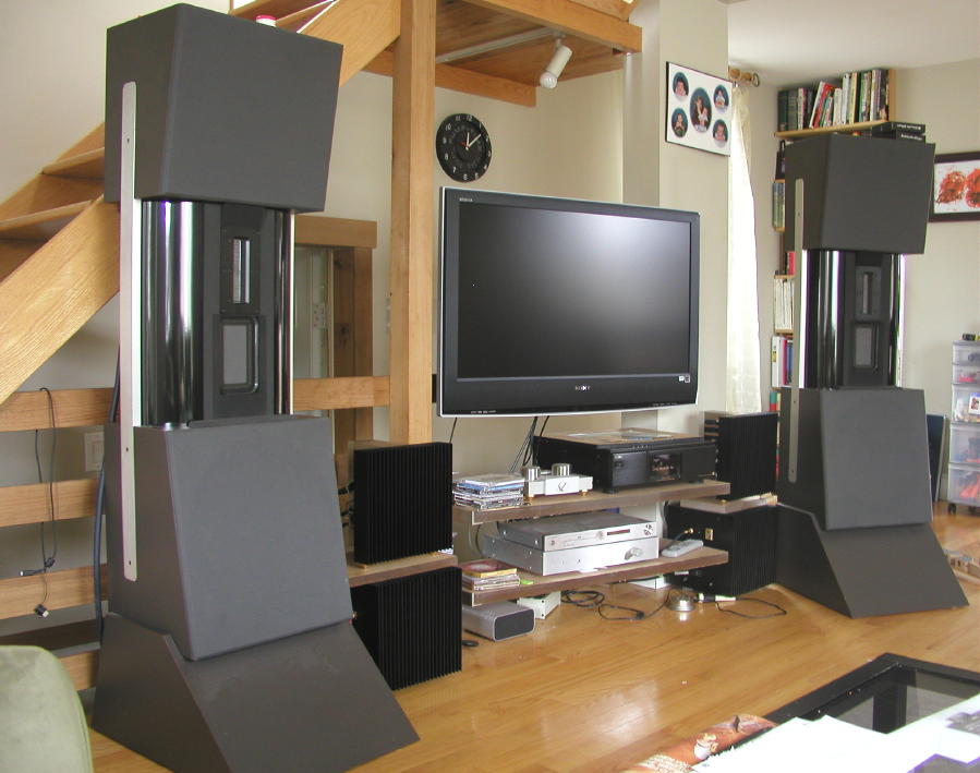

The complete speaker also contains two woofers (12 and 15" Focal Audioms) in folded baffle setup. The boxes are made of dual layer 3/4" MDF, plastic laminate on the outside. Both sections are attached together with 0.75 x 1.5" aluminum bars. Bottom stand is also filled with sand. The whole thing is modular and easy to transport.
