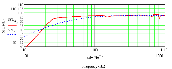

Ed -are we talking about the Dayton RS180 or RS180S here?
Assuming the former, then with the drivers paralleled, so Sd & Vas double, and impedence (Re & Le) halves then I get this, from an MLTL: 48in x 7.5in x 12in (Internal HxWxD), Zdriver between the two units 10.25in, 3in diameter, 6in long vent, 0.25lbs ft^3 stuffing in the first 28in of the line. Admittedly this doesn't take what occurs with the XO into account, but from a mechanical standpoint it should still be happy enough. In-room, it'll be a bit over-powerful in the LF to be honest -could do with rolling off some more as room-gain is going to boost it a fair bit. Damping the bottom of the cabinet should sort that as we'll get closer to an aperiodic alignment. Either that or shifting to a classic negative taper TL alignment.

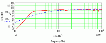

Scott,
Yes, the Dayton RS180. I plan to use Jon Marsh's Modula x-over and baffle lay-out. My response is in anticipation of room gain. I've fiddled at length with the parameters and found what I think to be a "sweet spot". It yields a response above ~150 Hz that is +/- 1 dB of the infinite baffle response. Using only 0.15 lb/cf in the upper ~third. Glad to share if you wish....though mostly concerned with energy storage issues here...and recognize I may have some with panels 14" wide.

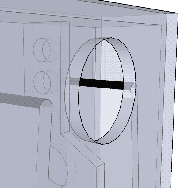

I'd run a single holey brace most the length of the box with attachment just off-centre of the largest panels. Maybe a bit more then just off centre, since that take you uncomforatbly close to having 6 panels the same width... maybe move it to a 4th root of 2 ration?
Then i'd add at least a vestigial holey brace from the driver cutout to the cross-brace.
As an ML-TL it shouuld be fairly tolerant of a little volume loss (you dsaid you had the pieces cut.
An unbraced 14" panel is pretty significant size, i don't think dowls are going to do much.
dave

BB will make a better brace than MDF. The point with the vestigial brace for the driver, isn't with bracing the baffle, but creating a situation where the only thing attaching the driver to the structure is not the bezel. ie it is a brace -- support for the back of the driver.
dave

Dave,
The thought I've put into the vestigial brace leaves me challenged:
Fewer pieces would be ideal...as in just one. I think the time spent in fit-up for just one piece gets into trying even my patience...so I think I'll do it in 2: one that is fit to the drivers mounted in the baffle and one that extends from the back of the case. I'll overlap them, glue and screw them together.

That works... i'm just used to Chris' drive to get things just so... when he is out with one of these, a single piece of paper (sometimes folded) is all that is needed to get that tight fit (and often thats my fault for using a thicker than expected gasket)
dave

Ed Lafontaine said:
gasket?
Are you referring to that between the driver and recess? Or the back of the driver and support? Or both?
Both are referenced... if i use too fat a gasket on the front back of the front bezel when i mount the driver, a "spacer" needs to be added to make sure that the magnet firmly butts up againt the brace... usually it is within a couple paper thicknesses.

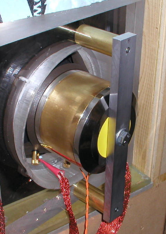

Hi Dave,
I'm not sure how it relates to your particular bracing, but I tried to use a support bracket with Fertins and it didn't work well.
I was a bit dissapointed as I thought that would be an improvement, but it wasn't; it sounds better without magnet supported in a back. The baffle is made out of 3" acrylic and mounted inside a stud wall with cavities filled with sand.
