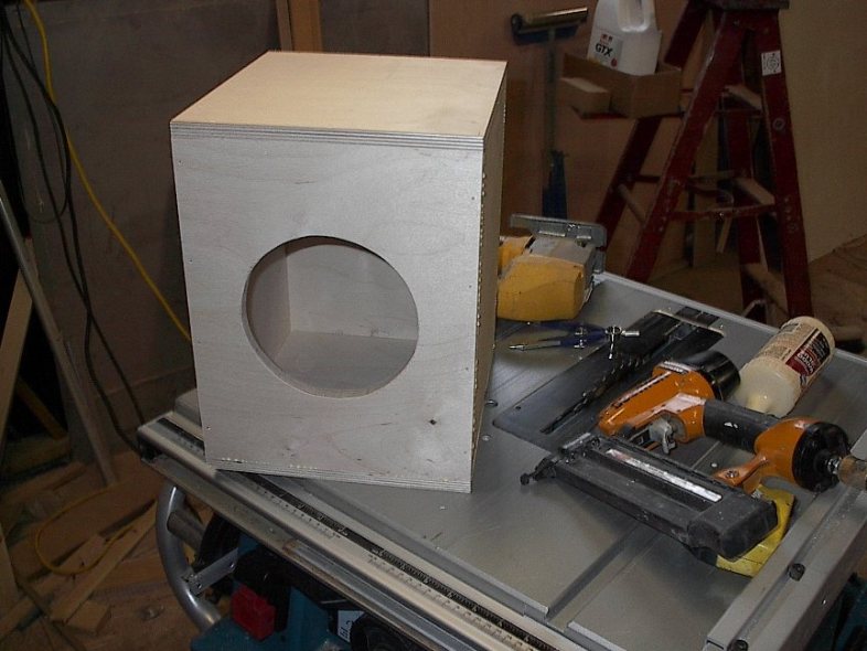

$26.10 is what I paid. 9 ply baltic birch plywood.
I have just came in from my shop where I was playing with it. I have built the first enclosure for the resonance test, and had enough left over to start a small pair to replace my rear surrounds.
I will admit it's more pleasant to work with than MDF, dust is sweeter.😉
Here's a pic of the first box:
