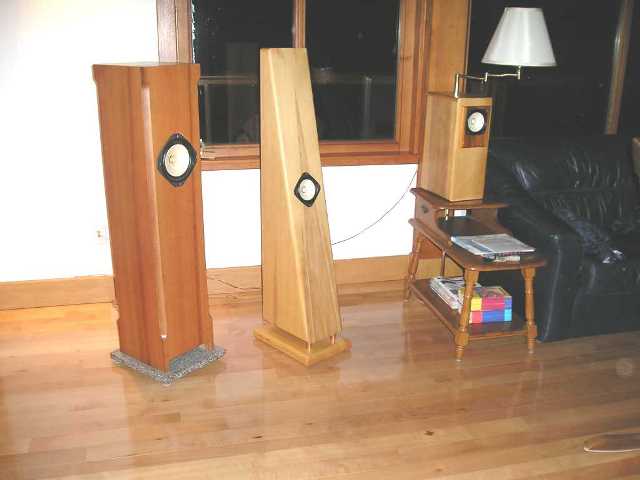

building with real wood
Good morning folks:
I am the fellow that makes speakers from real wood. I am currently making my cabinets from fine grain first growth Douglas-fir. The wood is well dried and stable I have had it stored in my house for approximately ten years.My house is stable year round at aproximatwely 38% humidity. The wood grain is extremely uniform with greater than 25 growth rings to the inch.The wood has uniform density and is more stable than any other material I have used. I use planks upto 12 inches wide with no concerns. 12 inches because that is the maximum feed width of my thickness planner. I have laminated up planks to wider widths for other projects with no troubles.
What is the deal you ask?
I use only clear wood.
I use straight grained wood.
I use stable dry wood
I take the time to do proper joinery
I seal the wood with oils inside and out
I finish with simple poly eurathane finishes.
I have not had any major suprises.
I really like the things I can do with real wood.
If I had to choose I would use Baltic Birch. I am not wood scientist or a physics dude. But I think the modulus of elasticity on sideways stabilty of plywood exceeds that of MDF. If you take a piece of ply wood and a piece of MDF and bend them sideways the MDF has great flexibilty, the cross link nature of plywood leads to less flexibilty. Hence larger panels do not resonate. I do not know for sure. I did pick out the MDF from the plywood in the taste test last summer in the sense that the MDF sounded more bright.
Anyway... I prefer to make things from real materials when ever I get the choice. Right now I am using stone wood and metal. I try not to be too positional but I think that when you spend the time to make something you should not be too caught up in how long it takes or how much work it is. Most of the things I make will last for a very long time and continue to look and perform to the standard I expect.
On a final note If all goes astray and things do not work out. I have solice in the knowlege that no matter what, it will burn and heat my house for me.
One more thought
You have to go with what you know. If this is a first project or an experiment go with cheap material for the prototype. Once you are happy with the design and performance make furniture if you have the skills and the tools.
Most of all spend you time making things that is really what it is all about.
