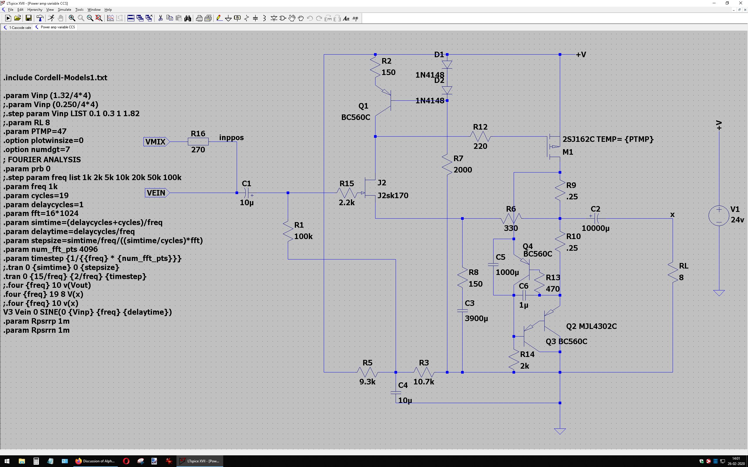

A very clever and qualified person however, backed up by an accurate sim, told me that the Nirvana amp has a class A output stage working in push pull (post #386).
Other qualified members here, Kokoriantz (post #14) and Bigun, also see the output stage as being push pull.
Even Hugh (post #19) mentions the design SEPP, which means push pull output stage.

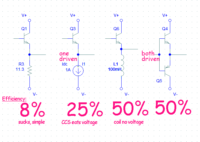

...With active components the maximum efficiency in class A is 25%; with inductive load the maximum is 50%......
No. At best incompletely stated.
In terms of Power Transfer we have the four forms in the attachment. "25%" is the un-traditional form with a CCS (not a true current source) DC feed. While it has been around here and there forever, I first saw it in a Dan Mayer headphone amp. It took me a while to see why it is "rarely" used for loudspeakers. (And when fashion and opinion edged good circuit design, it did appear in several loudspeaker amps.)
I never know what "single ended" is supposed to mean. One hand clapping? ALL audio amps are "push-pull", though we tend to reserve that term for two active elements, don't count resistors or coils as the "pull" they are. Sometimes just "no transformer". In today's audio-world it may mean "has some sonic aspect of one hand clapping". This Nirvana could be seen as single ended at every stage. However the last two "SE" stages form an Ouroboros ring. Clever. SE? PP? Too deep for me.

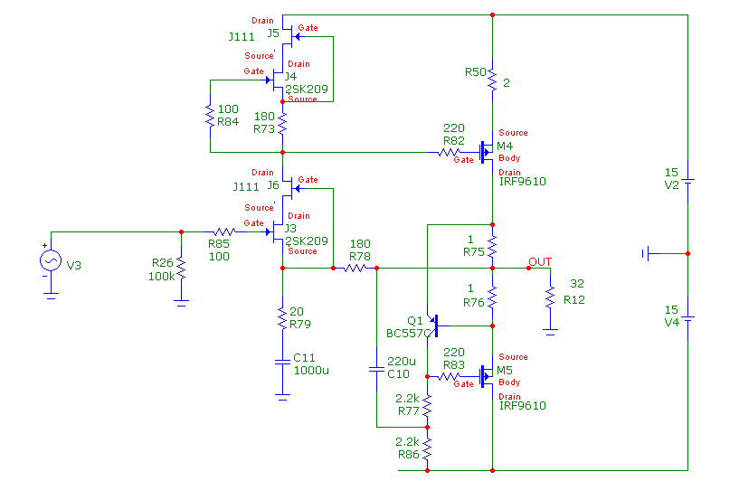

Finally a picture of his sim, clearly demonstrating the OPS to be push pull.
Is this SE or PP?
What happens if we omit Q4 and associated components completely?
Ignore the performance, I know it's very poor but the circuit has moved on since I did this.
If we remove Q4, then:
1. At pos half cycle, upper device controls voltage AND current into the load, and
2. At neg half cycle, lower device(s) controls voltage AND current into load.
In this sense, two devices are constrained to their respective half cycle and both voltage and current, this is PUSH PULL. If set up in AB or B, inactive devices will turn off completely. In Class A, inactive devices will never turn off. Devices turning off is a significant issue for creating harmonic artefacts and regarded as essential to be defined as a Class A amplifier.
With Q4 in place (that is, set up as an active current flip-flop across the two output device currents), then:
3. At pos half cycle, upper device controls voltage AND current into the load, and
4. At neg half cycle, upper device controls voltage BUT NOT current into the load, this load current is directed by the lower device alone, which never turns off and never controls voltage (signal).
From this odd combination of different control of the signal with two outputs, we can see that the upper device is the sole device controlling voltage through the entire waveform. This MUST happens only if all devices DO NOT TURN OFF. The upper 'voltage defining' device does not control current in the negative half cycle, however; this is passed to the lower device, but this lower device does NOT turn off. Neither does the lower device EVER control voltage at the load at any point of the waveform.
Because the total control of the voltage at the load is devolved to the upper device, in this sense this is regarded as single ended control, as though only one device were controlling the entire waveform. This is almost a semantic difference, but it is significance, because at the entire negative half cycle, the lower device controls load current. It is true this control is tightly controlled by the constant on upper device which forces voltage control at all times, but it can be viewed as Single Ended.
The correct term, however, attributes more correct reality with the phrase, SINGLE ENDED PUSH PULL.
This is very interesting mind puzzle because with very simple circuits we can run into serious difficulties describing precisely what is happening, particularly were we are using terms from the past which are morphing into the future.

My bad - I should have been clearer that the removal of Q4 would result in no standing current at all. Some more components have to be added to make the amplifier operate.
As the CCS (the lower half of the circuit) is moved from fully fixed (by replacing Q4 and the R9-R10 tail with Vref and appropriate current control resistor) to fully variable, the operation of the circuit changes from a pure SE to a pure push pull - even if the lower transistor is not driven directly by the input/VAS stage.
Therefore it's a SE amp, operated in PP. Sometimes both answers are correct.
