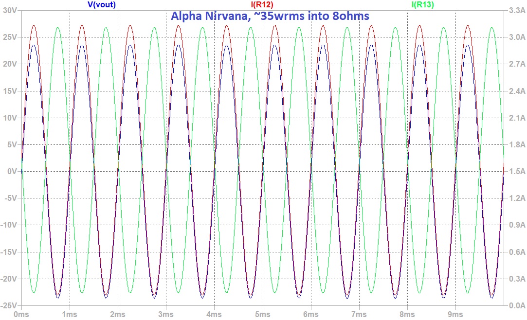

Where did you get this 12w value before this amp goes into Class AB - where is your simulation or did you build it and measure it? You make these statements to discredit this design, yet the proof in the simulation is quite obvious. I could even measure it with an O-scope and it will be the same. This amp is measuring very close to all predicted perfomance parameters and setpoints including quiscent bias current, 0v DC offset with no adjustments, 2.6mA LTP bias current, % thermal efficiency, clip point, etc...
Here is the LTSpice sim running at 35w (well above 12w). The plot shows the usual output voltage as a function of time, plus the currents passing through the two Source resistors R12 and R13. The currents through these resistors is the same as the current passing through the MOSFETs. Note that the currents never dip below zero - the definition of Class A. As we can all see, the currents see-saw about the quiescent bias current of 1.7A, never dipping below zero, hence the MOSFETs never shut-off. True Class A operation until the stated clip level.
Schematic from Post 1 corresponding to this simulation:
791336d1572501676-alpha-nirvana-39w-8ohm-class-amp-alpha-nirvana-schematic-v2-jpg
Predicted source resistor currents on MOSFETs near clipping:

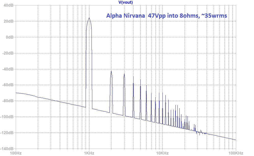

Here is the predicted FFT at 35wrms (47Vpp) into 8ohms. I haven't gotten around to making the FFT measurements yet:
Here are the distortion components and THD at 0.06% - not too bad. Still monotonically descending higher orders, lots of higher orders but odd orders are not higher than even orders as you predicted would happen on a Class AB-like topology:

Total Harmonic Distortion: 0.060833%(0.060850%)

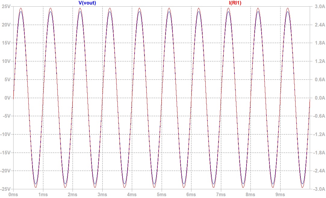

Your math assumes a certain type of standard amp. Look at the LTspice sims - are they wrong?
Here, the current never drops below 150mA (axis on right). The sim is going to be more comprehensive than your back of the envelope calcs based on assumption of a certain type of amp. The CCS here is reactive (sort of like an inductor load would be) and there are bootstrap caps. Only the top MOSFET is driven by an audio signal from the VAS - hence SE Class A.
798017d1574870073-alpha-nirvana-39w-8ohm-class-amp-alpha-nirvana-ltspice-clipping-class-currents-jpg
There are plenty of SE Class A amps in the Pass forum with 24v rails and 1.25A bias current that achieve 25w.
The simulation for the 35w case shows above where the current never switches off (Class A) is 47Vpp or 16.6Vrms. Power is V^2/R or 16.6^2/8=35w. So there’s my math.
Your back of the envelope calcs neglect the fact that the reactive CCS produces a current that is 180deg out of phase with the top MOSFET, neither current ever dips below zero, but they combine out of phase to produce a peak current at the load that is about double the peak current in any one of the Source resistors - sort of like what happens on BTL amps. Here is the predicted current at the load resistor about 6App or or 2.12Arms, Power = I^2 x R or 2.12^2 x 8 = ~36wrms.
Here is the plot of the current at the load (RL1):
attachment.php
Using a rule of thumb for a certain generalized output topology can yield incorrect results. The LTSpice sim accounts for the actual topology used.
