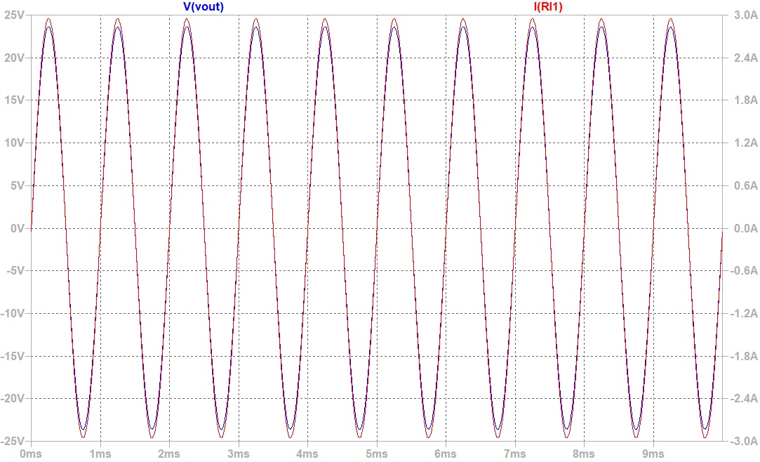

I don't see much more than 3.4A pk-pk for Nirvana amp; maybe a bit more with bootstrapping, but 6A pk-pk??
As I explained earlier, the two output transistors each flow 3A but out of phase and in opposition to generate a net 6amp at the load.
Look at the plots of the currents in R12 and R13 (3A ea and 180 deg out of phase), then look at current vs time in load resistor RL1. It is 6A peak to peak.
Currents in R12/13:
798017d1574870073-alpha-nirvana-39w-8ohm-class-amp-alpha-nirvana-ltspice-clipping-class-currents-jpg
The difference in currents at summing junction (output node) results in current through RL1 of 6A:
798033d1574877159-alpha-nirvana-39w-8ohm-class-amp-alpha-nirvana-ltspice-clipping-class-currents-load-jpg

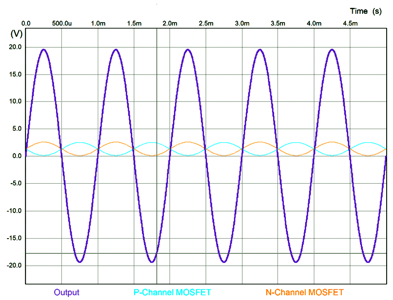

Finally a picture of his sim, clearly demonstrating the OPS to be push pull.
The CCS of Alpha Nirvana is driven not by the VAS but by Q4 which senses the current across the sense Source resistors. The VAS drives only the top N channel. Hugh did call it SE Push Pull. A subset of SE (where only one of the outputs is actively driven by the VAS). It is similar to Mr Pass’ Aleph. Perhaps you might like to read the patent which states that it is a SE Class A. The innovation being that although being SE Class A, it exhibits efficiency of a push pull.

But even I clearly see that the VAS also drives the PNP channel through C8 and R17.
Happy "single ended" dreaming!!
The patent you show is single ended with an active CCS, which can be compared with a (reactive) inductive load to double efficiency.
It is different from Nirvana, which is clearly push pull, period.

Perhaps if your friend examines his simulation more closely, he will see that it works (at lower levels) even without C8, although the current source doesn't work quite so well. As has been explained previously, C8 and C4 are bootstrap capacitors. These provide a reasonably constant current through Q3 and Q4 and allow the gates of M1 and M2 to swing past the rail voltage, avoiding the need for higher bipolar PS voltages at the input/VAS stage
