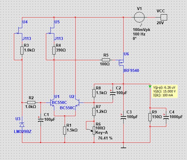

Anyways, with that unneeded bs out of the way, the idea was to just show how Lineup's design performs. If you haven't figured it out yet, I was playing around with the design to see what happens, as you can see by the slightly different circuits in the screenshots sent.

If you add a startup Zener to the .asc of post #24, you can connect the Vref circuit in what Walt Jung and Jan Didden call "bootstrapped" configuration: Bias current for the Vref diodes, is drawn from the regulator output not the regulator input. It's one of the things that makes the Super Regulator, so Super.
The drain of "J1" is moved from In to Out.

Here is test with the positive regulator.
Power Supply Rejection Ratio.
PSRR:
100Hz - 90dB
1kHz - 72dB
10kHz - 49dB
It is good but not very impressive.

Since it's 20V input and 15V output, you have a large amount of voltage headroom, which you can trade off to get much better PSRR. Especially since the output current is only 100mA.
You could buy (this 10 ohm 2 watt 1% resistor) for USD 0.45 and (this 2200 microfarad, 25 volt, 2.88A ripple current, electrolytic capacitor) for USD 0.75. Connect them as an RC lowpass filter, upstream of the discrete regulator circuit. 20V input --> RC lowpassfilter --> discrete regulator --> 15V output. You will see a dramatic improvement in PSRR, especially at frequencies above 100 Hz. At a cost of USD 1.20.
Indeed Mark. We should realize that the output ripple of a regulator is not a fixed number, but depends on the input ripple. The regulator only attenuates it.
So, as Mark noted, one way to lower the output ripple is to lower the input ripple with an extra low pass formed by an R and a C. You will lose some voltage across the R, but with high headroom and low load current, you can afford it.

I did like you suggest.
Input filter: 2R2 + 10000uF
PSRR:
100Hz - 112dB ...previous 90dB
10kHz - 110dB ...previous 49dB
That is a big difference!
