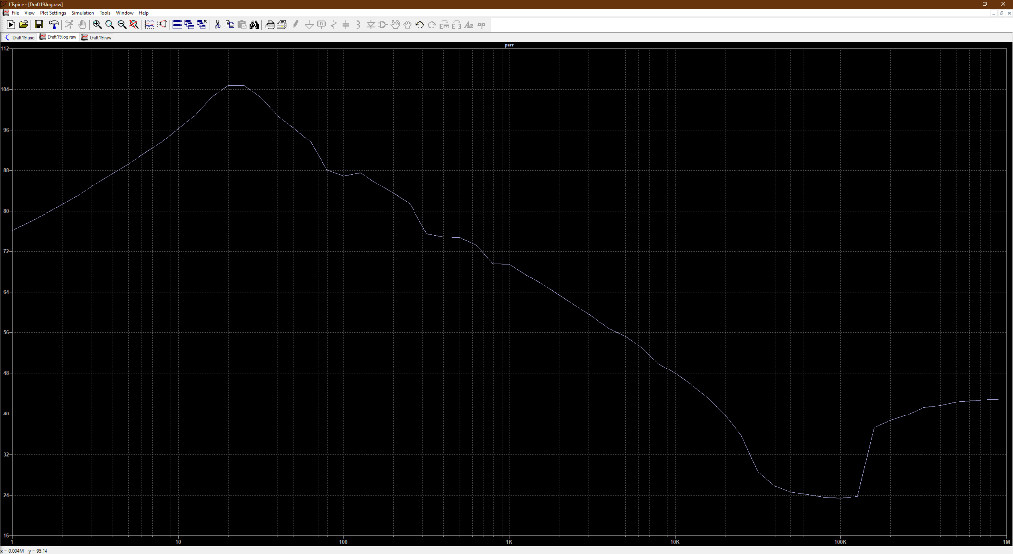

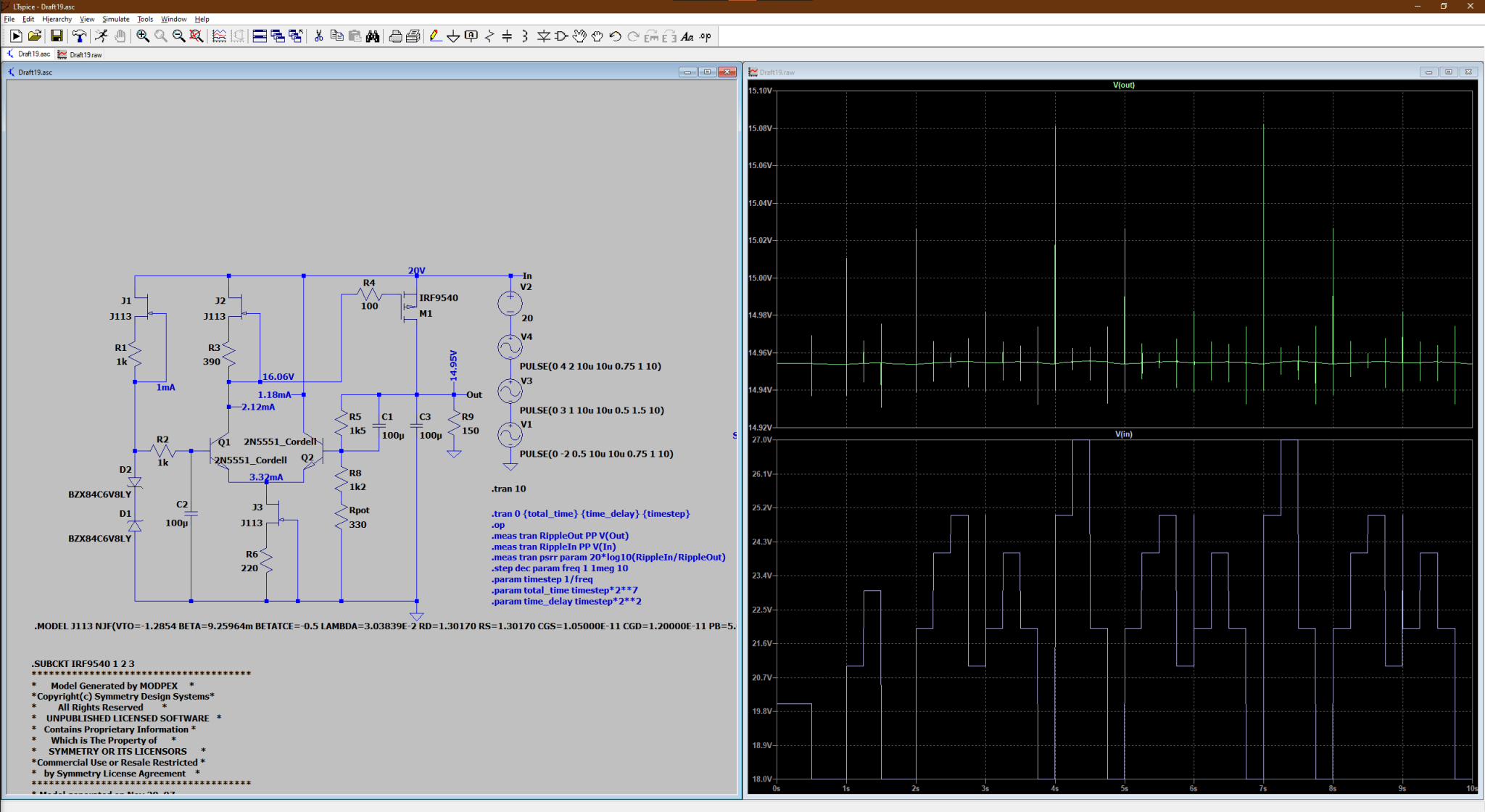

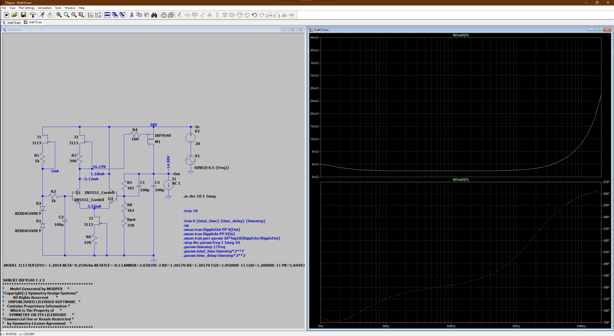

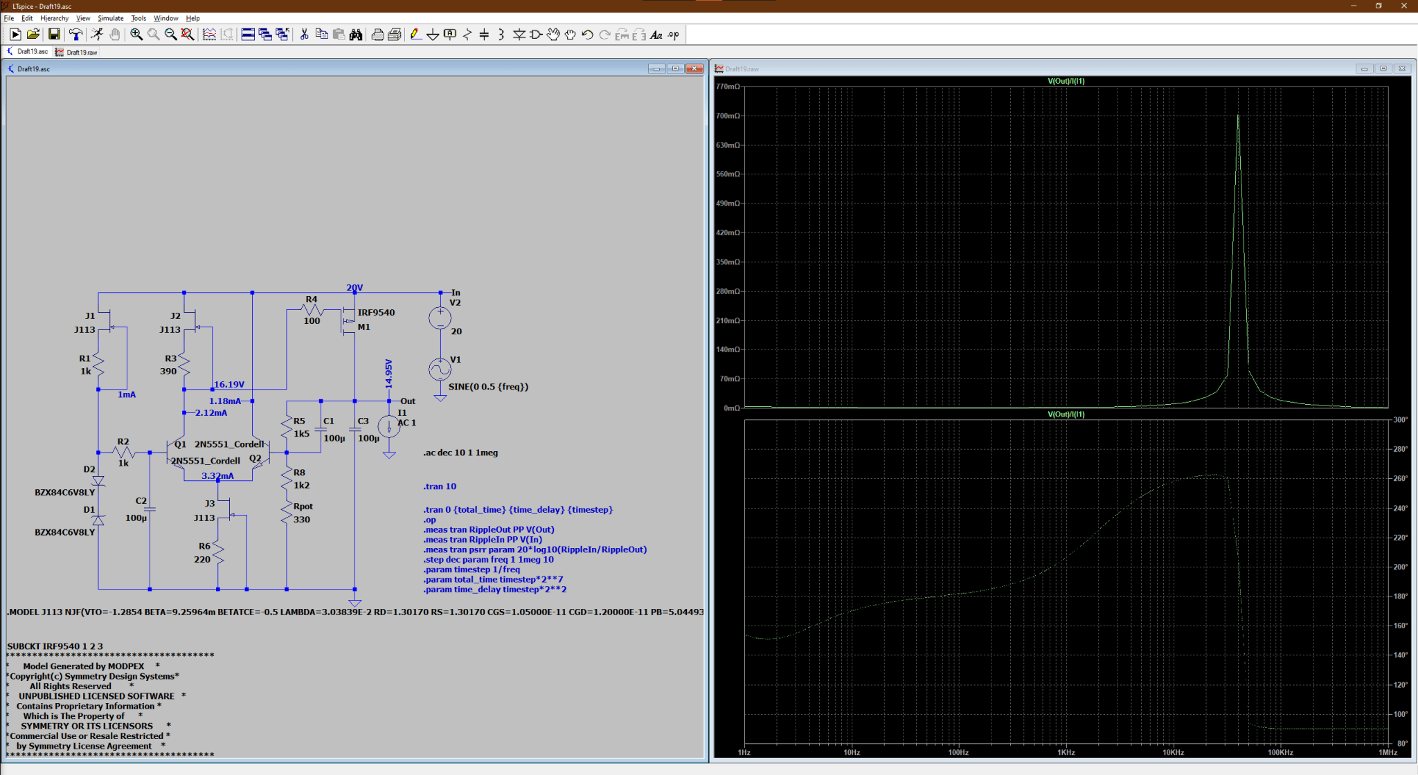

Discrete Regulators +/-15V with good performance
PSRR:
10kHz - 110dB ...previous 49dB
That is a big difference!

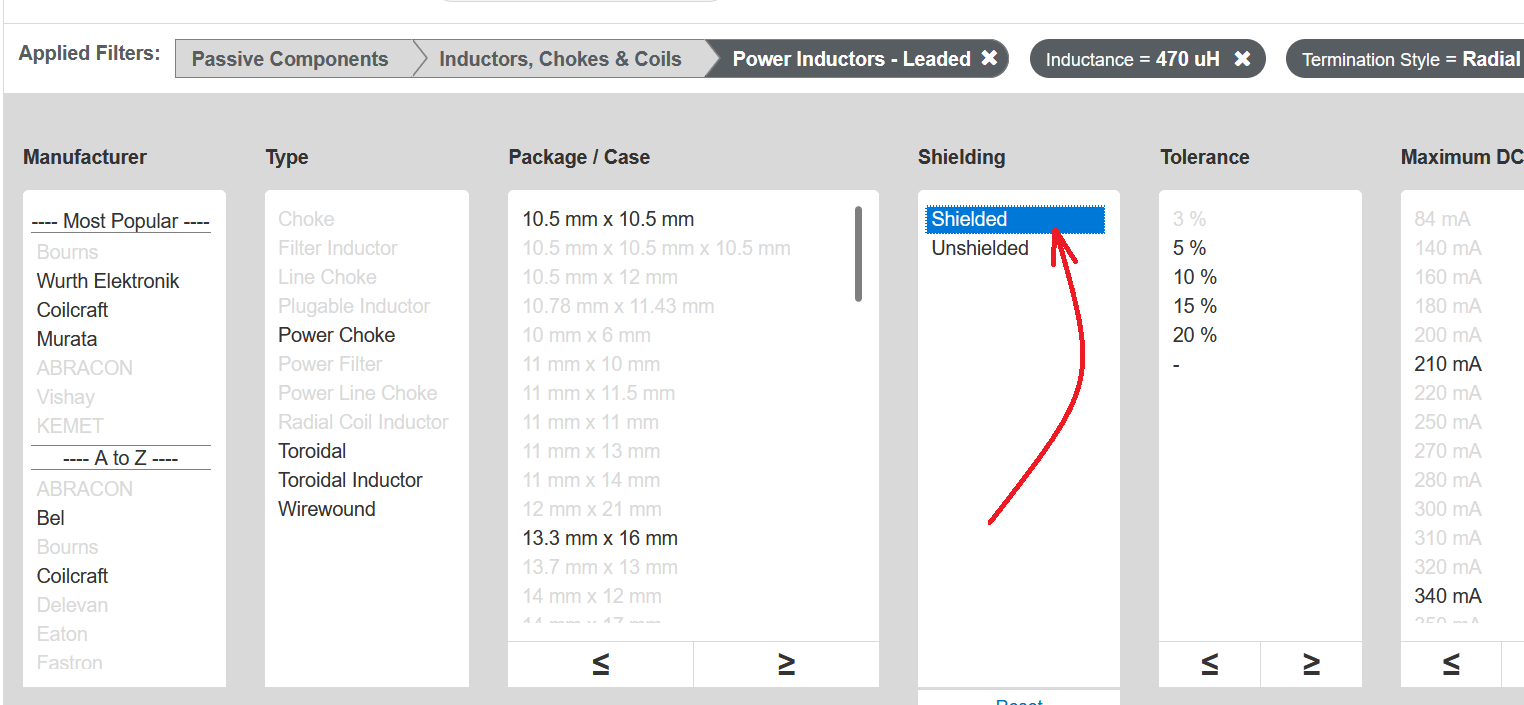

Perhaps you may wish to study the PSRR of "UDP3" -- Umbilical cable Driver for Pearl 3 phonostage --- here on these Forums. You'll see that the PSRR of UDP3 is amazingly better, partly because it includes an LCR lowpass filter (overdamped!), in addition to some wide bandwidth active crud cutters. Phonostages for moving coil cartridges require very low noise power supplies, and UDP3 is an attempt to provide them. If you are tempted to experiment with LCR filters like this one, be sure to click the "Parametric Search" option indicated below.

Improving ripple rejection by passive components R C R L has the great advantage of doing so with no impact on stabilty.
To honestly compare PSRR one should consider designs or topologies at same stability. A simple way to see stabilty is to look at the output: The ringing when fast loading/unloading is a signature of the instability.
The second best with no impact on stability is a CCS feeding a voltage reference. A large dynamic resistance ( like 10 MegOhm ) feeding a small dynamic resistance ( like 10 Ohm ), gives an immediat -120dB. But beware of indirect impedances sneaking in.
Of course active circuitry can improve PSSR as much as one likes, by means of loop gain, up to..... Stabilty is lost.
Reactions: lineup
-240dB is readily achievable using circuits with no feedback hence no loop gain limitations. But that's unnecessary overkill; reducing 2 volts of ripple to 1 nanovolts of ripple requires only -186 dB of PSRR. And 1 nanovolt is (usually) sufficiently low.
Reactions: lineup
PSRR can be measured at specific frequency (100 & 120 Hz usually) or over wider frequency span. It is always ratio between regulator’s input and output ripple voltage at specific measurement frequency, otherwise it would be some total input/output noise ratio.
Reactions: lineup
