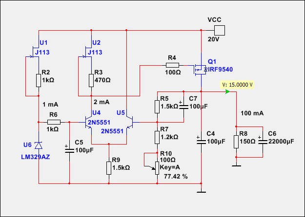

Discrete Regulators +/-15V with good performance
First.
To feed the regulators you need a 2x15VAC transformer and rectifiers.
See first image.

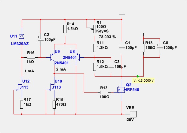

The discrete regulators for positive/negative uses 5 transistors each.
The negative regulator is a mirrored circuit.
Test run shows very good data and precision thanks to 2 current sources.

As this is a lowdrop Regulator it will work very well even at 15.2V input.

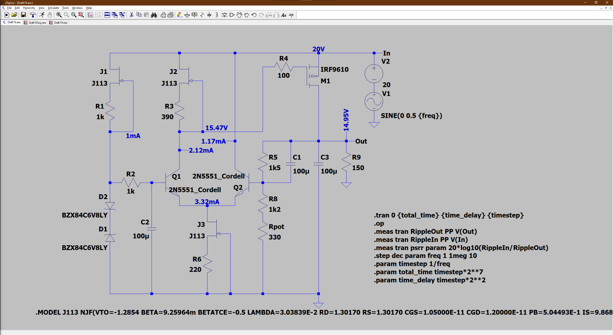

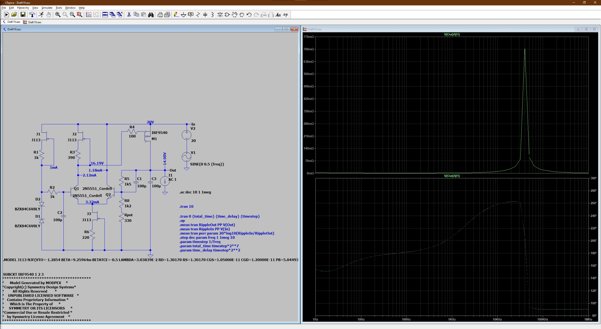

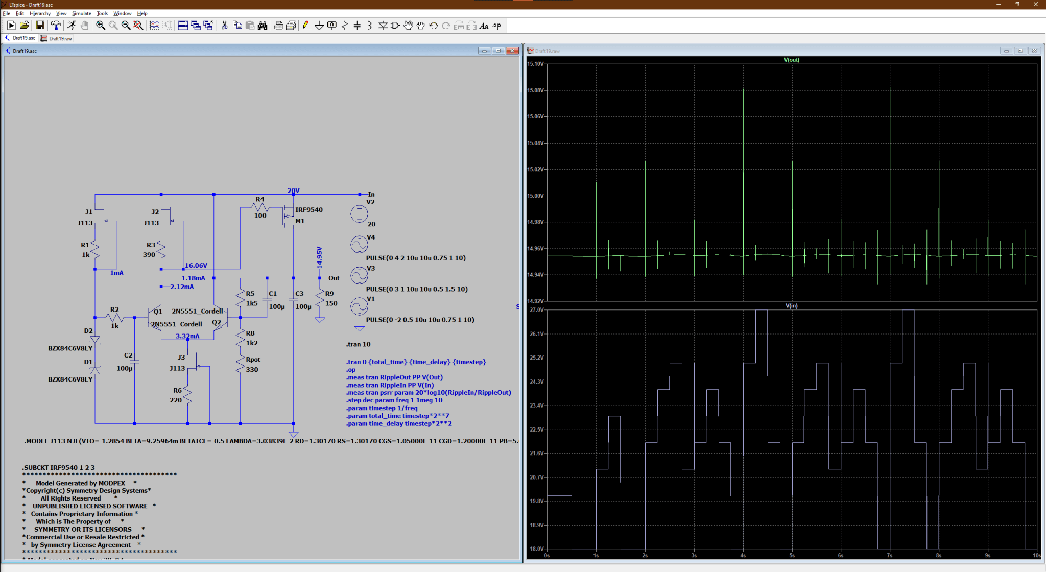

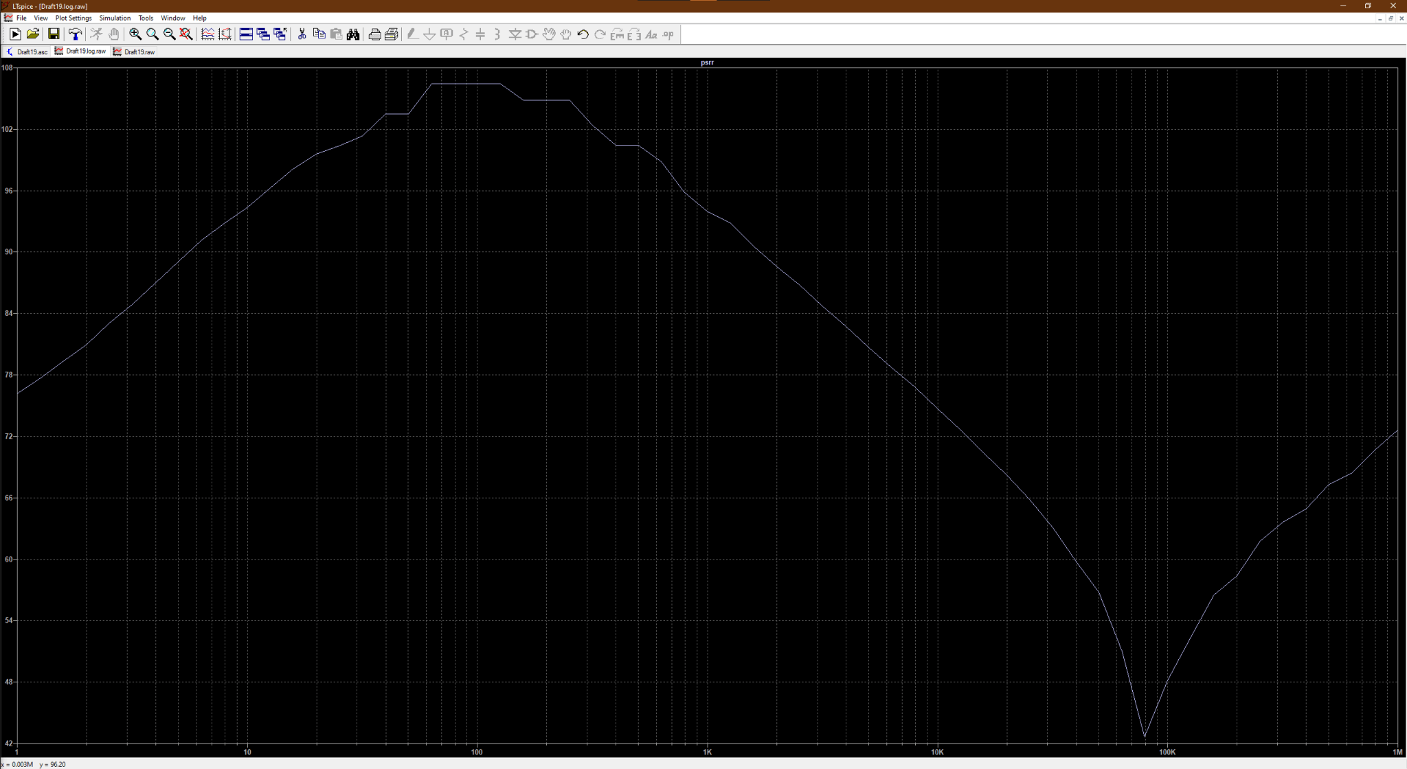

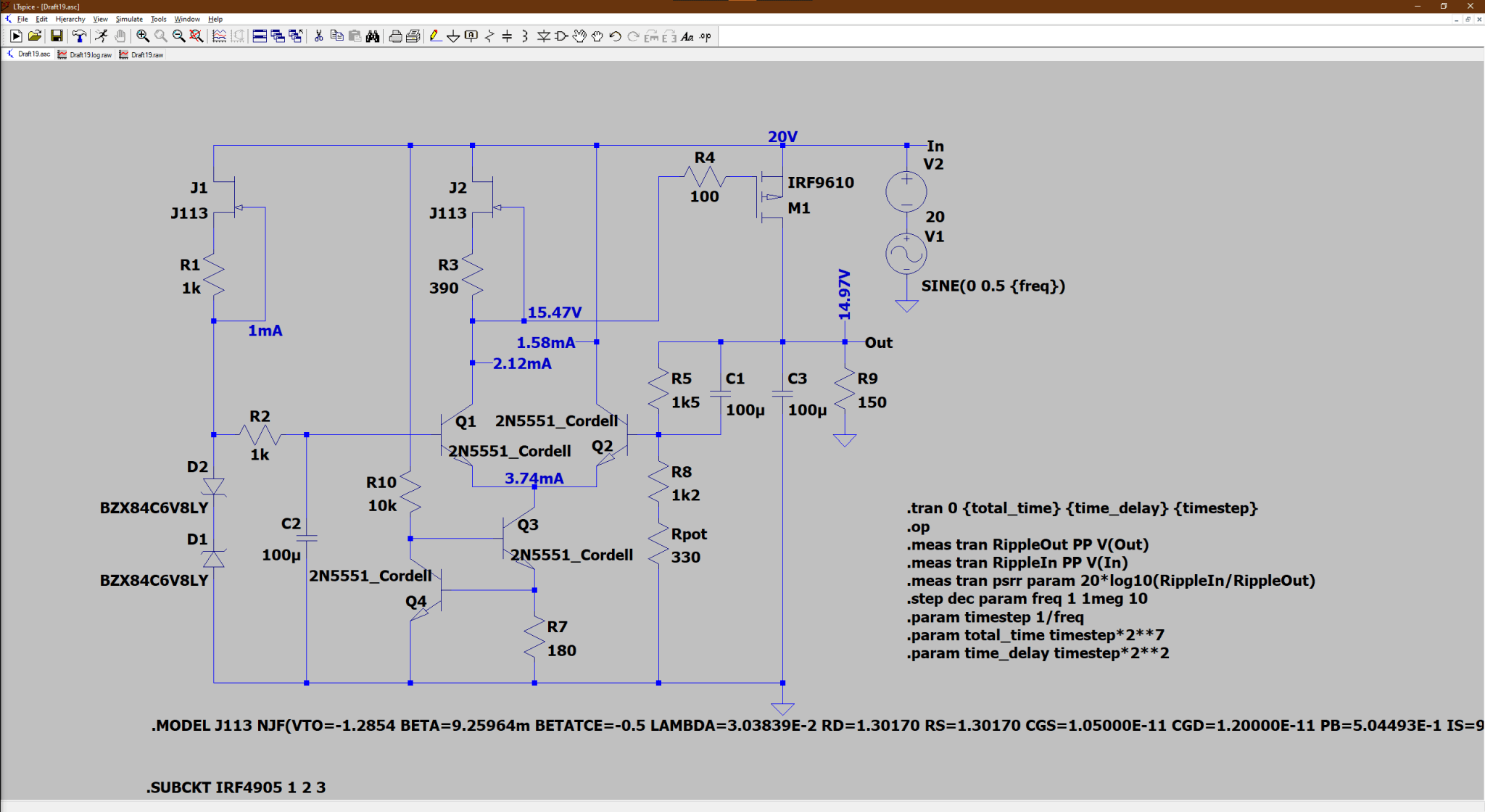

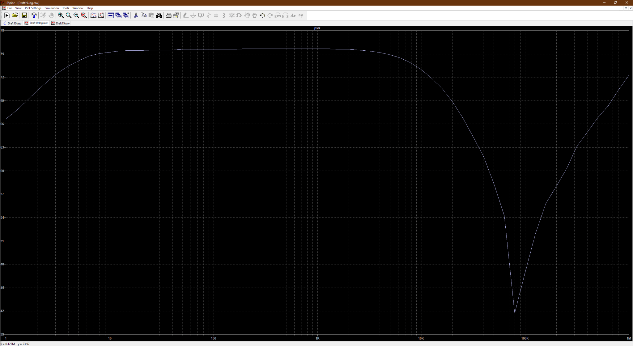

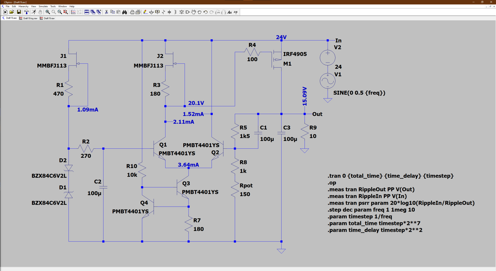

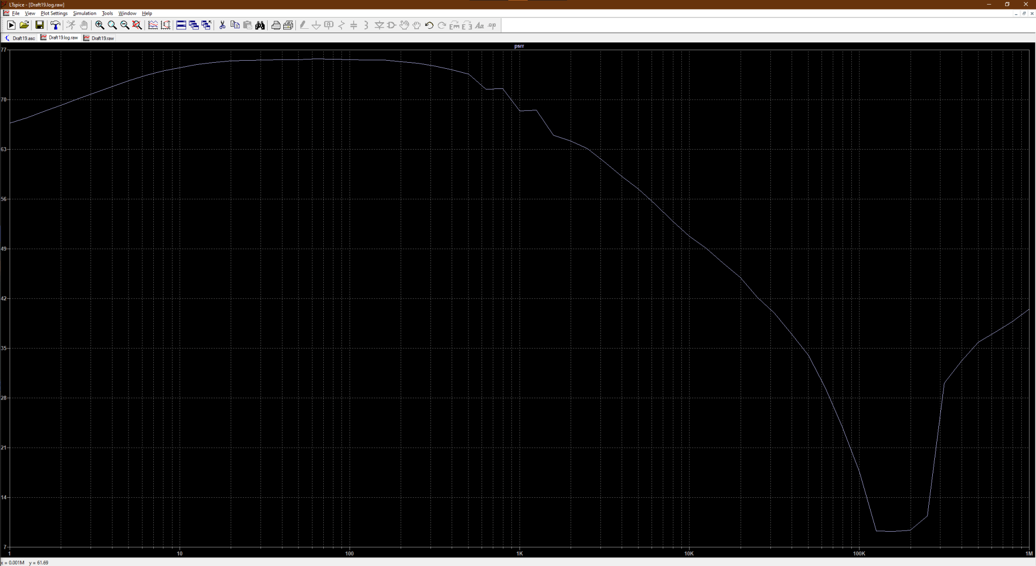

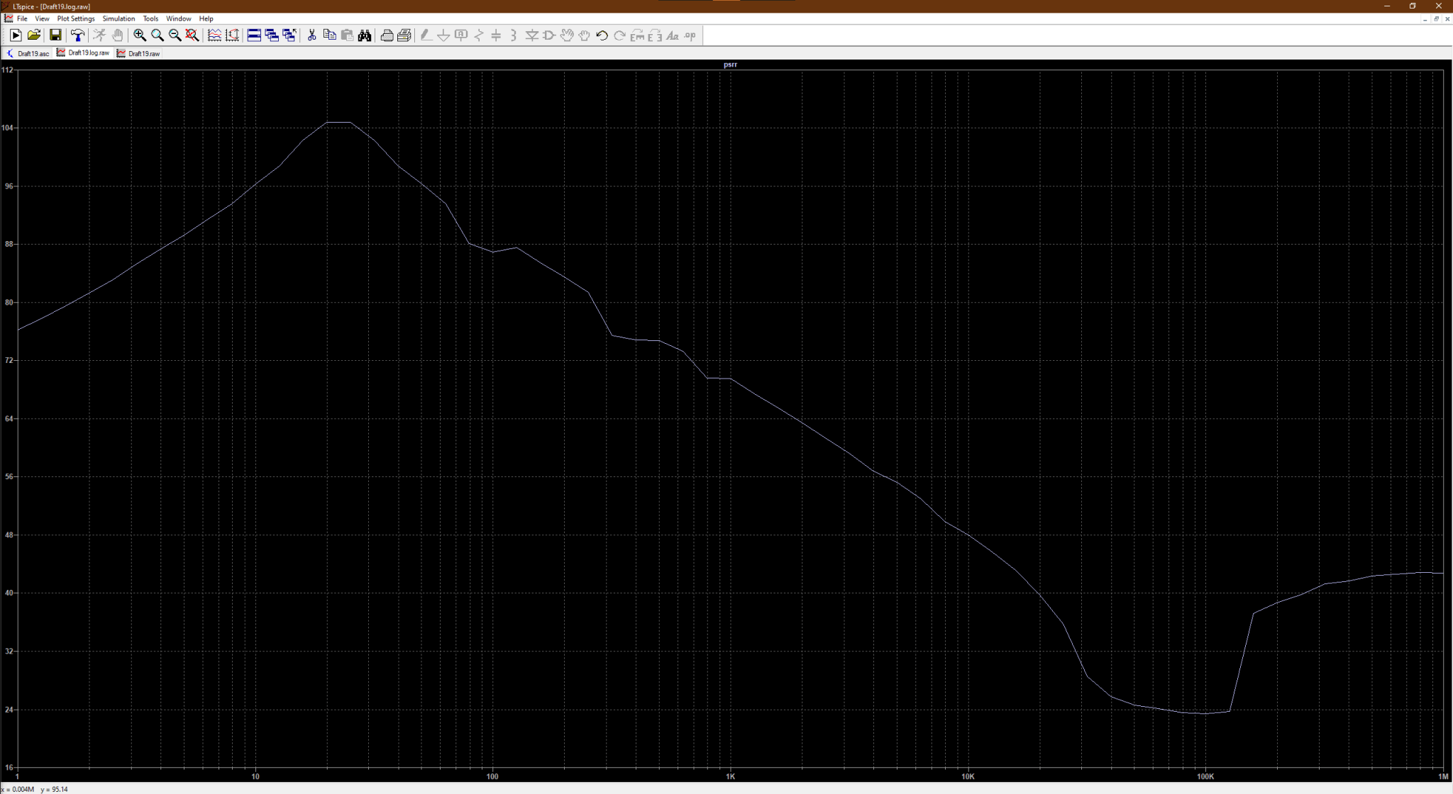

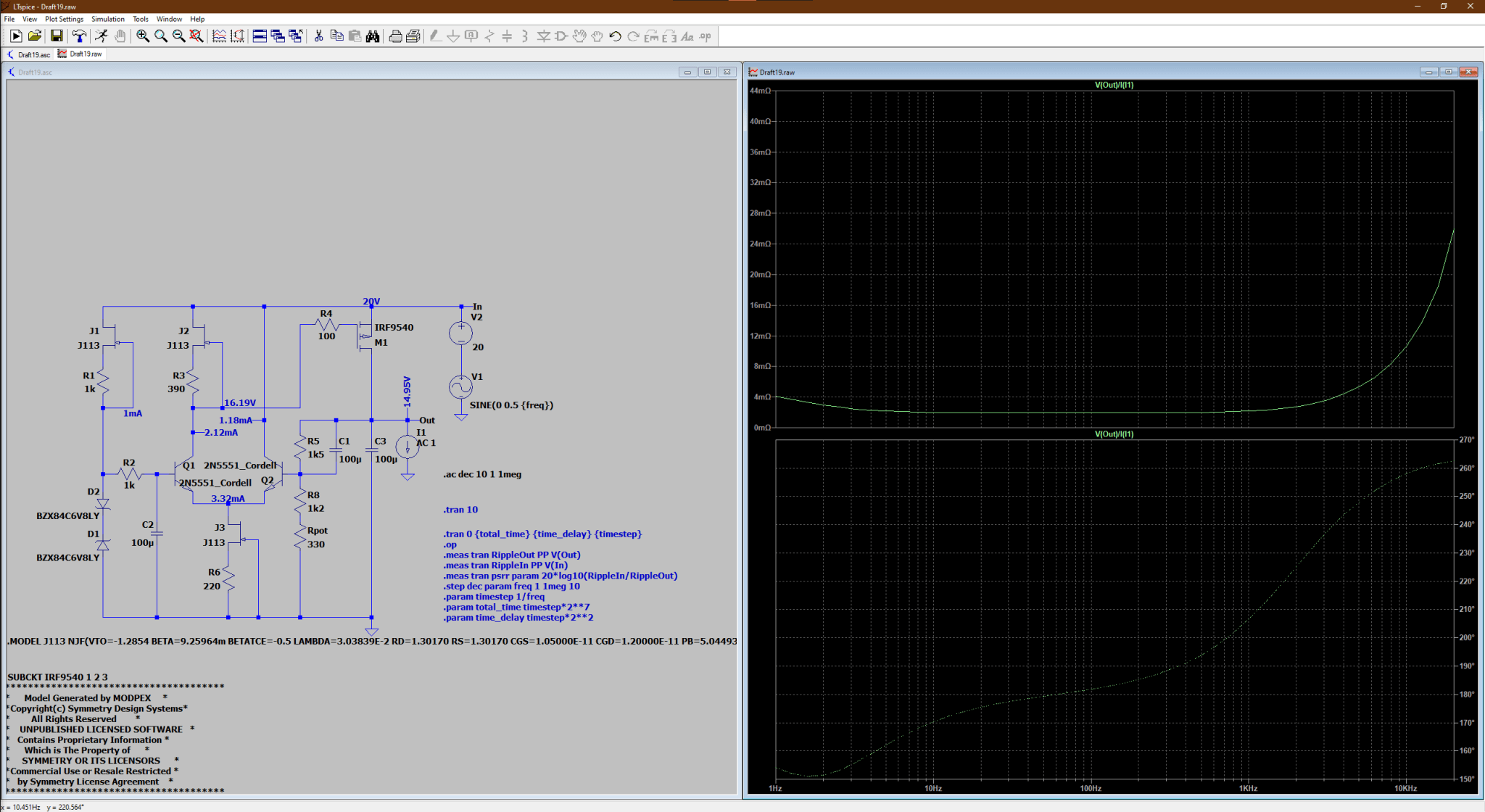

I took the liberty of doing some sims of a slightly modified circuit. Replaced the 1K5 resistor with a constant current source and the LM329 with back to back zeners.
Load-line regulation
PSRR
Output impedance
Noise

Walt Jung (and I) would recommend that you increase R2. Walt's recommendation is R2=5.6K, but he envisions implementations where R8 is fixed and unchangeable, and "Rpot" does not exist. Seeing that you do include "Rpot", I strongly recommend R2=22K. Which is even larger.
Also I would suggest that you think very hard about why you use an approximately-constant-current-source at the tail node of a diff amp whose input is a fixed, constant, unchanging, stable DC voltage. There is no common mode input signal hence no need for wonderful CMRR. In what way is the CCS implementation superior to a simple resistor between the emitter tail node, and ground? Why spend the parts cost and the board area? Are you simply copying someone else's design, imagining & hoping that they know more than you know?
