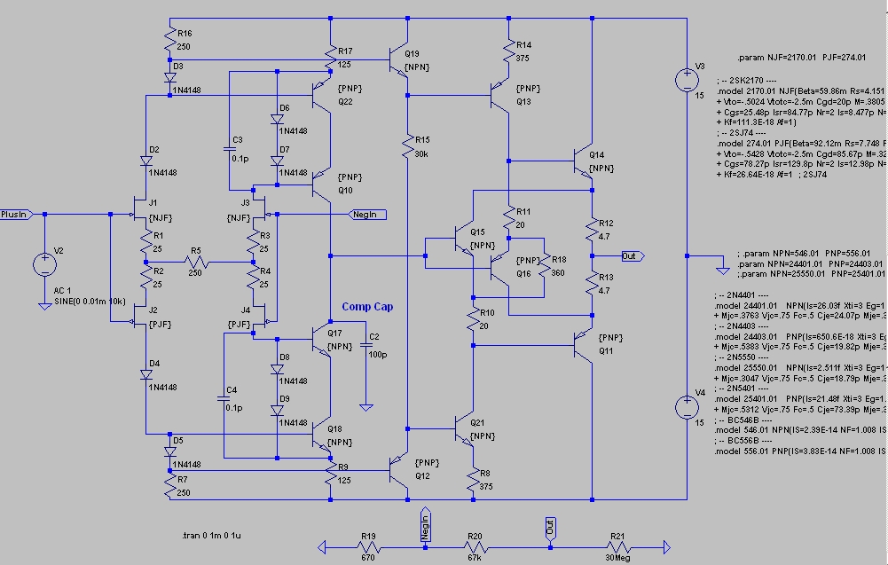

Hmmm, this should probably be looked at by somebody who understands the subtleties, tried 3 complementary pairs and got DC output levels of 1, 4.5 and -7 volts. My problem, LTspice, or something else ...?
Well, I've spent the last 10 minutes trying to upload a couple of files to attach -- Jeez, I'm sick of braindead software, glad to be out of that game ... try again later ...
Tried again, still not working ... 😡😡
Hooray, tried a different browser, could be a coincidence, we're cooking ...
Frank

The intent was to only change the input stage, yes the lines were JPEG'd out.
So excuse me if I'm stating the obvious ... but I take it #1397 completely discounts #1380.
#1380 was never Guru Wurcer's intention and is just as complex as #1397
#1397's only con wrt to #1380 is the need for Unobtainium FETs

Some pointers to an answer - it appears the JFET models I'm using may need to be better quality; I noted that the inter source resistor R5 on dadod's version was 50R rather than 250R, this made a big difference to stabilising the DC output point. But, reducing the value again triggered instability, more to be done ... 🙂
Frank
Frank
It is not my version, 50R is original Wurzer value.
Why do not start with my simulation file, unzip it in separate directory and you'll have all you need, with the models also.
Only difference, I did, is the compensating cap connected to the left side of 50R resistor instead to the ground, and LED instead two diodes for the cascode. After that you can start to change components, output transistors first.
dado
Thanks for that, dadod. I've already looked at your verson, and there's no real difference between the two, apart from the LED and single diodes, not sure what you mean about the comp cap. Yet you were getting close to a null DC output, didn't make sense.
Anyway, in the end it came down to the JFETs subcircuit being very sensitive to the source resistors, if you change a single 25R to a 26R say, then your version shows the same symptoms as mine ...
