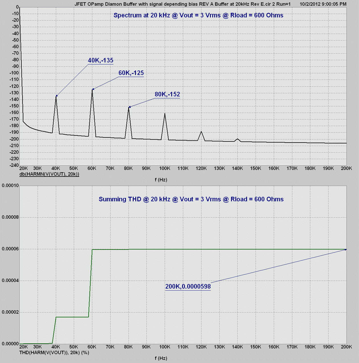

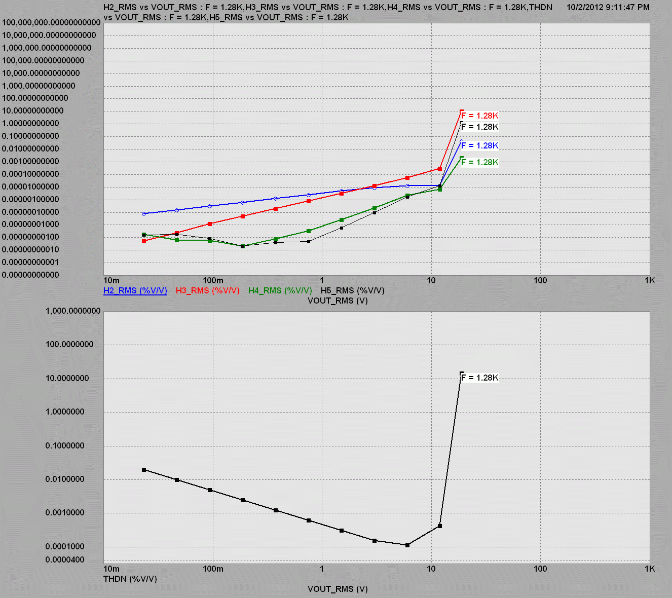

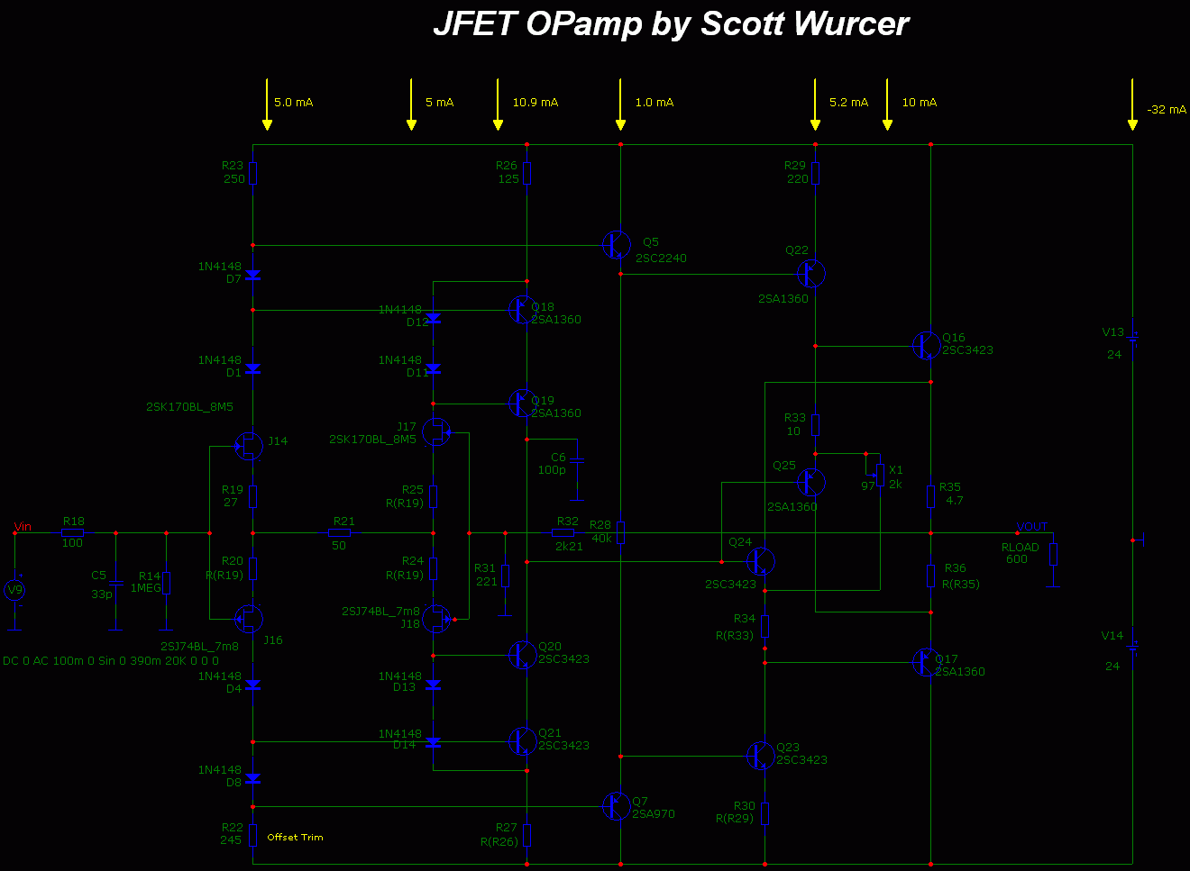

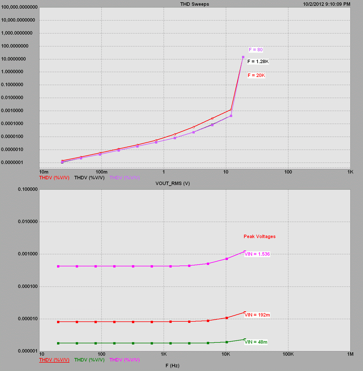

Scott,
I entered your design into Microcap 10 Pro. Used 20 dB gain (2k21 and 221R). Exchanged some of the BJTs into 2SA1360/SC3423, and changed some values to get the currents I wanted to have. Used one of the 250R resistors to null DC offset.
OL gain is ~100 dB and F-3dB = 330 Hz.
THD20k into 600 ohms and at 3Vrms output voltage = 0,0006%.
SNR is 107 dB rel. 1Vrms, 20-20kHz, flat.
I have attached some nice THD vs Freq, THD vs Vout, THD+noise vs Vout sweeps.
BTW, what does R22 (50R) in your schematic do?
/S
One last one for today, the fully complimentary version. If SK170/SJ74 FET's are used high source impedances are not recommended.

I cascode 2SK170 with J111 and 2SJ74 with J174.
Works quite well. But still only 30V.
To go higher one needs to use BJT or MOSFET cascode, I am afraid.
Makes things too complicated.
Patrick
The J111 looks good here. This is a problem, un-cascoded the distortion is degraded a bit with even a 10k source. Not that big a deal, I am measureing at extremes 20V at 20k. At normal line levels the effect is small. Will need a little more work.

... Re: post #1380 circuit ..
Q15 just samples a voltage to drive the current sources for the output stage, this saves some devices and keeps all currents set by the input stage. It also provides a slew boost to the output devices, not much benefit here at band limited audio but it makes prettier square wave pictures😀.
Sorry about the bad JPEG conversion that dropped some 1 pixel wide lines, post #1387 has a schematic that caught this.
Don't the CCSs, J1 & J2 isolate Q6, 7, 8, 9, 11, 35 and hence Q15 from the signal path?
I can see a signal path through Q15 on some of the later 'symmetrical' versions but not on the simple 🙂eek🙂 #1380 circuit.
Or are there some missing tracks on #1380
