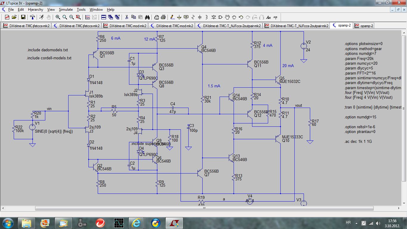

Thanks for that, dadod. I've already looked at your verson, and there's no real difference between the two, apart from the LED and single diodes, not sure what you mean about the comp cap. Yet you were getting close to a null DC output, didn't make sense.
Anyway, in the end it came down to the JFETs subcircuit being very sensitive to the source resistors, if you change a single 25R to a 26R say, then your version shows the same symptoms as mine ...

Why would you increase 4% that resistor, try 1%?
Compensation capacitor is C4 in my schematic, instead C2 in yours.

Now I'm really confused about your comp cap, in the opamp.asc I downloaded it's C3 ...
With regard to the resistor, I'm concerned about unstable equilibrium in circuits, when everything looks and works fine if the values are "perfect", but if they vary just a little then the circuit behaves very differently. So, if a DIYer happens to use non-perfect parts, or the active devices are not 100% matched in parameters say, then unwanted, larger scale behaviours can emerge ...

A comment from the sideline to Dadod.
When comparing circuits, it is important to make it fair.
If I interpret your circuit properly you are using Ccomp = 100p in Scott's circuit, while using 22p in your circuit, it is of course true that you can lessen Cc when you take it back to the input stage instead of gnd, but not as much as you do.
Here is a Loopgain comparison and a transient THD comparison, each with gain = 5
Another thing is that you use 1kohm load instead of 600 ohms and very low values in FB network.

My intension was not to compare, just simulate it. First I don't know what are suggested JFETs and BJTs. I've got couple of 2sk389 and 2sj109 and I need good line preamp so I simulated it according to that. Regarding GNFB Scott did not suggested starting values, so I used very low values as it gives better response.
You are right about Cc, half than the shunt value is better(47pF) and still distortion is lower.
I noticed that the opamp distortion is quite sensitive to the source impedance.
Here, this one is with more powerful output transistors, maybe Scott can suggest correct currents for it?
dado
