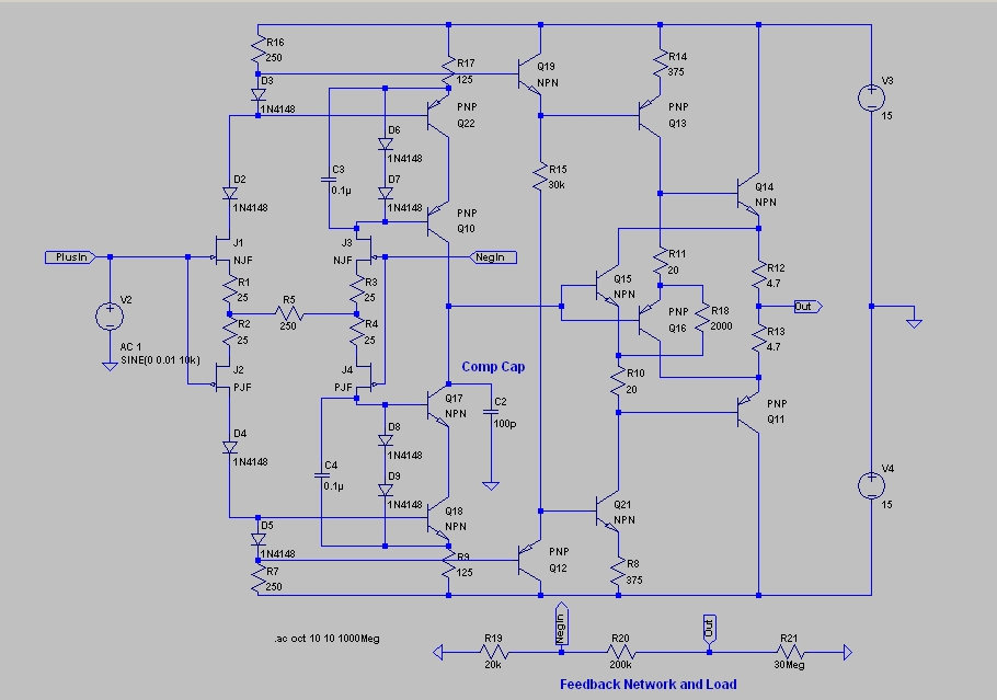

The diodes are essentially free and the 12 bipolars are 5-10 cents each. The JFET's can vary but there are some < 25 cent options. This exercise was an attempt to also "make the numbers".
The noise is just under 2nV, if you really wanted 1 nV I would entertain the inductor trick and some paralleled FET's on the input. If you wanted 30 Ohm drive I would just use a good closed-loop buffer or high current op-amp as an output stage. Those MJE devices have big Cje's to drive and two of them are bigger than the op-amp would be anyway. Notice the JE990 drops to -75dB THD at 75 Ohms.

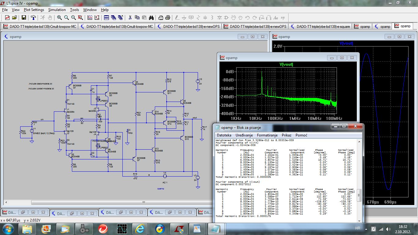

Just to let people know I've whipped up an LTspice version of Scott's 2nd, complimentary version so no-one really needs to duplicate this (the easiest one first!), and it works, how amazing, 😀! Of course, not being an amp designer, nowhere near it, took me a little bit to realise that pfets were need -- still need to insert real, reasonably accurate models of the actives, so won't post for the moment ...
Something to play with in an idle moment ... 🙂

Remember to trim R18 to set the OS standing current, 8mA is enough for non-switching behavior into 600 Ohms 20V p-p
In particular the reasons for
-all the cross-coupling
- certain diodes like Q12.
- what does Q15 do and how does it do it
The cross-coupling just gets the phases right some times it's just an artifact of order drawn.
Q12, Some of the diodes just get the voltage to match across the output of diff-pairs, it can be a small effect.
Q15 just samples a voltage to drive the current sources for the output stage, this saves some devices and keeps all currents set by the input stage. It also provides a slew boost to the output devices, not much benefit here at band limited audio but it makes prettier square wave pictures😀.
