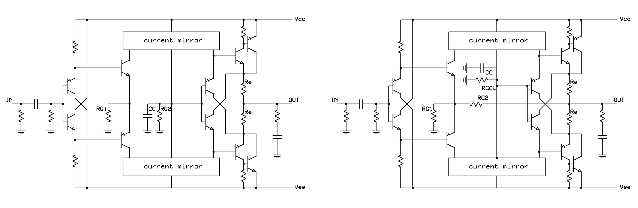

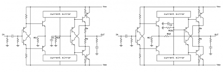

The 22K to ground was a nod to those that think 20KHz open-loop BW improves things, what I'm not sure. This should probably be left for listening experiments.
Those interested should also see Putzeys' article in Linear Audio for his take on having more gain at lower frequencies, and its effect on settling time.
It would be interesting to add overload behavior to the repertoire of tests in sim and in reality, including behavior under excessively high slew rate signals.
Virtually all conventional feedback amps (single-ended ones) will overload asymmetrically, the cure for which is making them faster, or bandlimiting ahead. Of course really poor slewing performance may require a lot of bandlimiting! But such performance is easy to avoid. According to Zanfino, Miller determined that Otala selected particularly poor designs to support his arguments about TIM. This does not invalidate the thesis, but it exaggerates a bit.
Once you make the bandwidth flat out to the highest frequencies of interest, does this guarantee equal distortion performance at all in-band signals? No, as there are other mechanisms besides those that the loop gain alleviates. One of the things I like about what linuxguru posts is the inclusion of the 1k resistor in series with the source, which is a reasonable start for what may be feeding the amplifiers. Those who omit any consideration of the source impedance are inviting sweet Spice lies.

You know, it depends. This example has no GNFB, and THD below 0.0005% in audioband. I suppose no one would also predict TIM problems 😉
When I said conventional feedback amps, I meant conventional feedback amps with global feedback.You know, it depends. This example has no GNFB, and THD below 0.0005% in audioband. I suppose no one would also predict TIM problems 😉

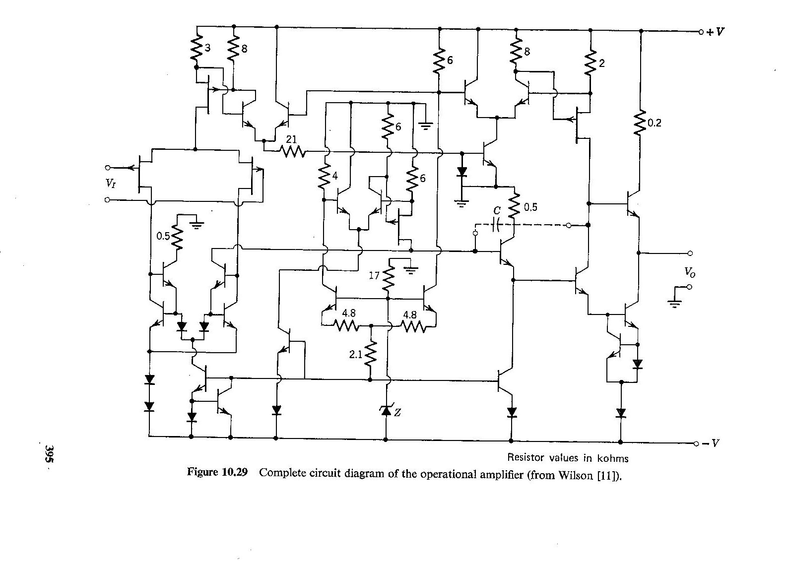

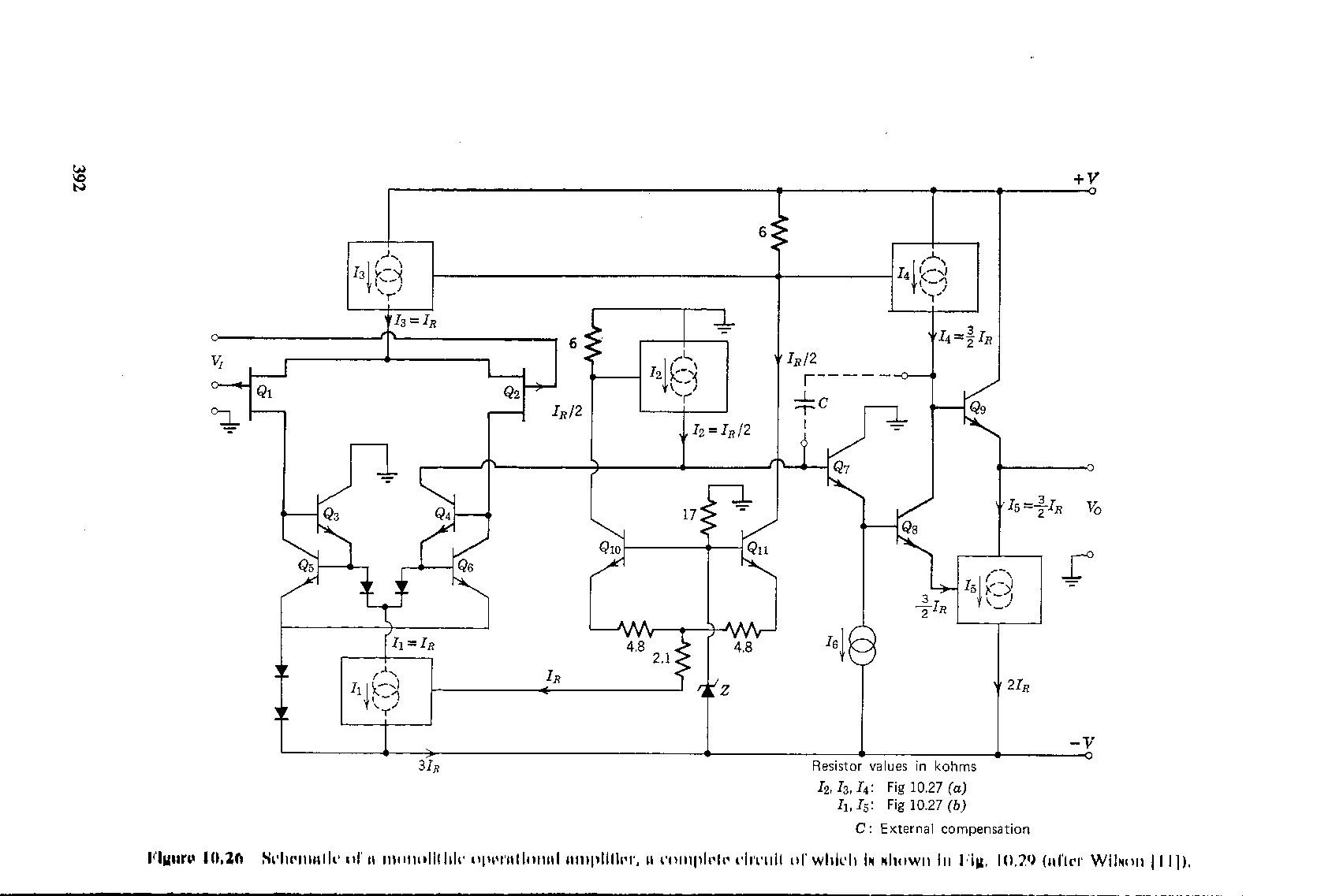

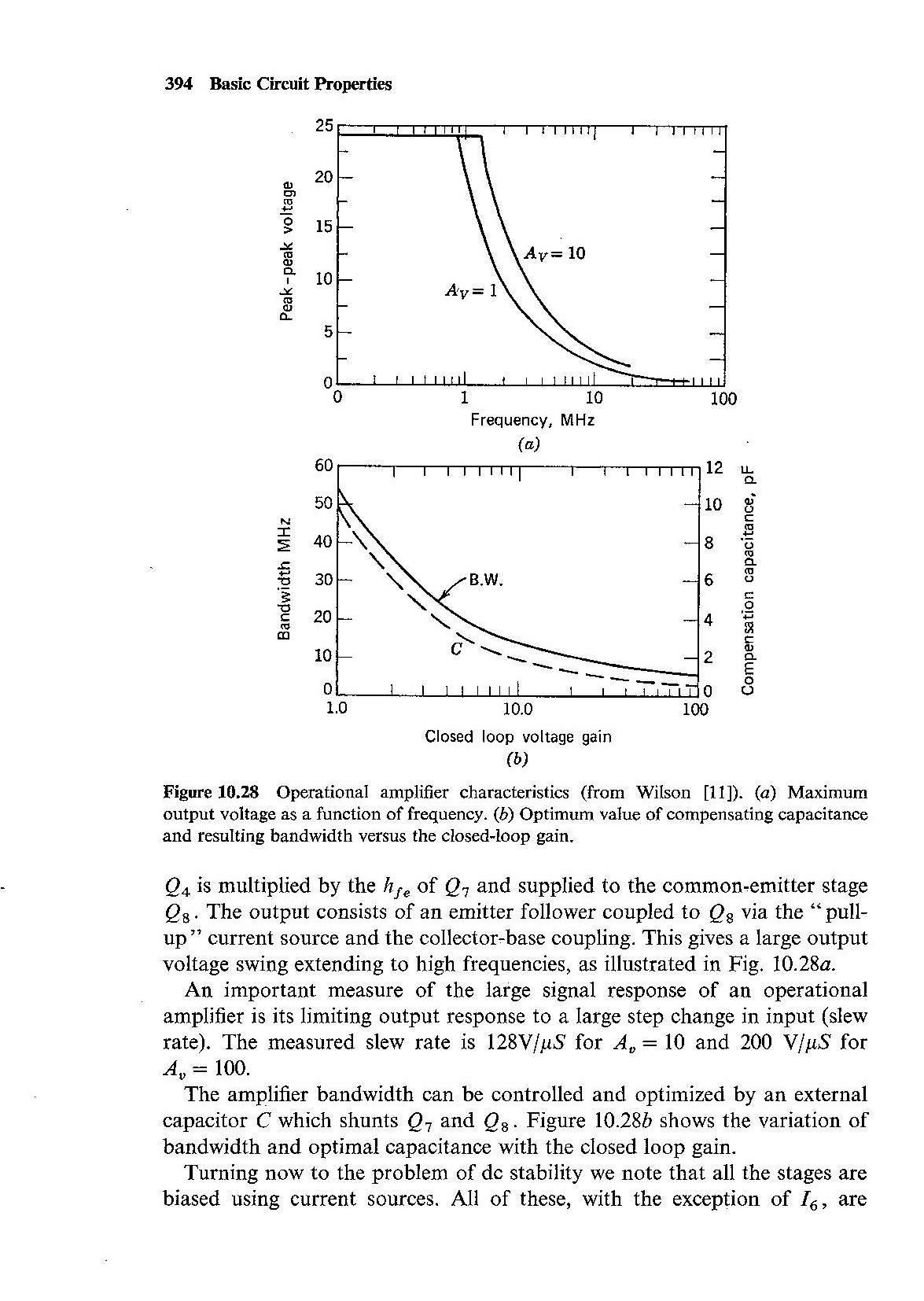

Wilson opamp
Hope these don't get Wiley's panties in a bunch, as they say. If so I'll take them down.
The spine is a little the worse for wear, but I've gotten a lot of use out of this book.
Settling time of GNFB design depends on frequency compensation method used.
Also, depends -- if CMF circuit - no Cdom.
Most of the circuits I've seen have ample junction capacitance to act as such.
Dick you would like the Wilson current mirror Wiki page. Barrie Gilbert and George had an overnight bet on who could make the best current mirror out of only three transistors, and George won.
I find it strange since given the first two there are not many ways to connect a third.

Instead of Wilson Type, the third could be used as "helper" to overcome the base current difference?Most of the circuits I've seen have ample junction capacitance to act as such.
Here is a good book by the late Hans Camenzind, check Page 3-4 to 3-6 for these mirrors.

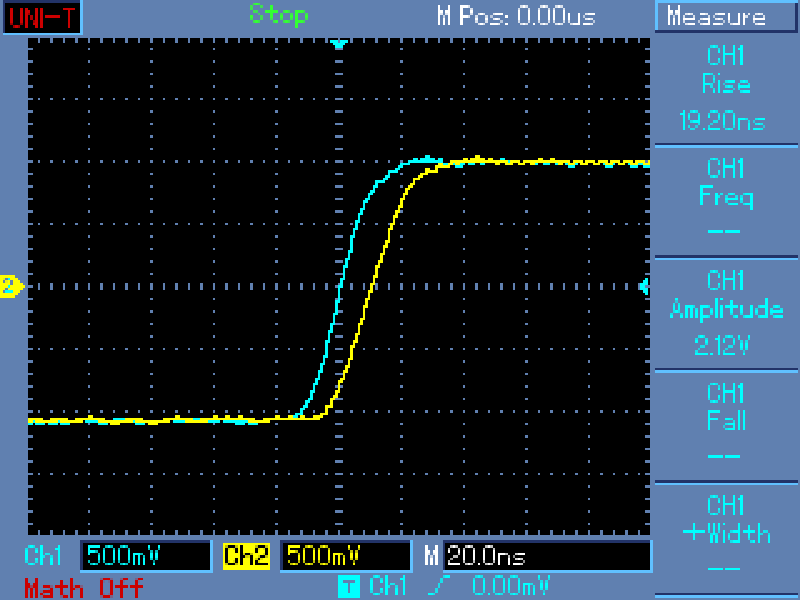

Doing some tests on what Bruno writes about in his article was more or less my idea when I started playing with discrete CFAs.
L.
