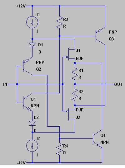

I like Gerhard's idea to settle an symmetric version of the LinuxBuffer.
Unfortunately my understanding how to symmetrize the buffer leads to
higher component count than Gerhard's schematic...
Just a thought, but not simulated.

Symmetry IS important.
Last year I was making just a buffer to entertain myself and was up to 12 transistors and heading towards more before I said - 'stop'. Way too many transistors.... but the distortion was unmeasureable (really low). IMO I decided for myself that the lowest harmonic content couldnt be the only goal. What other parameters make for a better audio circuit besides noise, IM and harmonic content? How important is CMR in audio? PSR is important but can be divided between power supply and circuit.

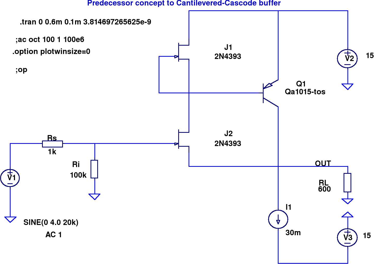

Just for historical interest, here's one of the very conventional predecessors to the CCB. It's fairly ordinary in distortion, but has high bandwidth. It's probably easier to make a symmetric version of this one...

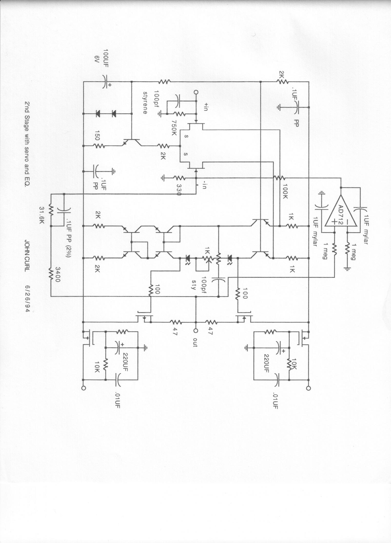

Well, I don't know what I mean, Richard, except that to remove active parts from my example schematic would compromise it, somewhat. However, many here would add 10 more active devices in the follower stage, etc. I do shake my head at that.
By the way, this design would not need a servo if the gain were reduced to headphone levels, if that bothers you. '-) Just use a monolithic dual fet at the input.

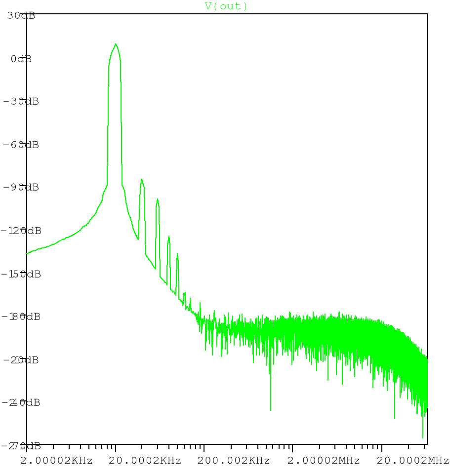

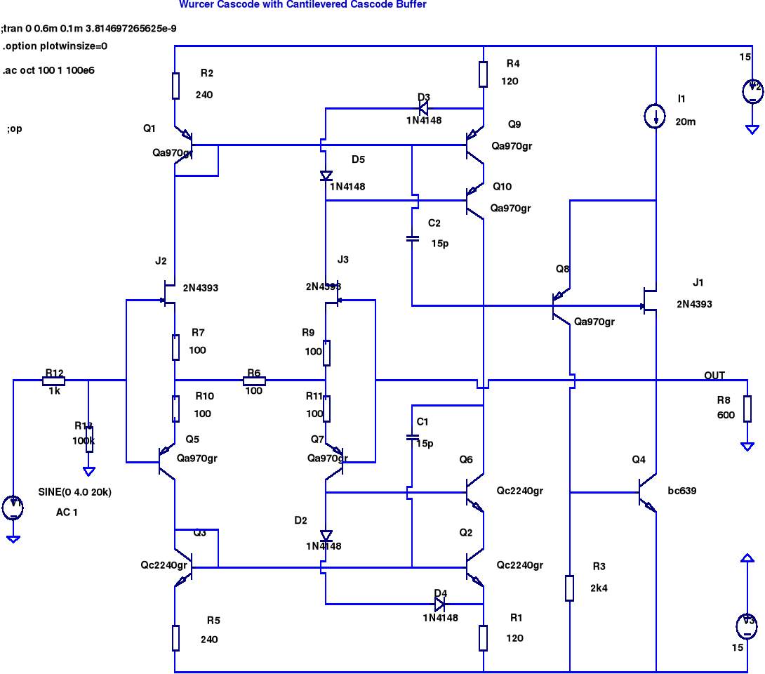

I combined Scott's cascoded gain stage with my CCB, and it sims Ok. I kludged in a pair of PNPs instead of P-JFETs in the LTP, and it doesn't appear to hurt.
THD20 sims at -95 dBr at 4V into 600R, without much optimization. GBW is 25 MHz, small-signal.
