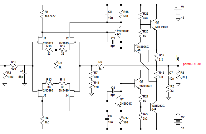

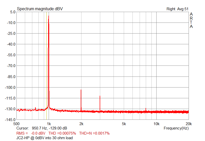

Breadboarded a slightly modified version of the circuit in #271 - more or less a JC2 with a diamond out: *** unselected *** J113/J175 in the front-end, BC550/560 in the gain/driver stages, MJE243/253 in the output stage. Even with randomly choosen devices, it rocks - THD < 0.001% @ 1kHz, 0dBV into 30 ohm, only low order.
More to follow.
Ciao,
L.

Very nice -- esp. unselected and not a sim of ideal perfectly matched parts. 🙂

Coluke -- what is the schematic, pls?
I am tinkering with boot-strapping a whole circuit and see if it stays together. Just adds two more transistors. Thx - RNM
Post #271 is a post fm Euvl without any pics or attachments? Post #273 I beleieve contained the first attachment.

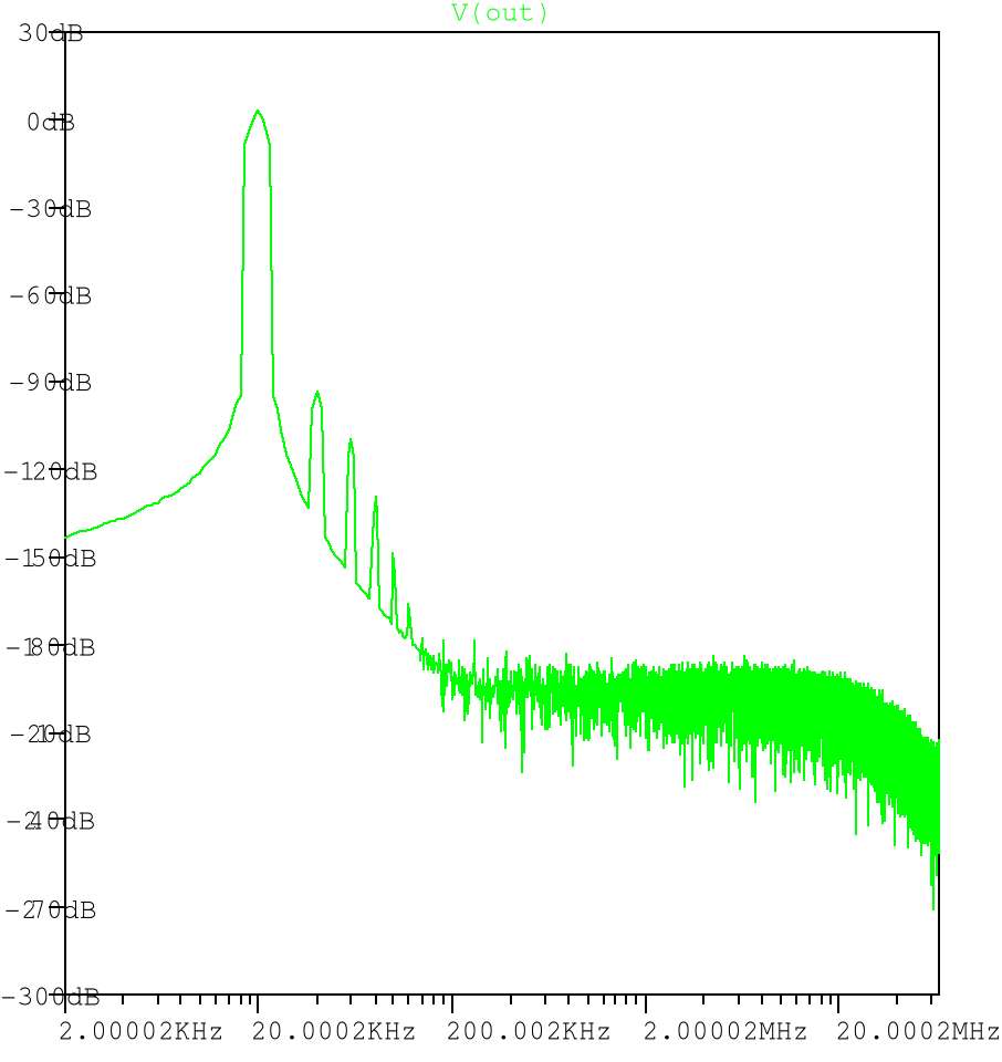

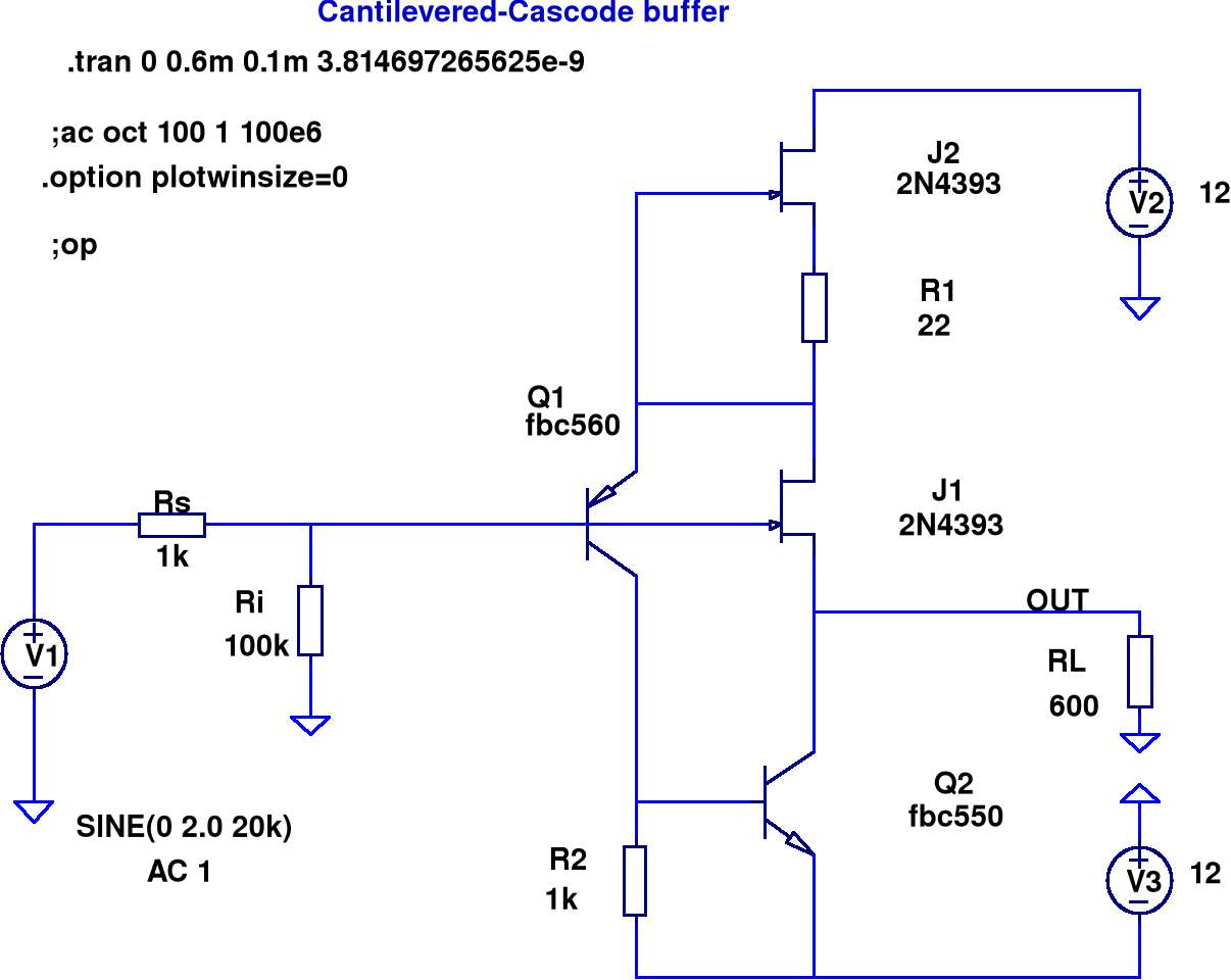

Here's a novel buffer with just 4 actives including a current source. It simulates with THD20 of -95 dB at 2V amplitude into 600R, at a quiescent current of 12 mA.
This topology differs from one published in these forums a few years ago. I hereby exercise my right to name it: Cantilevered-Cascode Buffer. I hereby also exercise my right to place it in the public domain, free of patent encumbrances. No warranty, express or implied, is provided.

I like it, a clever form of load current compensation, tuned for the particular load but robust against moderate changes. It is reminiscent of a circuit shown in a short article by Danyuk that I'll try to find a link to, particularly the operation of the one JFET at a low Vds.
With my particular models for the devices and the load R, I find that fine-tuning R2 (nearest E96 value 2.43k) can drastically reduce 2nd harmonic and as well reduce output offset, leaving 3rd strongly dominant and overall distortion for 2V peak in at 1kHz to about -118dBr. The bandwidth is also very high (around 50MHz) and a bit of peaking is quelled with about 2.2pF to common at the input gate/base.
The optimization of R2 is not frequency-independent or load-independent, but at 20kHz 2V peak the again-dominant 2nd brings things up to about -104dBr.
