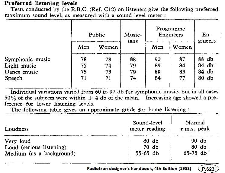

That is a good point to remember -- I tend to forget about it because I use high power amplifiers to prevent clipping and use high effeciency speakers. I suspect a lot more of clipping goes on than has been assumed; compressed recordings will bring us closer to the threshold of frequent clipping when played at moderate to high listening levels. And, low effecint speaker with low-moderate power amps will make it easier to clip, as well.
Amount of neg feedback, of course, affects the produced harmonic distortion structure when clipping does occure.... adding to the amps 'sound' character. The lack of this is often noticed in very high power amplifers.... say greater than 250W/cnl; Often described as an effortless and easy quality..... or just cleaner sounding. In fact, it may be one of the major reasons why amps are described as having a sound difference from one another.
Magazine reviewers and consumers swap in various amps and speakers during listening evaluations without regard to efficiencies and amp power rating differences but listening at same spl. -Thx RNM

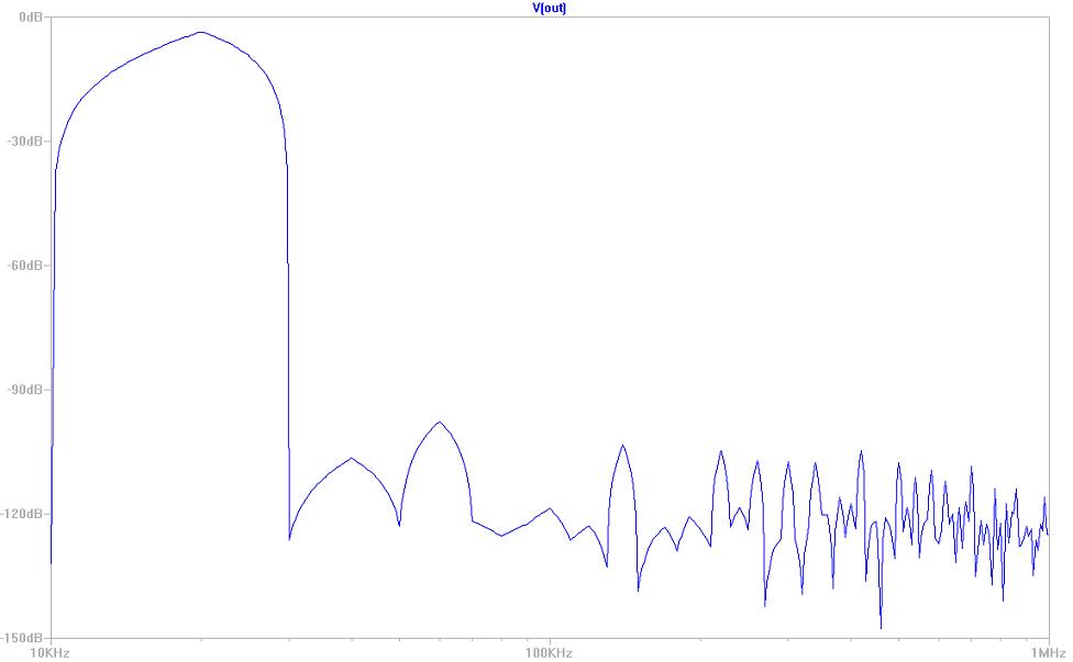

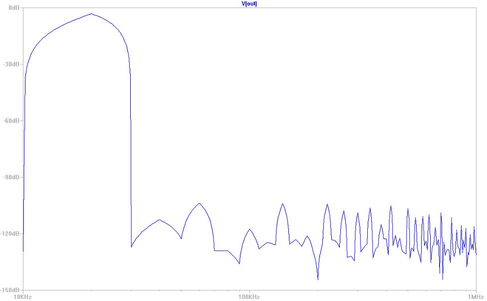

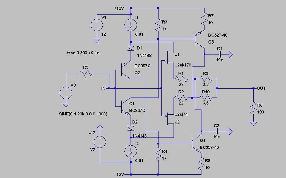

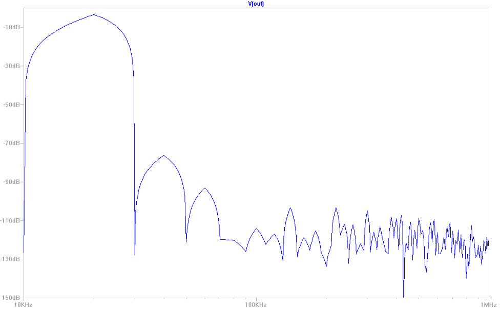

...went on with simulation of the symmetrized LinuxguruBuffer.
The attached schematic is showing some additional resistors to allow proper biasing.
Overall the simulated performance is among the better ones I saw in simulation so far and worth a real life trial (..my LTSpice never pleases me with -120db THD...)
But I have to state again, I do not trust the absolute values of the simulation of harmonics in the sub -80db range.
In fact the choice of Q3 and Q4 is not my favorite (heat handling and linearity of Ic/Uce characteristic), but was available in LTSpice.
In reality I would propose 2SA1930 and 2SC5170.
Q3 and Q4 are biased around 30mA.
The schematic shows degeneration resistors for Q3 and Q4.
They are not necessary for biasing, but I would guess that reality performs better in THD and TIM with them, while simulation does not show much effect (up to now only single tone simulated).
To my understanding Q3 and Q4 cannot be rated as inactive support functions, they are actively handling music signal in a similar way we are used
to it from Sziklai darlingtons. And we get the same sort of oscillations that need taming, which I did with a brute force dominant pole - not really nice, but acceptable as a starting point.
Furtheron in reality it might be better to use red LEDs for D1 and D2.
Last but not least the buffer is showing a strong increase of distortion when driven from high impedances, similar as it is known from diamond buffers.
The attached pictures show
- Schematic
- Harmonics at 20kHz/1V into 100 Ohms (R6)
- Harmonics at 20kHz/1V into 33 Ohms (R6)
- Harmonics at 20kHz/1V into 33 Ohms (R6), but 100k driving impedance (R5)
- Schematic
Sure, Q3-Q4 swing voltage. That was the problem in my experimental proposal. I had the Led idea too but it could also be a string of transdiodes. You could simulate the input impedance and do a low pass filter at the input to avoid that range.
I agree, nothing really wrong with a string of 1N4148.
It is more my taste to use red LEDs, because of less component count and red LEDs are hard to beat in terms of noise (not much of relevance here, agreed..).
From my understanding the influence of the drive impedance is caused by the fact that Q1 and Q2 do operate on mostly constant Ic, but not perfectly constant. You will find the modulated base currents of Q3 and Q4 there (similar as in a diamond buffer). This then translates into modulation of the input current of the buffer - reflecting the non linearities of the current gain of all the BJTs. BJTs show these non linearities also at low frequencies and DC. I would assume that a filter may shape the frequency dependency of these distortions, but I am wondering how a filter should cure it.
Nevertheless, I a curious to your real life findings - in case you decide to go for experiments.

...went on with simulation of the symmetrized Linuxguru Buffer.
I may start a new thread for in-depth explorations of linuxguru's approach. It deserves some elaboration and further development, I think, and I'd also like to make things public to prevent someone from patenting them.
I have a good many variants already, while loosely justifying the time spent because of the circuit's applicability to many things. Although it can be incorporated into global loops, I'm seeing such good performance of modified versions that it's tempting to let them stand alone, with possibly a d.c. servo in some offset-sensitive cases.
It's interesting how close the circuit is to merely a complementary feedback pair. But not quite.
