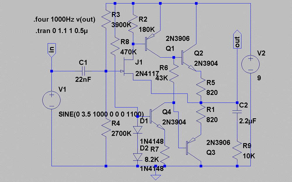

lineup said:The current source sink is maybe 300uA ( 0.5V/1K5 ).
The JFET is biased only like 5-10uA !!!! ( 0.6V / 100K )
leaving the rest, 290uA for the PNP bipolar.
I Would expect to bias JFET at least 50-100uA
and leave 200-250uA for PNP.
In my understanding this should improve performance quite a bit.

According to the sim, the current sink only sinks 200uA (I made the resistor on its base reasonably high.
Of that, the JFET gets 7uA and the rest goes to the PNP. On reflection it's running rather lean. By dropping R1 from 100K to 22K, this puts a rather more healthy 25uA through the JFET.
Interestingly enough, at 7uA it still simulates quite well. (THD=0.018% with 1V RMS 1KHz input).

but a 1.5k resistor in that circuit will sink more than 2mA. The whole point here was to design a low current (~200uA) design to run off batteries for a long time.

It's a pity you can't see the schematic. I can email you a copy if you like. The modification replaces the 15K resistor in the original circuit with a constant current source, using an MMBTA06 npn transistor. The base is biased to ~1.2V with a pair of 1n4148 diodes to ground, and a 330K resistor to +9V, and there's a 1K5 resistor from the emitter to ground. This results in ~200uA quiescent current (at 9V).
Suzy
Hey, I can see it now (I don't know what is going on).
I reckon the circuit you've got there should suit the intended purpose. After all, 200uA can charge 100pF to 200V in 100uS! 🙂
I guess the load is 10kohm. Gives +-140uA.
25uA in JFET may be close to the optimal value, for only 200uA CCS.
25uA + 175uA idle.
Gives +-140uA making the PNP bipolar operate:
35uA - 315uA, at 1 V RMS output into 10k.
As the main quality here is determined by the JFET linearity of operation,
it would be interesting to see
the same THD for 22k(25-30uA) in PNP Base-Emitter, instead of 100k(6-7uA)
If you dare to post it 😀 at the risk my suggestion was an improvement .....
I agree, THD=0.018% is good. Maybe better than we ever need here!

0.020% with 22K (1KHz, 1V RMS, 10K load)

OK, here’s my submission. It’s past midnight now and I
really, really should be in bed, but I was stupid enough
to drink a couple of cans of Coca-Cola an hour or so ago.
Approx 300uA quiescent current and check out that
distortion into 10k at 1kHz at 500mV rms! Top that! It
rises to .001% at 1Vrms.
Glen

G.Kleinschmidt said:Top that! It
Looks like this thread is becoming an on-line contest:
Mine is bigger than yours;
boy's stuff; I'm sure suzy
Elvee said:Looks like this thread is becoming an on-line contest:
boy's stuff; I'm sure suzywill love it.
Especially, complementary emitter followers fighting against each other. 😉
Your schematic without them was self-sufficient, more mature, just add a little bit idle current (male muscles in proper place).
Elvee
What kind of JFET is 2N4117.
I have never heard of that one.
Never seen it for sale here in Europe or in my country.
I get it is a N-JFET.
I know no transistor operating very well at 3uA.
Neither JFET or Low-noise small signal like BC550C.
So what kind of strange device is this JFET?
Because it is this input transistor,
that sets the main quality of your amplifier.
Your circuit is great.
But of very little use, to most people in this world
unless they can find and build it with optimal components.

Elvee,
maybe you can redraw your circuit.
Using some transistor I have heard of.
I have been member here for more than 5 years ( 4.000 posts )
and still can not remember I ever heard of 2N4117.
And nothing wrong with my remembering.
In fact it is VERY GOOD!
Regards
thank you for the best performing circuit, so far
at only 100uA ... this is fantastic
