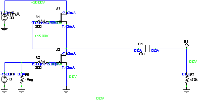

Hi Suzy,
I would like introduce more simply project, such a simply design is almost distortionless with low level signals, low order distortions starts with higher levels.
Every circuit like this should be supplied with separate power port (stabiliser).
In my guitar amp I use this circuit like a single tube with very good results (with cheap BF245 types). Other fets might have too much gain. Fets should have identical Idss.
Of course it eats much more current!
200mV AC at the input, gain X10.

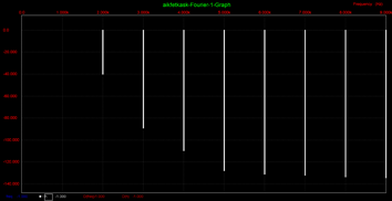

padamiecki said:You may try Aikido wersion!
sorry for the graphics
and fft 200mV at the input, over 2 volts ac at the output,
graphics is awful, 2nd harm is -49dB, 3nd - 90db, rest up to - 140dB.

Strangely, I woke up tonight thinkning: "Doh". The schematic jumped to me and screamed: "The base is connected to the collector, stupid!"lineup said:
Hej Rune
jomenvisst är du missandes something
Regards
västerbottningen
lineup
I must have been really tired when I looked at it last time.
Rune
(som inte är från Västerbotten, men gjorde lumpen i Östersund och repmånader mellan Boden och Kiruna)
Rune
Rune,
yeah, I wouldn't have need to explain this to you.
I suspected maybe you had the knowledge.
But no regrets for writing, once more, one mini-tutorial
There are more silent readers here around!
than we will ever know ....
