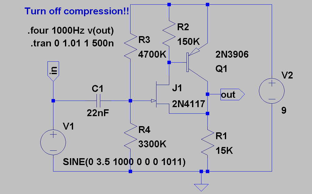

Complication is not necessarily synonymous with performance (performance that matters, not simply the spec sheet): look at Micro$oft products for example: they are huge, overblown, take lots of resources yet compare unfavourably with lean and mean freeware.
Here is an example of a basic composite buffer. The distortion is acceptable, but a shade higher than the 0.001% boasted by suzy.
More importantly, it is able to handle signals of more than 7V pp, an important consideration if you want to be sure the first cycle after a string is plucked is not clipped, specially when the battery reaches its end of life voltage.
If you find this circuit too basic, you can always improve it by adding an output buffer, a current sink biasing, etc etc.

I agree. Elvee's circuit is really remarkable. I must confess a tendency towards overcomplexity.
As for music, I'm only a beginner, but so far I've been playing mainly blues and rock, with a little folk (that I really should use an acoustic guitar for) thrown in.
Regardless of music style though, I can't see that having a ~1MOhm output impedance on your guitar can help anyone. Just changing the lead will change the response.

Problem is it can only actively source current into the lead capacitance. On negative swings you're relying on the 15k source-ground resistor to discharge it. You can reduce the value of this resistor to improve the performance, but that will increase the quiescent current.
A complementary push-pull output stage with low quiescent current could actively source and sink current into the lead/load capacitance, but with appreciably more distortion. Poke the push-pull output stage into a discrete op-amp though, enclosed within the negative feedback loop, and you’re distortion woe’s are solved!
A current sink in place of the 15K resistor helps. Here's my added complexity:
It also lets you get a tad more dynamic range before clipping.

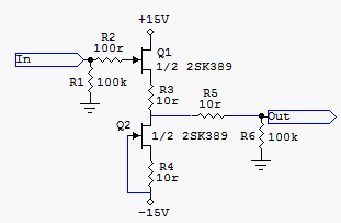

In my opinion,
Elvee circuit is about as simple and good
anybody could design this.
In this post in a JFET design topic
I posted 'my ultimate JFET Buffer' topology for low powers:
This is possible also when using single end supply, with very little modification:
http://www.diyaudio.com/forums/showthread.php?postid=1067790#post1067790

See My Attachment!
for basic circuit using a very good idea
for a JFET buffer, simple yet good!

A current sink will improve it, but it still won't be as good at driving line capacitance as a push-pull stage for a given value of quiescent current.

G.Kleinschmidt said:but a 1.5k resistor in that circuit will sink more than 2mA. The whole point here was to design a low current (~200uA) design to run off batteries for a long time.
It's a pity you can't see the schematic. I can email you a copy if you like. The modification replaces the 15K resistor in the original circuit with a constant current source, using an MMBTA06 npn transistor. The base is biased to ~1.2V with a pair of 1n4148 diodes to ground, and a 330K resistor to +9V, and there's a 1K5 resistor from the emitter to ground. This results in ~200uA quiescent current (at 9V).
I can not quite understand ....
The current source sink is maybe 300uA ( 0.5V/1K5 ).
The JFET is biased only like 5-10uA !!!! ( 0.6V / 100K )
leaving the rest, 290uA for the PNP bipolar.
I Would expect to bias JFET at least 50-100uA
and leave 200-250uA for PNP.
In my understanding this should improve performance quite a bit.
