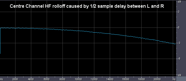

This leaves you with the third problem. The interleaved streams results in a one sample shift between left and right channels. If you were oversampling, this wouldn't be a problem (as it stands, 24/96 DAD discs will probably be fine), but on CDs played at straight 44.1, this is going to give a big phase shift in the centre stage.
As a result, I'd expect vocals to be a bit rolled off, pulling them behind the speakers rather than projecting forward. But I've never tried this interleaved arrangement, so it might be much more subtle than I'm making out.
AFAIK, some old DACs also suffered from this problem, as they used a single converter to reproduce both channels (cost saving measure?).
Anyway, two separate data streams is definitely preferable.
Actually, 1/2 sample. This has been discussed exhaustively elsewhere, i don't have a problem with this....
Oops, yes... I'm too used to working with separate streams.
I must have missed those threads.
It's not too dramatic on its own (for those who might not know, see the attached graph), but you would compensate for NOS roll-off, right? Otherwise I'd imagine the centre stage would end up at total something like -3dB at 15kHz... or worse... though most speakers (and listeners' heads!) aren't phase matched to that kind of precision, so perhaps it's a storm in a teacup.
I'm sure it will give it "character", though... not that it needs much more!
- Tom.
Well, the plot would surely be the same if you had a difference in distance to the speakers of around 4mm. Which takes some seriously tight positioning of the head and never mind all the comb filtering etc....
As for the sin(X)/X rolloff, yes, I compensate it....
I listen a lot on headphones. 🙂
Good stuff.
After all, if in-band rolloff was actually wanted (a la various products which claim to "correct" a time response problem that IMO isn't really there - at least with a "good" filter), that could be achieved trivially in the digital domain and used in combination with a good quality OS filter placed further out than normal.
