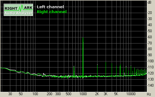

My first feeling was that a TDA1540-based player player had the most to gain, rather than TDA1541. I don't know how representative Bernhard's own TDA1540 results are, but it looks like the Discrete distorts considerably less, and also has a much lower noise floor.
I've attached the full-size -3dB sine FFT of the right channel from the Rev.2 Discrete, measured using the LynxTWO. The Rev.4 has higher harmonics, but sounds slightly less harsh, so the distortion causing it must be non-harmonic, IMO... there is much more than you'd see from a modern delta-sigma (in basic tests, at least), but it is quite low-level...
(Regarding the cluster of what looks like noise below 1K, this is mostly mains harmonics - I did try "better" PSUs with more PSRR, but it didn't improve what I heard - in one case, quite the opposite).
In the UK, there's a Philips CD-200 on Ebay which has started at a relatively low price. From a search on the forum, it seems this unit does not have a ground plane... but then again, neither did Rev.1-3 of the Discrete. Could be a bit of an RFI problem...
Not sure about the SAA7030 as a filter... it's probably too much to expect someone here to have the actual coefficient set for simulation... from the datasheet, it seems pretty bizarre... 12-bit coefficients?
To me, that immediately suggests poor maximum stopband attenuation (40dB?)... and good attenuation is important to keep IMD to "reasonable" levels. Attenuating hugely directly after the original signal is not necessary, but it needs to make considerable inroads into the first mirror image, IME.
It's a tricky compromise, as it makes life much easier to have a player with unsigned data ouput and separate lines, but if the filter is going to compromise performance, then it won't matter much what DAC goes in there... short of putting in another filter entirely.
It would be rather unfair for me to write off the SAA7030 without having some hands-on experience, though...
- Tom.

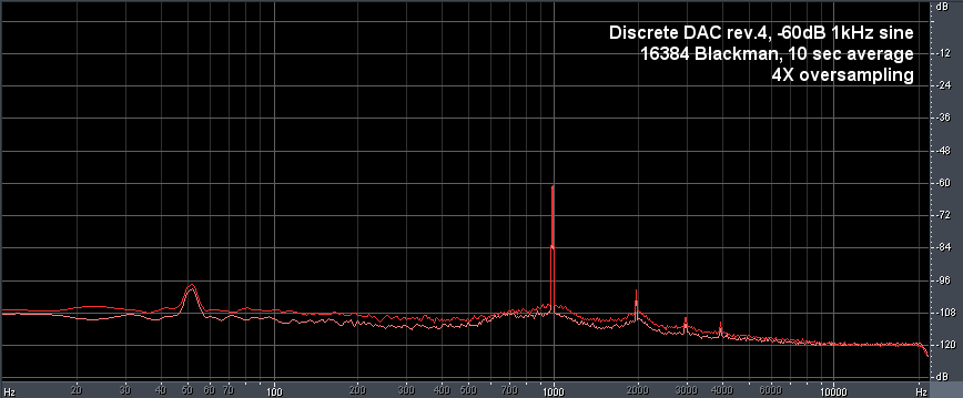

Can you measure a -60dB signal with dither ?
In Rev.1 tests at least, the harmonics didn't really move much with regard to sine level. Tested all the way from 0dBFS to -120dBFS.
I think this is at least partly down to the unipolar design. It might be an idea to measure the actual DC levels from the ladder for each step, or look at the step shape on a high speed scope... I don't have the equipment for the latter, or much enthusiasm for the former.
The harmonics are not caused by unresolved dither... I've tried going all the way down to 8 bits with shaping from the transport, and the harmonics don't drop for high level test signals. Well, at least it is consistent... 😀
It would be mildly interesting to run a "fade to black" test again using a low bit shaping mode, but I've "misplaced" the test CD-R... and rather spend half an hour looking for it or generating a new one, I'd rather put an album of music on...

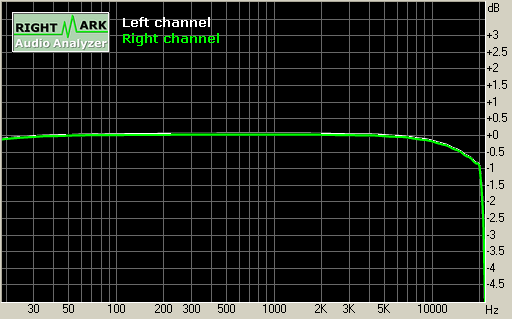

Hi

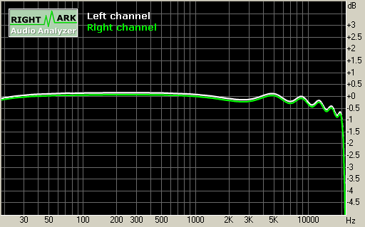

I made some measurements to various philips 14bit machines.
All players i tested show a very weird frequency response plot, and i think this is due to the digital filter SAA7310.
The low level distortion of the DACs is prety awful...
Have a look at the pics.

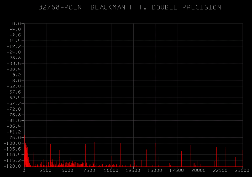

The great thing about the TDA1540 is the deep black bass caused by the K 0,65 subharmonic 😀
And the rich tube-like sound caused by the beautiful evenly distributed harmonics 😀
By the way, the TDA1541A + SAA7220B usually gives a single K5 harmonic :dead:
TDA1541 + SAA7220A looks more like TDA1540 but lower amplitude of harmonics, tube sound effect is not that strong.
My measurement for comparison, looks exactly the same:
Oh dear... I absolutely did *not* want this thread to turn into a measurement "love-in", as that completely misses the point of the project. A little perspective is in order, I think...
(TDA1540-based CD304)
No, it isn't. Really. Virtually all the distortion is harmonic, and what isn't is very low down. (That glitch at ~7200Hz could well be from the soundcard, IMO - which BTW should have ideally been named.)
Here's something for you to try... notch out the 1kHz fundamental from the -60dB sine after the part on test, and *listen* to the residue at a normal listening level for dynamically compressed material (so 0dBFS corresponds to, for example, something like 80-85 SPL).
Hear anything? No, thought not...
SAA7310 is the disc decoder, AFAIK... SAA7220 is quoted as the partnering filter.
The 12-bit coefficients inevitably make for a rough passband compared to modern standards, but even so, the ripple shown is only borderline in audibility (how flat are your speakers and ears?). Some of it is probably also down to the steep analogue lowpass filtering these early players tend to incorporate - the elliptic/cauer types give more stopband for increased passband ripple... and can also cause quite a bit of non-linear phase shift.
A lot of speculation is offered in Bernhard's post with regard to correlation between between harmonics and sound, but I don't see much to back it up. The comparison between 1540 and 1541 looks shaky at best unless the chips are used in exactly the same situation. And this is a very primitve test signal.
Still, I think it's worth showing that the Discrete is no dog in this regard... at least when the audio is processed in a suitable way. I could just as easily process it another way and get a much worse result.

My fault, I meant to say SAA7030. The SAA7220 shows no ripple problem on the frequency response.
The Philips 14bit machines (schematic is available on request if ask my friend electropt), don’t use steep analog filters, because they use oversampling.
The filter is quite simple, a 6dB lowpass on the i/v converter and a sallen key 12dB lowpass.
I question the digital filter because TDA1541 based machines use the same configuration in the analog filter, and like I said, they don’t show that kind of response.

The SAA7220 has a zero in the response, at 44 kHz, to cancel out one of the poles in the 3rd order LPF. The logic of that evades me.........
I was aware of that characteristic of the SAA7220. Read it on an Analog devices application note.
Still can’t comprehend why there no hint of this behaviour on the Philips datasheet:whazzat:
