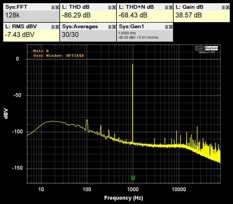

I'm a bit late to the party, but I've recently been measuring an RIAA preamp spectrum with a dummy cartridge consisting of 5 100mH inductors in series, making approx 500mH (discounting mutual inductances between them). Series resistance is close to 820 ohms.
To get clean(ish) spectra I had to go far away from mains electricity and test on battery power, the inductors are unshielded and very sensitive to EMI...
All plots are for 5mV rms 1kHz input, preamp gain about 38.5dB, classic single opamp non-inv RIAA circuit.
But here are the 3 plots for NE5532 (~5nV/√Hz, 0.5pA/√Hz):
for OPA1612 (~1nV/√Hz, ~1.7pA/√Hz):
and for OPA1652 (~5nV/√Hz, 0pA/√Hz):
Clearly the OPA1612 fares very poorly despite its very low voltage noise (its by far the quietest with shorted input). The current noise of the 47k load resistor actually masks the difference between the NE5532 and OPA1652 (which has negligible current noise). Short of electronically cooling the 47k load, there is little point moving to JFET from NE5532, and thus even less point moving from NE5534A to JFET for lower noise (although EMI susceptability would be a valid reason).
In defence of the OPA1612 is actually wins below about 40Hz...
If I had a version of that circuit with an NE5534A I'd have tested it, but its a very compact circuit using dual opamp on the inputs. There is a rumble filter that causes the roll off below 20Hz.
I realize I'd not actually seen graphs of the effect of current noise in an MM phono preamp before, it makes the theory spring to life to see the 10kHz hump!
For comparison finally a graph with just the an 820R resistor without inductance for NE5532:
Here the RIAA response shows up nicely in the noise floor without the inductance to complicate things.

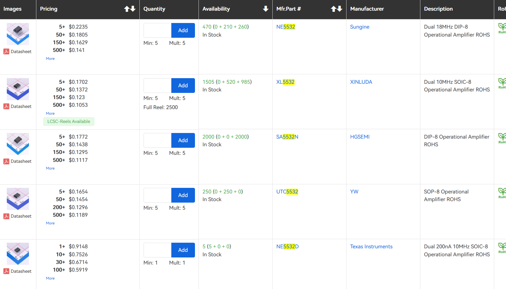

They are also available from many sources referenced on LCSC (not much from TI...)
I do not have the test equipments able to measure the performance of those eastern chips, but as a DIYer I think we should consider those suppliers as very interesting sources for 'old' chips in DIY friendly packages... : HGSemi make TDA2050, LM1875, LM3815, MAX7219, uPC1237, NE5532 & 34, etc..
Maybe someone here could measure those 5532 and 5534 chips and avoid never ending chat regarding eastern chip quality (...I mean in Audio use cases)
