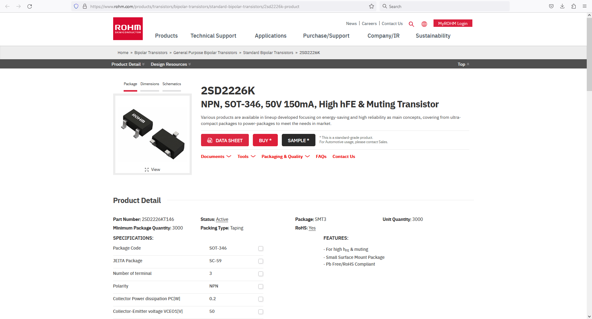

I agree that Vcesat looks like a single, darlingtons don't go much below 0.7V
This must be a very strange structure with heavily doped base and lightly doped emitter to get such a high Vebo. The vast majority of diffused transistors are around 7V, RF devices even lower.
The data sheet doesn't mention it, but if you look up 2SD2226K on Rohm's website, they list it as a muting transistor. Hence, the high Vebo.
Then there's 2SD2153, with a perfectly regular Vebo of 6V, but hFE still in the 1200-2700 range (rank W) AND - if you can trust the spice model - r_bb of .47 ohm! 😵

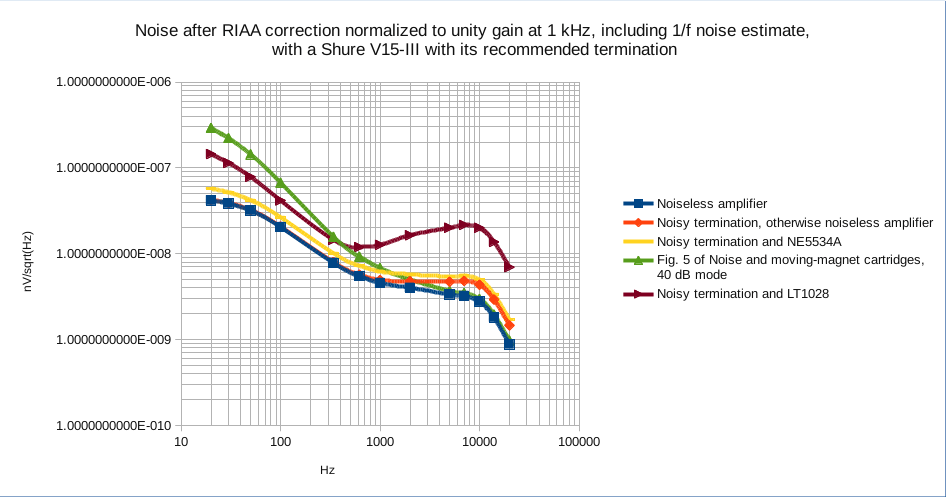

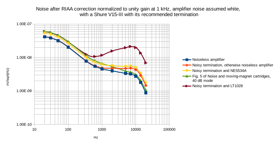

It should look something like this. Mind you, this is based on a calculation that treats the amplifier's current and voltage noise as white, so in reality you will see more noise at low-frequencies - but it were mainly the high frequencies you were interested in anyway - and it is, of course, without record surface noise. I haven't a clue if you regard a Shure V15-III as a good cartridge, but it is the only cartridge I have enough information about. The attached zip file contains an Excel sheet that should do the calculation, but as I use LibreOffice Calc, there could be compatibility issues.
When measured with a 600 Ω source, like Stereophile apparently does it, the LT1028 amplifier would come out of the test much better than the NE5534A amplifier and my amplifier would be the worst.
It's the green one.
Blue is a theoretical amplifier with no noise at all, so you only see cartridge thermal noise. Red is an equally theoretical amplifier that has a 47 kΩ resistor with thermal noise at its input and is otherwise noise free.

His simulation puts stuff into perspective. The biggest difference between his orange 'conventional' noiseless amp and yellow 5534A appears to be at 1kHz ... about 2.3dB.
So improving a 'conventional' amp is unlikely to get you more than 2dB compared to 5534A and even less compared to NJM2068.

I've updated my calculations with what I believe to be reasonable estimates for 1/f noise:
Theoretical noiseless amplifier: no 1/f noise
Amplifier with a 47 kΩ termination resistor that generates thermal noise, otherwise noiseless: no 1/f noise
NE5534A and noisy 47 kΩ: 1/f component of the noise current of the NE5534A taken into account, as 1/f noise of bipolar transistors is mainly noise current
LT1028 and noisy 47 kΩ: 1/f component of the noise current of the LT1028 taken into account, as 1/f noise of bipolar transistors is mainly noise current. Guessed that the 1/f corner frequency of the common-mode noise current is the same as for the differential noise current.
My amplifier: 1/f component of the noise voltage estimated, as 1/f noise of JFETs is mainly noise voltage. I could calculate the noise density at 1169 Hz from my measurements, subtracted the main known white noise sources and assumed the rest to be 1/f.
You now also see the disadvantage of JFETs: more noise voltage at low frequencies, as 1/f noise of JFETs is mainly noise voltage. This has very little impact on the weighted integrated noise due to the sharp roll-off at low frequencies of A- and ITU-R 468-weighting filters.

Thanks for this Mike. And thanks to Marcel for his updated analysis. It looks like 5534A is even closer to 'noiseless' than 2.3dB 🙂
I think with conventional 'noisy termination', SOTA noise for MM preamps is NJM 2068 closely followed by 5534A.
For even less audible noise, perhaps NJM 2068 in Marcel's Fig 6.
