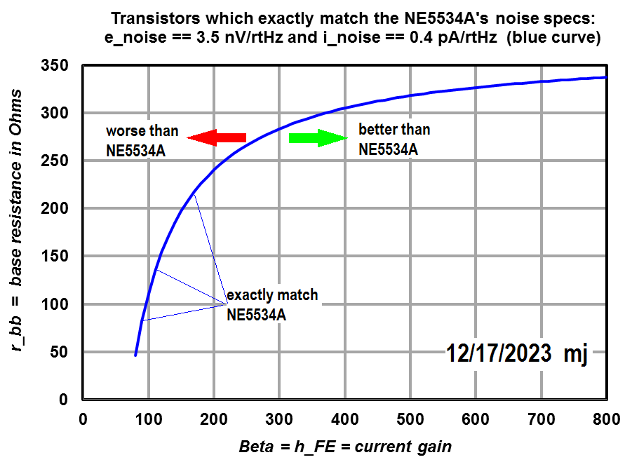

I put together the little perl script attached below, to find transistor parameters which exactly match the NE5534A's datasheet "typical" noise specifications. For low current noise, you need high beta. For low voltage noise, you need low r_bb. But exactly how much of each? The plot below may help.
Code:
# same_as_5534A.pl       written 17 Dec 2023  mgj
#    for each Beta, solve for required r_bb that gives
#    same noise current and same noise voltage as 5534A
$KBOLTZ      = 1.38065E-23 ;
$QELECTRON   = 1.6022E-19 ;
$ROOMTEMP    = 3.0E+2;
$REQUIRED_VN = 3.5E-9 ;
$REQUIRED_IN = 0.4E-12 ;
for($beta=80.0; $beta<=800.0; $beta+=10.0) {
    # noise current and beta determine I_collector
    $temp = ($REQUIRED_IN) * ($REQUIRED_IN);
    $i_collector = $temp * $beta / (2.0 * $QELECTRON) ;
    # noise voltage determines r_bb
    $temp = ($REQUIRED_VN) * ($REQUIRED_VN);
    $lhs  = $temp / (8.0 * $KBOLTZ * $ROOMTEMP) ;
    $ratio = ($KBOLTZ * $ROOMTEMP) /
        (2.0 * $QELECTRON * $i_collector) ;
    $r_bb = $lhs - $ratio ;
    printf "%.0f , %.2f , %.3le\n", $beta, $r_bb, $i_collector
Reactions: 1 users

If we use the cute simplification from Marcel's WW article {linked in post #22 above}, the MM cartridge can be modeled as a 12K resistor.
Then for the NE5534A: TotalNoise = SQRT( (3.5E-9)^2 + ((4E-13 * (12K//47K))^2 ) = 5.18 nV/rtHz
Now let's use a differential pair of Rohm 2SD2226KT146W transistors (in stock today at both Mouser and DigiKey), biased at 120 microamps per transistor. Datasheet Beta for the "rank W" part is 1200 to 2700 but we'll assume 1200. The Spice model on Rohm's website says r_bb = 16.7 ohms and we'll round up to 17. Then for the Rohm device
Vnoise = 2.03nV/rtHz and Inoise = 0.155pA/rtHz .
Thus for the Rohm discretes: TotalNoise = SQRT( (2.03E-9)^2 + ((1.55E-13 * (12K//47K))^2 ) = 2.75 nV/rtHz
Quite an improvement.
