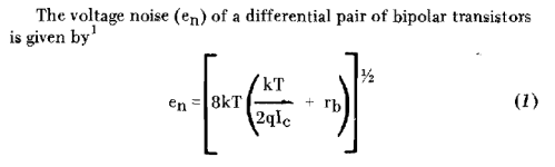

Figure 2 is the equation for the input voltage noise density of a differential pair of bipolar transistors. (It's from George Erdi's ISSCC paper on the super low noise LT1028; written in 1986). As you can see, voltage noise density varies with temperature, collector current, and base resistance r_bb. (notice that Beta does not appear)

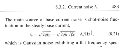

Figure 3 is the equation for the input current noise density of a bipolar transistor. (From Horowitz and Hill TAOE, 3rd Edition). Current noise density varies with collector current and with Beta. (But not temperature or base resistance).

The voltage noise plot in Figure 4 contains a few surprises. First of all, the 2N4403's input voltage noise {red curve} is better than the (dual) 5532A, for every single collector current I tried (40uA <= Icollector <= 300uA). Second, the 2N4403 noise turns out to be less than the 5534A, for every collector current greater than 70 uA. Not bad for a fifty year old jellybean part.
The current noise plot in Figure 5 tells another story. As mentioned above, the very low base resistance of the 2N4403 makes no difference to the input current noise; only Beta and collector current matter. The 2N4403 is lower noise than the 5534A at low currents (Icoll < 80uA) and higher noise than the 5534A at high currents.

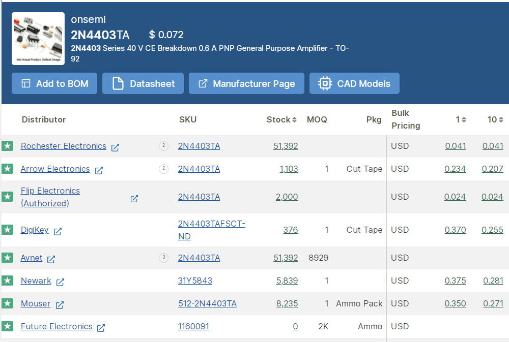

Excellent! We will add it to the ever-growing list of different ways to increase Beta in a differential pair of discrete PNP bipolars. Including the subversive maneuver displayed in the attachment to post #4.
5534A worshippers continuously chant their mantra CURR -- RENT -- NOISE -- CURR -- RENT -- NOISE with great fervor. So I thought it would be pleasant to give those kind folks some tools, to improve upon the 5534A's current noise specs using old transistors. Which several distributors have on their shelves today.
_
Reactions: 1 users

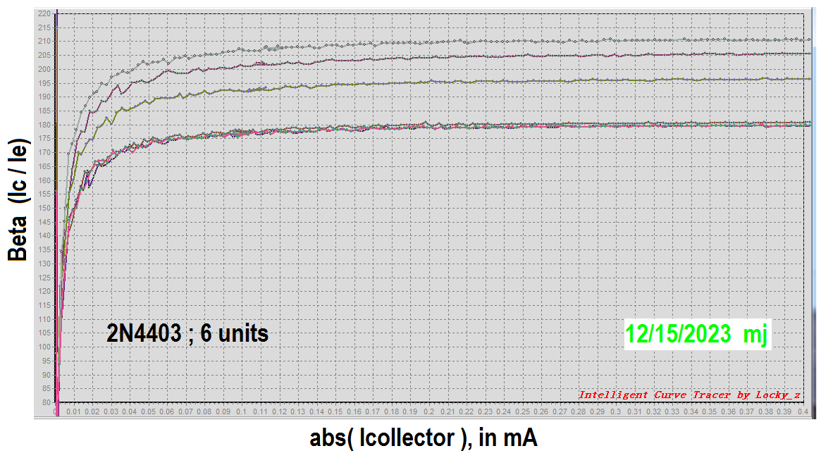

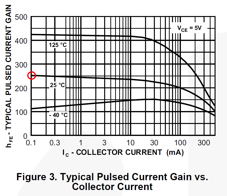

4403 have low minimum hfe at low current min 30 at 100µA maybe up to 300 that is a lot of variation and no hfe classes like BC560A, B, C. How about 2N5087/MMBT5087 that is still available and cheap, have a lot mode noise data in the data sheet, minimum hfe 250 at 100µA?
Joined 2011
[2N]4403 have low minimum hfe at low current min 30 at 100µA
Hi, please take a look at attachment #1 of post #1 in this Forum discussion thread. It shows measured data on real 2N4403s. Sometimes this type of data is plotted on semilog axes, I realize; but my curve tracer only plots on linear axes, sorry.
Beta = hfe was measured to be >160 amps per amp, on all samples tested, for all collector currents above 30 microamps. The key word here is: measured .
Reactions: 1 users
